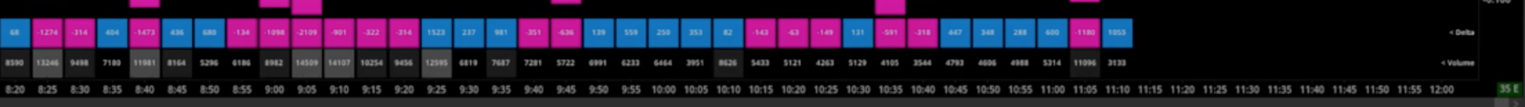

Hello, I would like to set different background color logics for each row of the Numbers bars calculated values study.
For example : - volume row : different gray colors
- delta row : red and blue colors
I have seen a picture of that configuration but I am unable to produce it (see attached file). Is there a way to do this ?
If the way to do this is to use a second Numbers bars calculated values study, how to have them close together ? I mean no space between the 2 studies, as if it was only one study (see attached file).
Thank you.
Jerome
imageCapture d’écran 2022-11-03 à 11.45.50.png / V - Attached On 2022-11-03 10:52:12 UTC - Size: 173.03 KB - 331 views
[2022-11-03 15:45:29]
The only way to do this is to use two copies of the Numbers Bars Calculated Values studies. There is not a way to remove the space between the studies.
