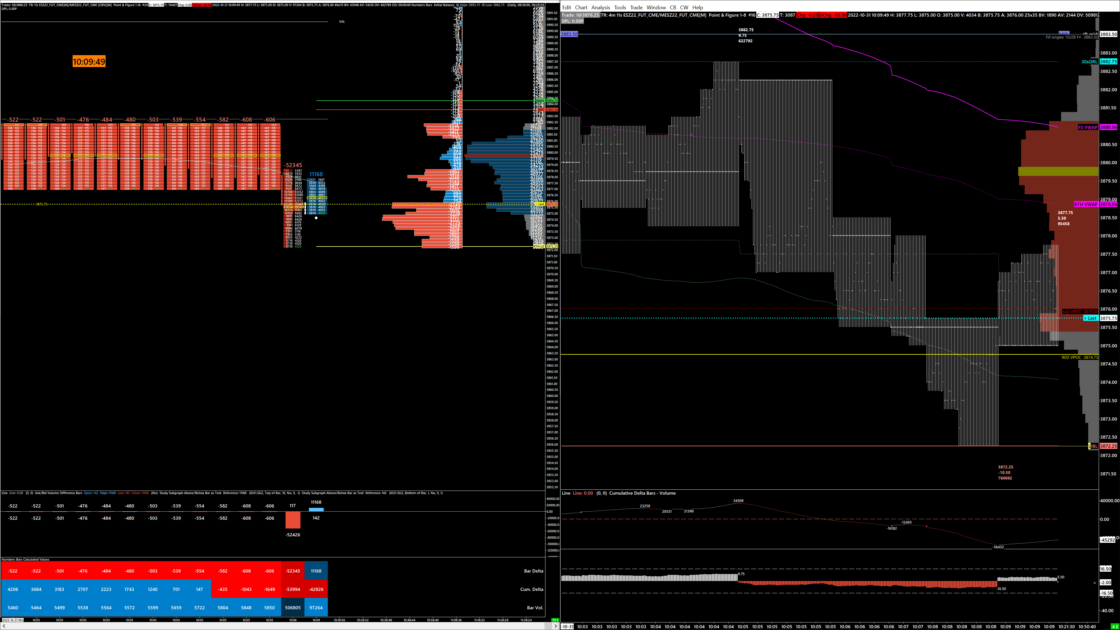

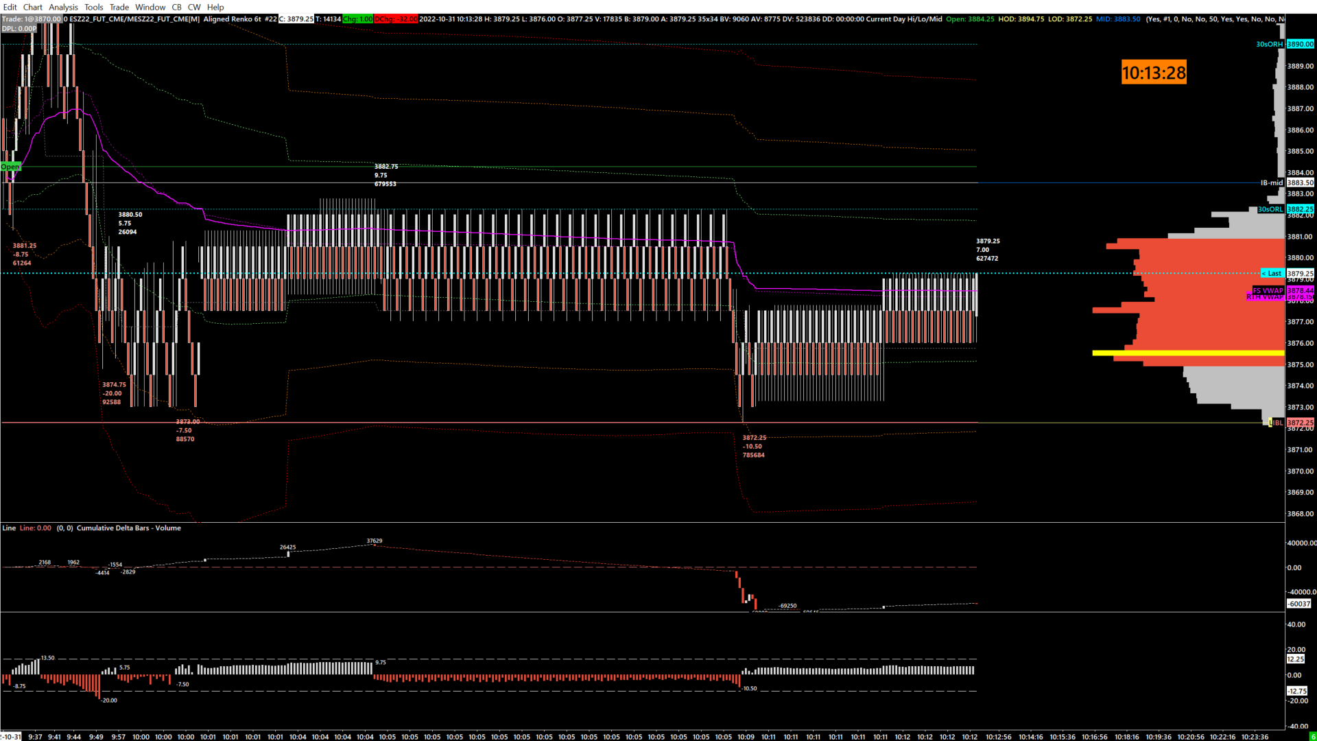

I am having an issue that I cannot resolve. I have already tried restarting Sierra Chart multiple times, I've restarted my computer, and I've made sure to update to the most recent release of SC.
My charts are not printing properly, every print seems to be the same, the attachments will clearly show the issue I am having. My time based chart seems to be OK, but the P&F and renko are completely messed up, as are all my footprint charts.
I am also having an issue on my 5m footprint where all the numbers (fills at the bid/ask) in the current bar change despite price being somewhere completely different. Like, we will be trading 3885s in the bar, but the fills at 3880 are simultaneously changing which is impossible.
Please advise on how best to resolve this issue. I am out of ideas. Thanks.
imageFP+P&F_1.PNG / V - Attached On 2022-10-31 14:16:52 UTC - Size: 348.28 KB - 215 views
imageRenko_1.PNG / V - Attached On 2022-10-31 14:17:08 UTC - Size: 207.5 KB - 181 views
imageFP5m_1.PNG / V - Attached On 2022-10-31 14:22:12 UTC - Size: 316.85 KB - 206 views

Set Sierra Chart to a Tick by Tick Data Configuration. Follow the instructions here to do this:

Thank you, the proper data seems to be loading now. But I cannot get the historical data to update. Like, everything still looks as it did in the earlier snips I sent across. How can I get the full day's chart to update properly? I cannot seem to figure it out based on my research on the SC website thus far. Thanks.

You need to delete the old data by selecting Edit >> Delete All Data and Download. This will remove all the data from the chart and then the data will all redownload in 1 tick increments.
