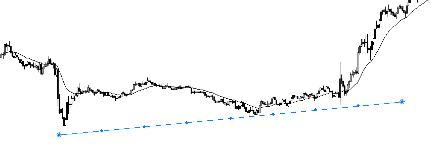

I am just starting to get my feet wet with Sierra Charts. Do the additional points (between the start and end points) on a line drawing have a purpose? I had a look at the Line, Ray, Extended Line section of the help documentation but it only mentions two points. Just curious if there are more ways manipulate the line tool as-is that I am not aware of. Cheers.
imageScreenshot 2022-10-29 143216.png / V - Attached On 2022-10-29 18:52:06 UTC - Size: 7.79 KB - 235 views

These are just to simply highlight the selected drawing. You can either adjust the end of a line or move the line. All of this is documented here:
Chart Drawing Tools: Move Drawing
Chart Drawing Tools: Adjust Drawing
