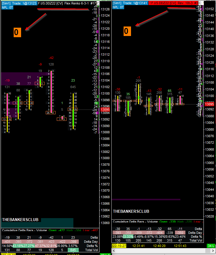

Could you also help me to set the countdown on footprint:
a) Flex Renko 6-3-1
b) Reversal bar 10-3, please. I have zeros at the moment (attachment) I put =1 as in described in the message above.

I would like to know when the next bar opens. No ringing alert - only count down. With time it is easy to see how many minutes are left before the next candle or footprint opens. But Is it possible to see when next:
a) point and figure,
b) Flexi Renko footprint and
c) reversal bar
open?
Maybe it is not...
[2022-10-27 18:03:37]
John - SC Support - Posts: 48046
From the documentation for the Countdown Timer:
The Countdown Timer is not supported on Reversal, Renko, Delta Volume, Point and Figure chart bars. In these cases, 0 will be displayed by the study.
