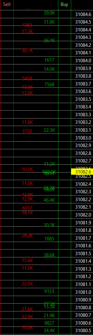

The volumes for each price level in my Recent Bid Volume and Recent Ask Volume columns are always being displayed jumbled on top of each other making it very difficult to distinguish which volume is associated with each price. Is there a way I can configure the system so that the volumes at each associated price level can be clearly read? I have attached an image below. I appreciate any help!

[2022-10-26 14:16:28]
John - SC Support - Posts: 48046
The reason the numbers are on top of each other is that the Tick Size and the Price Display Format are not correct. They need to be set to 0.01 for both of them. These settings can be found on Chart >> Chart Settings >> Symbol. Refer to the documentation for these settings here:

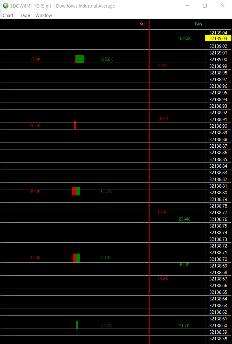

pbufinancial - Posts: 5
Thank you so much. Changing the tick size has made a dramatic difference!
Now, is there a way to configure the volume settings so that they only show within the
corresponding level and not bleeding into the level above?
I have attached an image.
Thanks again for your help!
imageScreenshot 2022-10-26 112644.png / V - Attached On 2022-10-26 15:27:22 UTC - Size: 53.95 KB - 249 views

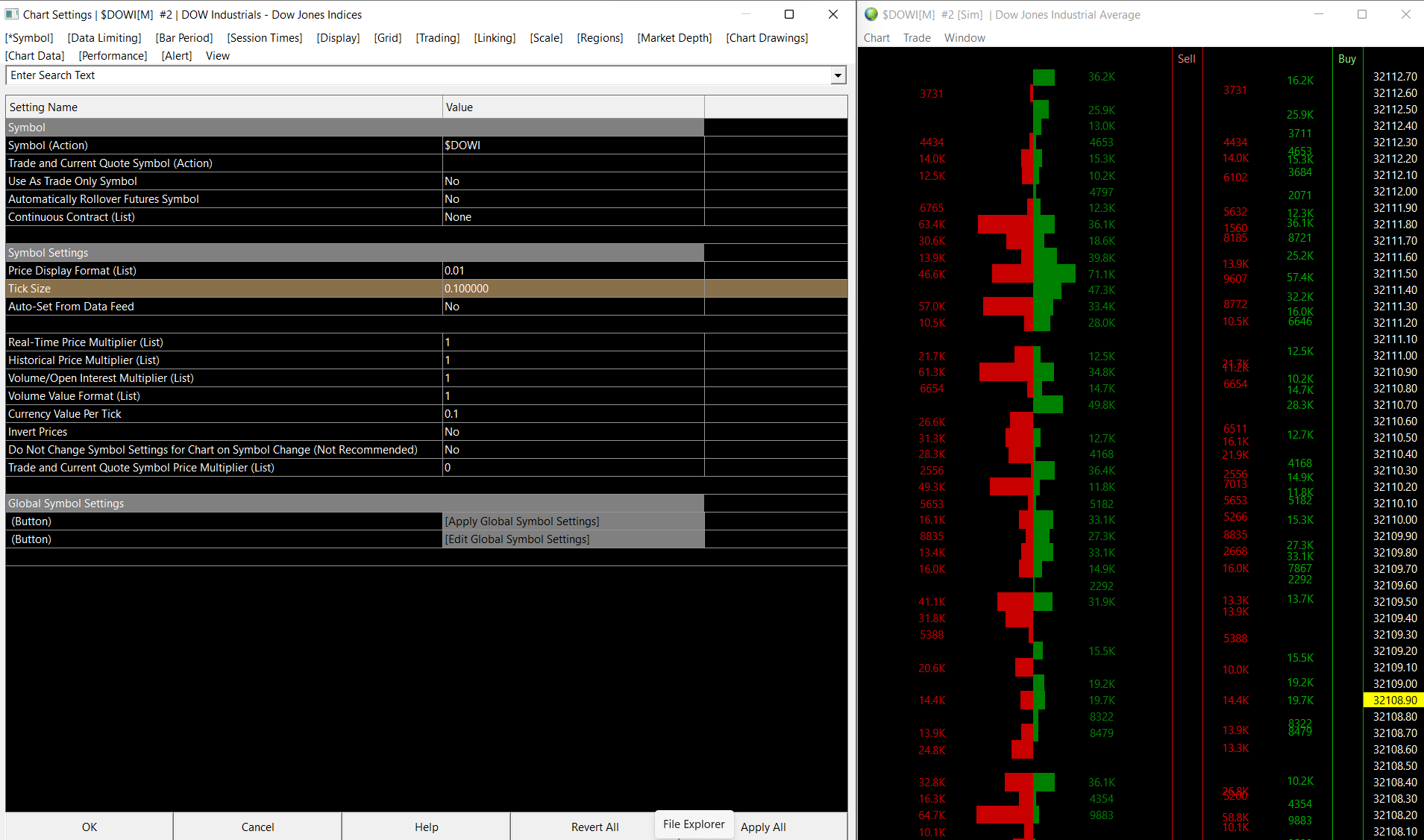

I removed the grid as a fix for the issue I mentioned above.
Moreover, It appears like some data is missing when I change both the price and tick size to .01. In comparison, When I change the price to .01 and the tick to .1 it looks like more data is apparent.
Why is that?
imageScreenshot_20221026_120841.png / V - Attached On 2022-10-26 16:13:26 UTC - Size: 154 KB - 293 views
[2022-10-26 17:27:35]
There should not be any difference in the data regardless of how you have your Tick Size and Price Display. It's just a matter of allowing the data to show properly instead of being on top of each other.
In terms of missing data, it is what it is and we can not say why it shows the way it does.
Another option in terms of displaying the Market Depth data is to change the Chart >> Chart Settings >> Market Depth >> Market Depth Combine Increment in Ticks. Refer to the information here:
