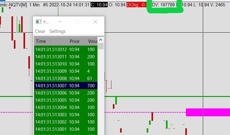

I noticed today there seems to be missing volume when compared to TOS 1,145,173 vs 197,789 (see attached screen shots). Any ideas what could be causing this?
Date Time Of Last Edit: 2022-10-24 21:06:01
imagedaily vol tos.jpg / V - Attached On 2022-10-24 21:01:29 UTC - Size: 12.6 KB - 275 views
imagedaily vol sierra.jpg / V - Attached On 2022-10-24 21:05:19 UTC - Size: 74.72 KB - 295 views

The NASDAQ TotalView exchange does not have the Consolidated Tape, so it is only the volume from the primary exchange. Refer to the information here:
Denali Exchange Data Feed: Nasdaq TotalView Data Feed Notes
If you need the consolidated tape information and can get by without the Market Depth, then you can use our Sierra Chart Exchange Data Feed with the U.S. Equities exchange. Refer to the Setup Instructions here:
https://www.sierrachart.com/index.php?page=doc/SierraChartRealTimeFuturesStockDataFeed.php#SetupInstructions
