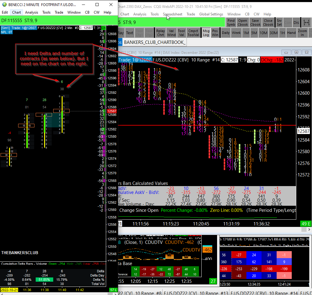

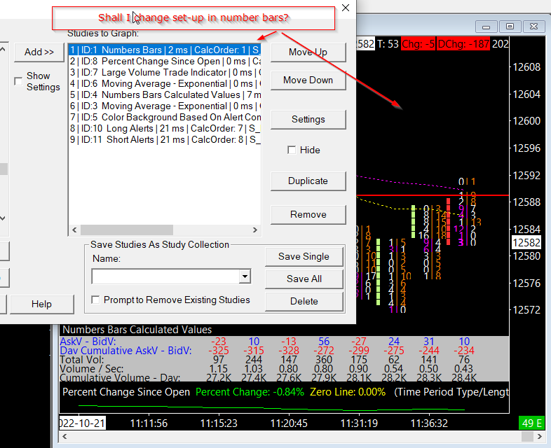

Could you instruct me how can I set (above my footprint bar):
1) Number of contracts in total included in a footprint bar
2) Delta from the foot print bar.
These two information I would like to have above a footprint bar. Print-screens attached, just in case.

[2022-10-21 11:50:16]
User266447 - Posts: 280
If possible I would like to have inbalance area on the footprint bar as well

To place information from a study (the Numbers Bars Calculated Values in this case) above or below the bar, use the Study Subgraph Above/Below Bar as Text study. Refer to the following:
To show an Imbalance, refer to the following options:
- Volume at Price Threshold Alert V2: Highlight Multiple Adjacent Bid or Ask Dominant Prices (Stacked Imbalance)
- Numbers Bars: Display Ask/Bid Imbalance
[2022-10-21 19:45:26]
The study Subgraph Above/Below Bar shows me volume probably since open - a big number instead of calculating volume on each single bar. And I cannot see how can I receive delta (and place it above each bar) from the Study Subgraph Above/Below sa Text?
[2022-10-21 20:26:28]
You need to set the particular Subgraph that you are wanting to display. Since you have a Numbers Bars Calculated Values study on the chart, you can use this to get the data you want. For the Volume you would use the Numbers Bars Calculated Values study with Subgraph 13 (Total Volume). For the total delta, it would be Subgraph 1 (Ask Volume Bid Volume Difference).
For example, you would add one Study Subgraph Above/Below Bar As Text to the chart and for the Input of Input Study Subgraph you would select Numbers Bars Calculated Values and Ask Volume Bid Volume Difference (SG1).
