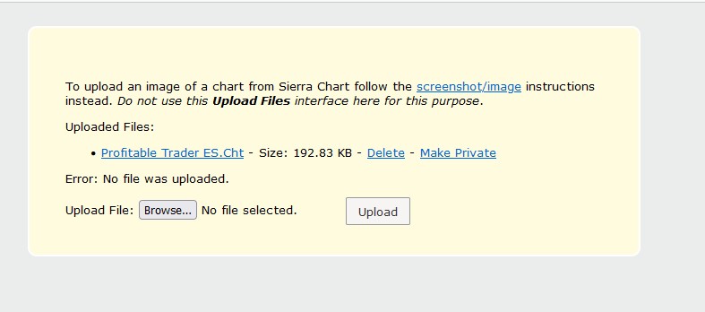

ES Main #3 is the parent - Well now the file won't upload ???? Sierra is closed so why won't this upload?
imageNo File Uploaded.jpg / V - Attached On 2022-10-19 13:33:58 UTC - Size: 37.75 KB - 232 views
[2022-10-19 17:14:51]
John - SC Support - Posts: 48046
The file did upload, the reason you got that message was because you selected Upload again when there was no file selected.
All you needed to do was to close that window and then submit the reply and it would have attached the file. Please try again.
