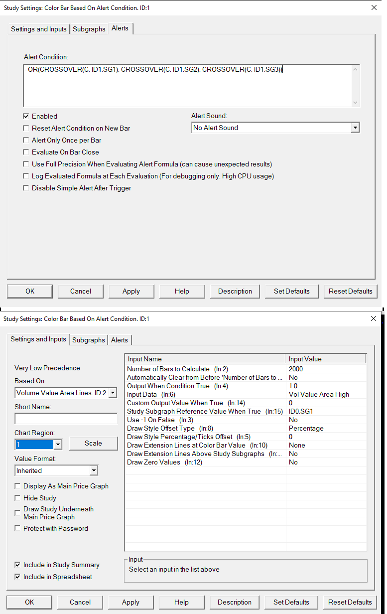

[2022-10-18 20:45:16]
Attached is an image of the Color Bar Based on Alert Condition with the settings and condition as you would have them.
But, you need to ensure that the ID for the Value Area Lines Study is correct.

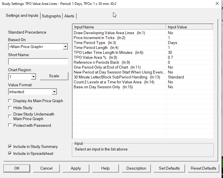

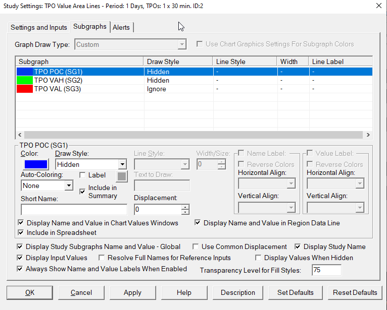

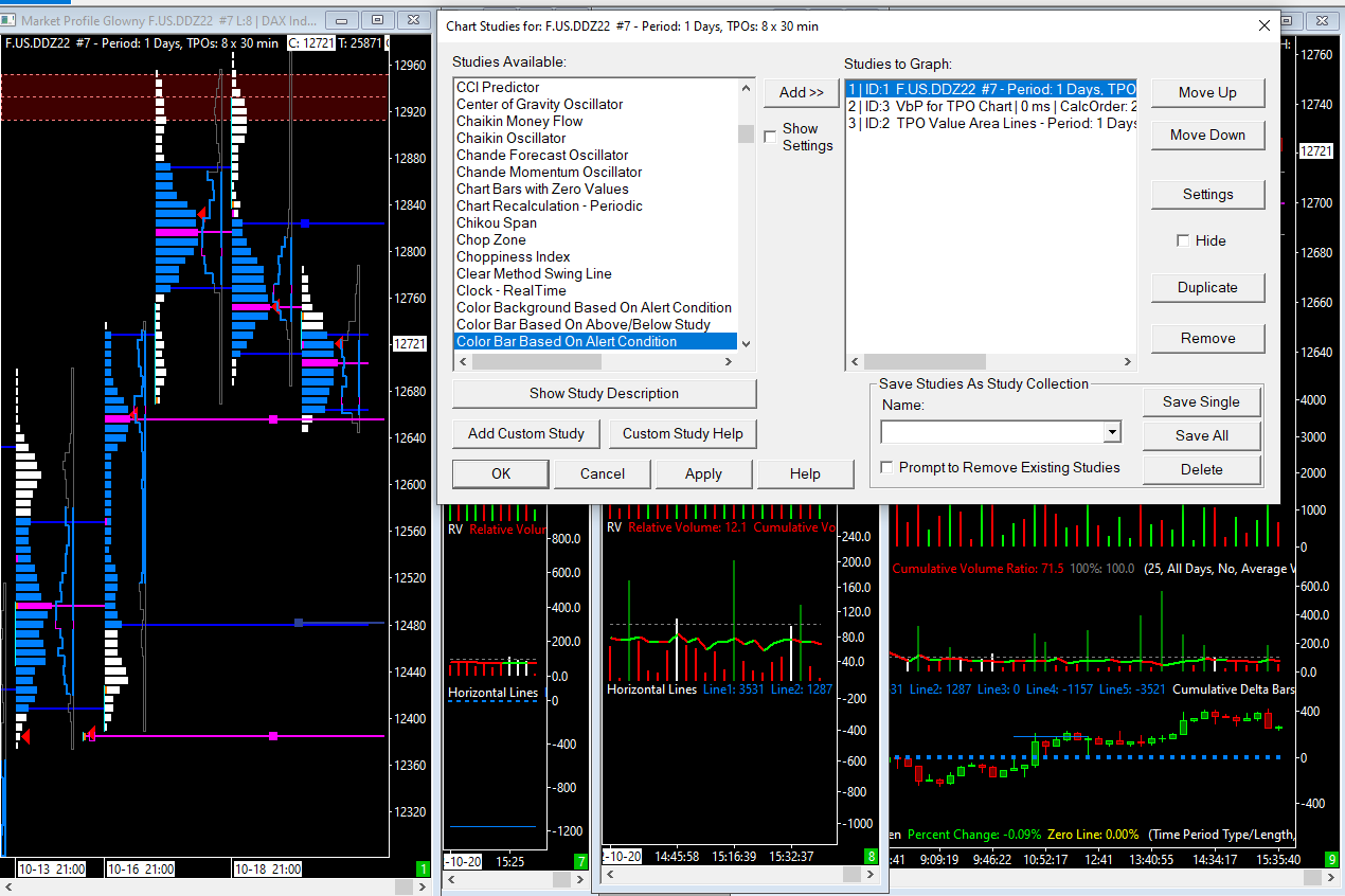

[2022-10-20 13:47:13]
User266447 - Posts: 280
Let me add print-screens refering to the first sentence from the previous message
Part 1.
imagePoint_Figure_All_Studies.png / V - Attached On 2022-10-20 13:45:39 UTC - Size: 89.59 KB - 349 views
imageTPO Value Area Lines 1.png / V - Attached On 2022-10-20 13:45:45 UTC - Size: 33.85 KB - 303 views
imageTPO Value Area Lines 2.png / V - Attached On 2022-10-20 13:45:51 UTC - Size: 19.98 KB - 399 views
[2022-10-20 13:47:53]
Last print screen regarding my previous message.
imageTPO Value Area Lines 3.png / V - Attached On 2022-10-20 13:47:34 UTC - Size: 35.76 KB - 311 views
[2022-10-20 14:38:52]
Your Alert Condition has a typo. In the second Crossover you have "IF1", which should be "ID1".
Another issue is that the TPO Value Area Lines needs to be on a separate chart. It can not be on the same chart as the TPO itself.
And finally, the ID in the Alert Condition needs to match the ID of the study. Assuming you could keep the TPO Value Area Lines on that chart, the ID for the study is 2 (see where it says "ID: 2"). Therefore, the alert condition needs to have ID2 instead of ID1. When you change this on a new chart make sure you use the the proper ID.

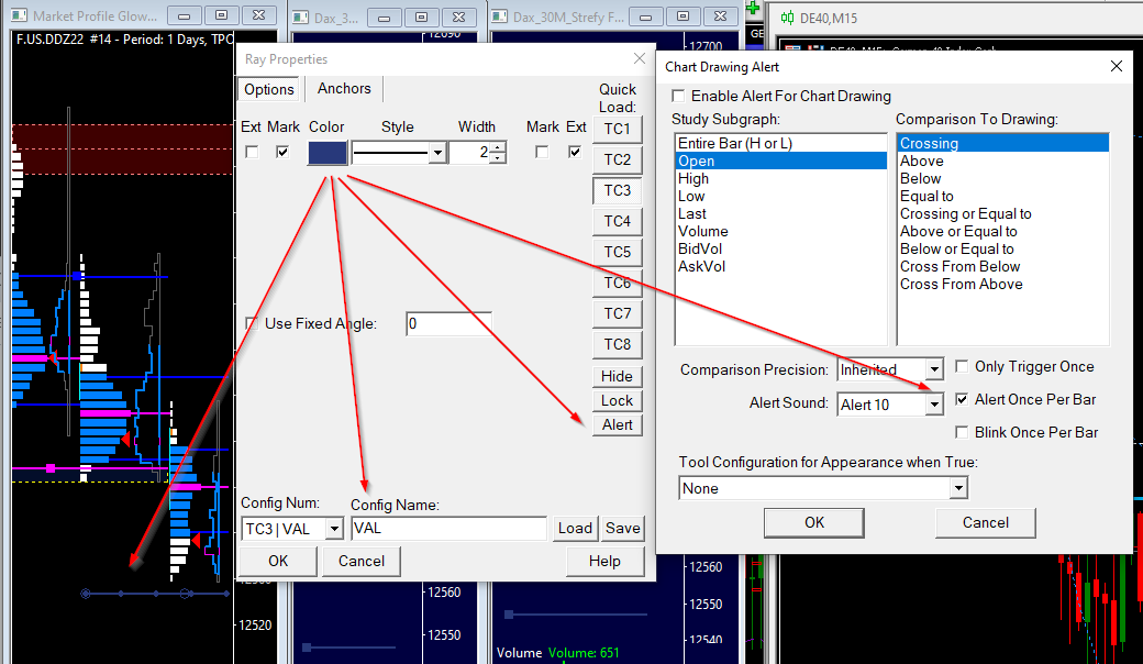

[2022-10-21 12:46:25]
If there isn`t an option to have alerts on extention lines, maybe I can set ray lines and extended rectangles with alerts on it?
The only problem is that I have tried before and was unable to do it. In other words, how can I set an alert on a ray line and on a rectangle - let me provide a printscreen for a ray line as I have my set-ups for VAH, VAL, POC.
VAL print-screen attachad. What I am doing wrong as the alert is not triggering
imageVAL_Alert_Ray_1.png / V - Attached On 2022-10-21 12:46:03 UTC - Size: 72.83 KB - 334 views
[2022-10-21 17:38:17]
You have the Open as Crossing the line. The Open is always a static number per bar, so it will never "cross" the line. You need to use the Last.

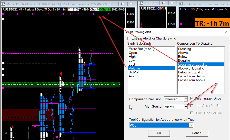

[2022-10-21 20:01:14]
I have set the alert to: Last and Crossing or Equal to, but it still does not work. What shell I do?
[2022-10-21 20:29:14]
Do you have the option for Enable Alert for Chart Drawing enabled at the top of the Drawing Alert window? If not, then the alert is not active.
And is the last price actually crossing through the line? If it does not, then the alert will not be true.
If the above are set and happening, then open the Window >> Alert Manager and take a look in there to see what is occurring.
Date Time Of Last Edit: 2022-10-21 20:30:56

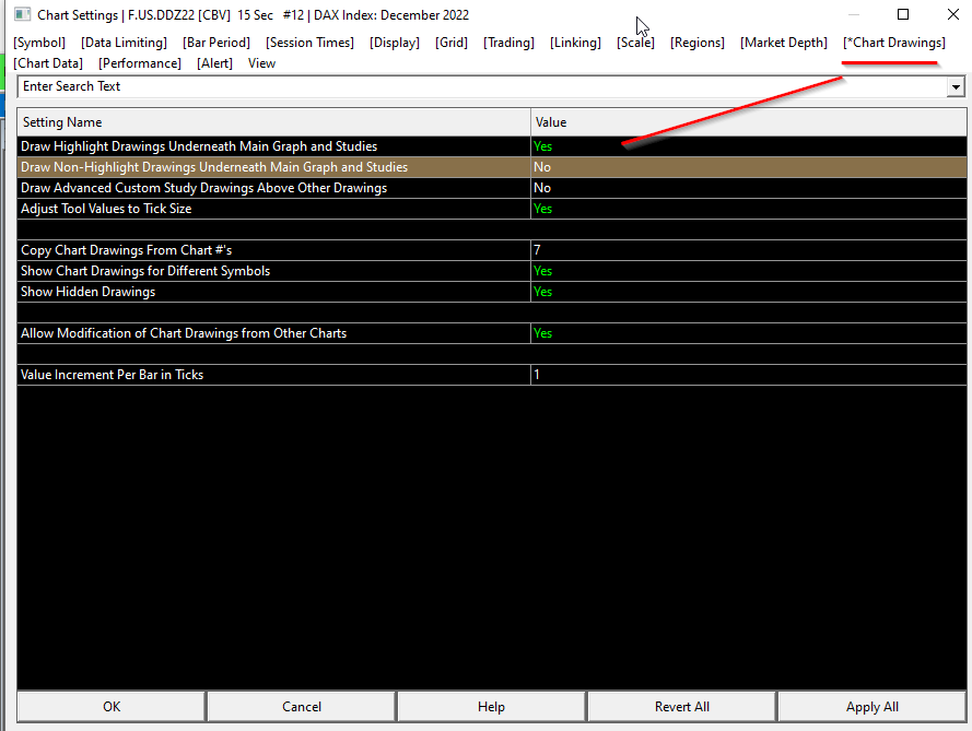

[2022-10-26 19:31:17]
Here is my chart setting/chart drawings attached printscreen no. 3. Is it OK?
Refering to: "And is the last price actually crossing through the line? If it does not, then the alert will not be true" - As most of the trendlines are set on market profile chart maybe I should change it to volume - crossing or equal - or time? But I do not have time there. Will volume be OK? Print screen no 4 shows the current set-up.
image3.png / V - Attached On 2022-10-26 19:27:53 UTC - Size: 27.21 KB - 317 views
image4.png / V - Attached On 2022-10-26 19:29:59 UTC - Size: 52.32 KB - 378 views
[2022-10-26 19:37:41]
An adjustment to my last message (above):
I also click (just at the time of writting) the box: Enable Alert for Chart Drawing which was not clicked before. It should work for now - fingers crossed (based on High-crossing or Equal to).
[2022-10-26 20:31:16]
You need to select the Study Subgraph of Last.
