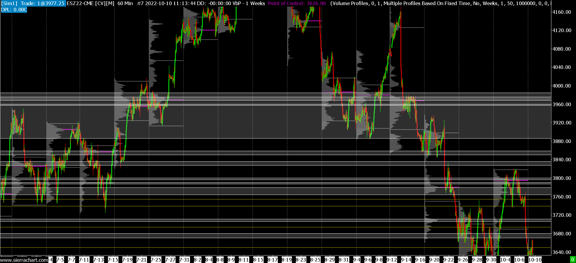

https://prnt.sc/7ThOF2cMttJn thats what my chart looks like , i dont understand why it shows me the volume profile for the last 3-4 weeks , even though its supposed to just show me the weekly profile. what can i do to change that ?
[2022-10-05 17:23:06]
John - SC Support - Posts: 48602
There is something not right with the chart starting from that last profile. Note the repetition of the date of 10-4.
The first thing is to redownload the data starting from just before that point. Refer to the instructions here:
If that does not solve it, then you may have a custom study that is causing an issue. Remove the studies from the chart, one-by-one and see if the dates resolve properly when you have remove a particular study. If it is a custom study, let the developer know. If it is a Sierra Chart study, let us know.

We are not seeing any issue with the chart. Here is an image of what we get when we open your chartbook and set the symbols for our service:
https://www.sierrachart.com/image.php?Image=1665418426111.png
The implication is that there must be something with the data. For this chart (#7) please make it the active chart and then select Edit >> Delete All Data And Download.
Let us know if this fixes the problem or not.
