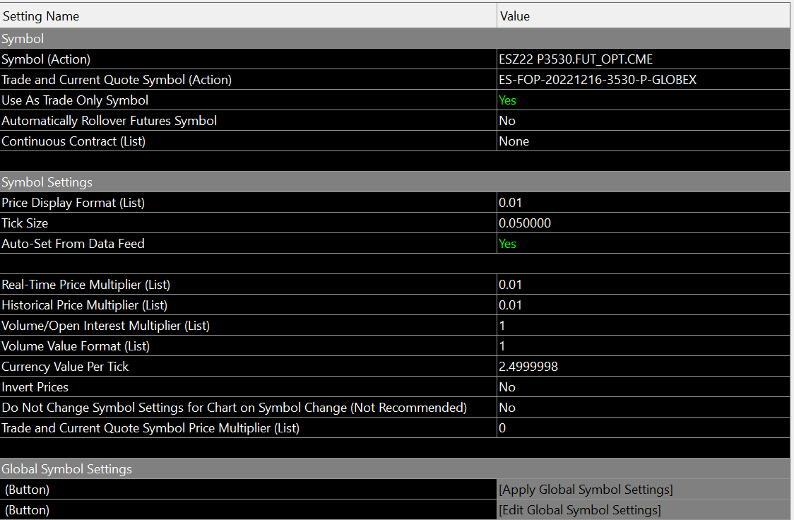

I have followed instructions to use the Denali feed for CME futures options and I use the Interactive Brokers FOP format string in the "use as trade symbol" chart settings.
When I try to place a buy limit order on ES FOP at, say, $87, the order is rejected because TWS thinks I am trying to buy at $8700 (for a total $437,000 since ES FOP has a multiplier of 50).
It looks like there is a multiplier used somewhere that I should adjust, can you please advise?

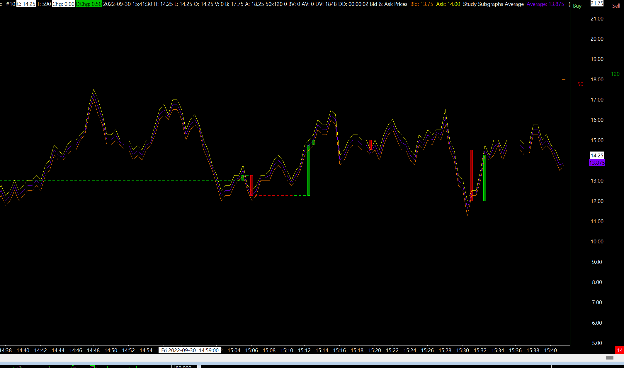

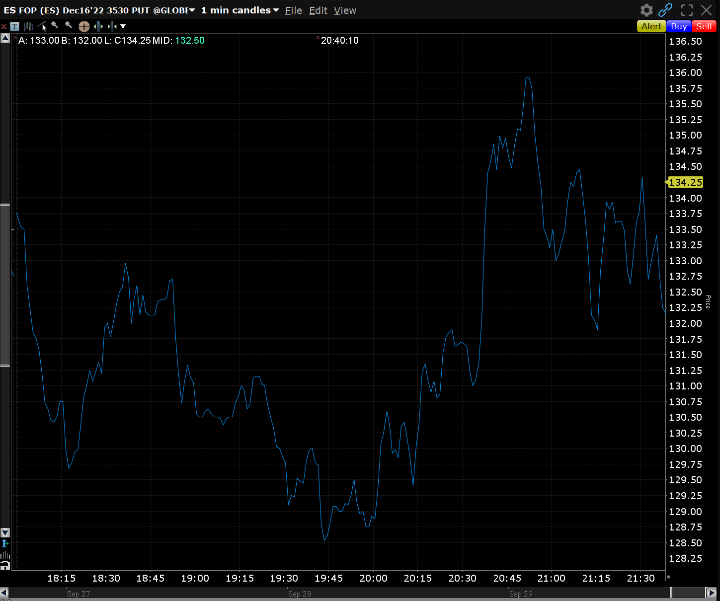

Other problem: how do I get to display the line of the mid-price as bid and ask evolve?
I would like to replicate in SC what I am seeing in TWS (see attachements)

Yes there is a multiplier setting to use for this. Refer to:
Chart Settings: Trade and Current Quote Symbol Price Multiplier (Chart >> Chart Settings >> Symbol >> Symbol Settings menu)

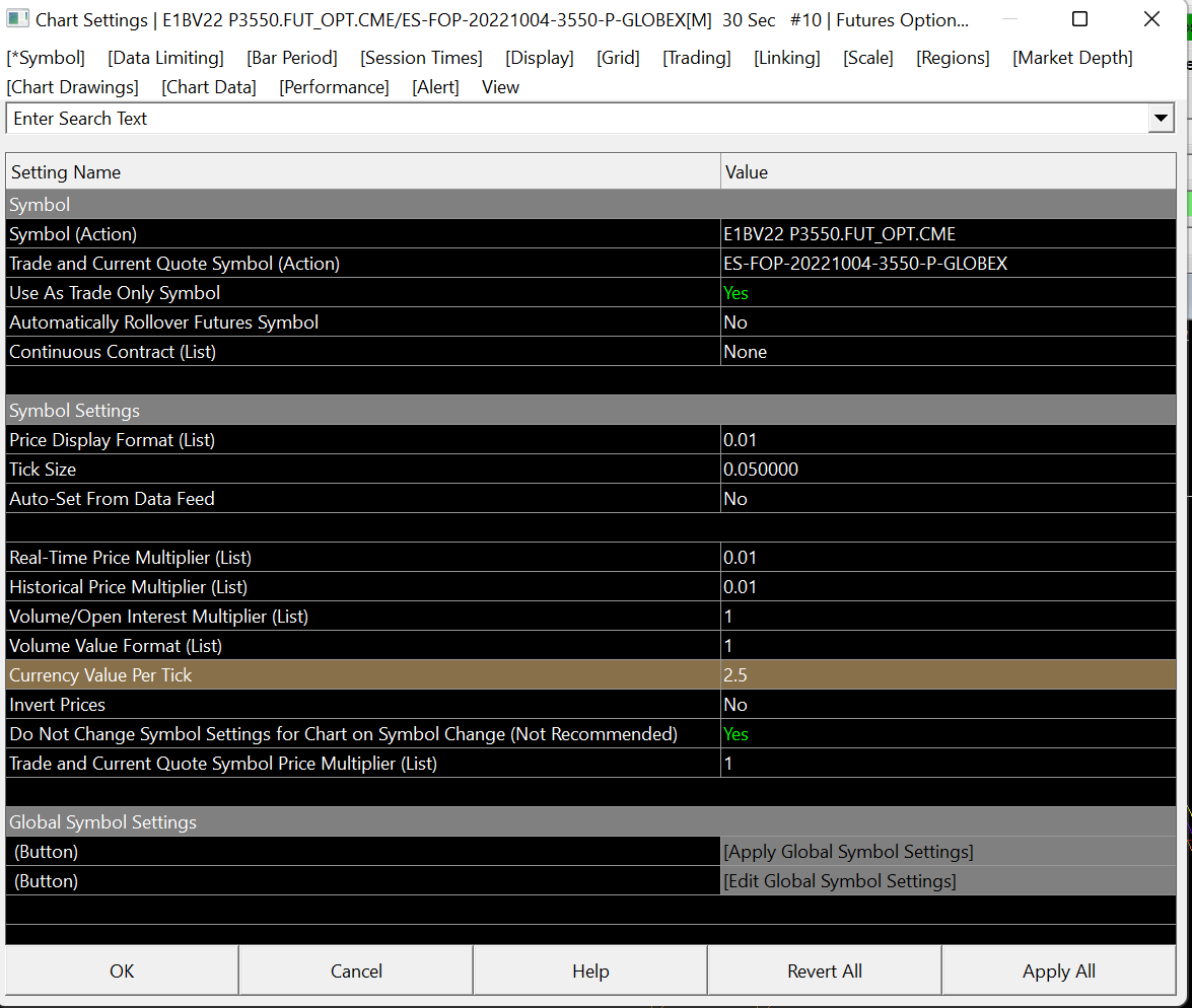

Thank you, that all worked, I am attaching my settings in case it helps someone trying to achieve the same thing.
One thing to be aware of is that the tick size is not constant on IB, at least for futures options.
If you place an order close enough to the current price, it is 0.05, but if you place it out of a certain range, it is 0.25. In that latter case, if you try to place an order at a level other than .0, .25, .5, .75, it will be rejected so you have to make sure to select one of those levels.

Yes that is correct. Thank you for this.
