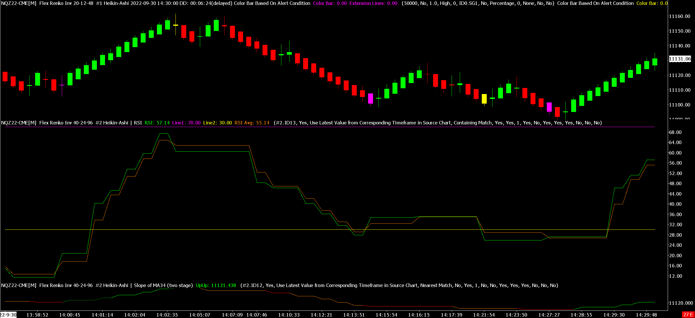

attached is a htf chart showing the rsi cross and ltf chart that colors candles based off it. there should be a yellow where i circled in white (15:15:32-15:15:35). I get 2 purples, it's suppose to be cyclical so a yellow is missing

these are the formulas I wrote using the "color bar based on alert condition" =CROSSFROMBELOW(ID3.SG1,ID3.SG4) =CROSSFROMABOVE(ID3.SG1,ID3.SG4) with that being said, the RSI I'm using is from SC. |

The formulas themselves are fine. Are you using 2 different Color Bar Based on Alert Condition studies, one for the Cross from Below and the other for the Cross from Above?
| [2022-09-30 18:54:00] |
| User411320 - Posts: 379 |
yes I'm using 2 exactly as you said

It is working fine for us. The image at the following link is what we see: https://www.sierrachart.com/image.php?Image=1664574315404.png You can see two yellow bars, one at 14:02:36 and the other at 14:21:54. These correspond to when the RSI crosses the RSI Average from above, as per your Color Bar Based on Alert Condition. For the most reliable, advanced, and zero cost futures order routing, use the Teton service: Sierra Chart Teton Futures Order Routing |
