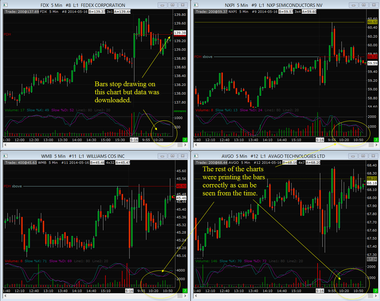

I have been experiencing this issue with Sierrachart for a while now. I have 6 charts and one will stop printing the candle bars while the rest are ok. In order to fix this, what I do is close Sierrachart and restart it which is not the ideal solution during the trading day. I have attached the screenshot below to illustrate the issue. What could be the reason for this problem? Is there anything that I can do other than closing and restarting Sierrachart?

Definitely there is no need to restart Sierra Chart. The most you need to do is reconnect to the data feed.
For help with this kind of problem, refer to help topic 3 here:
http://www.sierrachart.com/index.php?l=doc/helpdetails3.html
If you are using IB True Real-time Data, then disable it:
http://www.sierrachart.com/index.php?l=doc/IB.php#TrueRealTimeData
