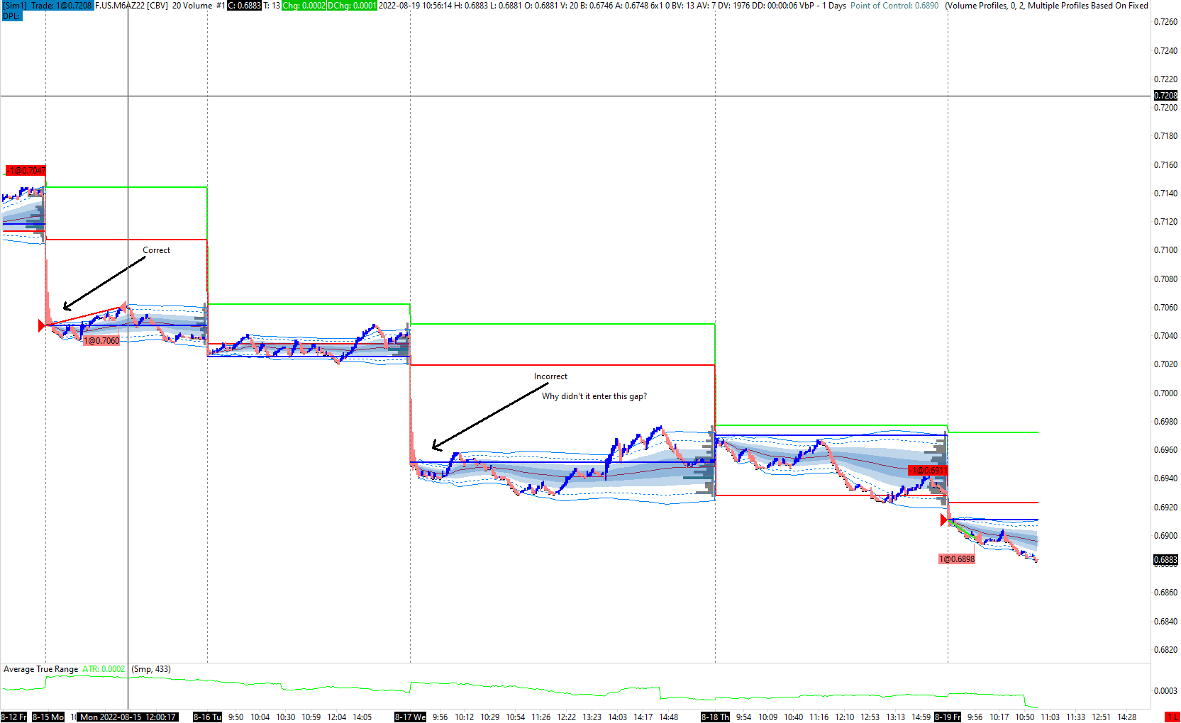

Hello TIA
Gap Momentum System with spreadsheets. Enters a buy/sell when open is above/below the high/low of previous day. Exit is an attached order.
The Problem: It isn't entering about 50% of trades it should be. I attached a screenshot example.
BuyEntry:
=(ID6.SG1@3-ID1.SG2@3)>0
SellEntry:
=(ID1.SG3@3-ID6.SG1@3)>0
https://www.sierrachart.com/image.php?Image=1663183608992.png
Thanks!
I would approach it by referring to the previous bar/day, like this:
BuyEntry:
=AND(B3>ID1.SG2@4,INT(A3)>INT(A4))
SellEntry:
=AND(B3<ID1.SG3@4,INT(A3)>INT(A4))
where ID1 is the Daily OHLC study, with Reference Days Back set to 0.
This forces the signal to a single clearly defined transition.
This assumes the Session times have the RTH opening bar as the first bar of the new day.
Date Time Of Last Edit: 2022-09-15 00:44:26
