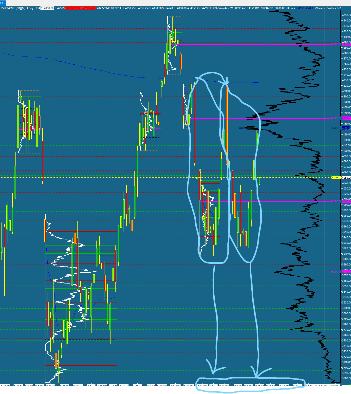

Hi Guys,
Post rolling from ESU22 to ESZ22 this week my intraday historical chart which uses denali data feed is duplicating the prior daily bars at the end of the chart. I have tried to delete and redownload the data but it isn't working. Any advice on how to fix this? I have attached an image that shows what I am talking about.
Many thanks,
ballyo

[2022-09-13 13:40:34]
Sierra_Chart Engineering - Posts: 25348
Re-download the data for the last two contract months following these instructions:

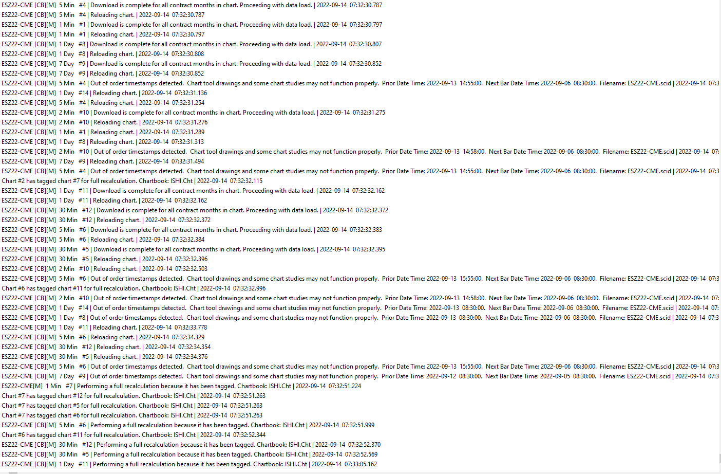

Hi Guys,
It appears that this fixed the issue for yesterday, however when I reopened SC this morning the same error reappeared (duplicating the bars at the end of the chart). I tried following the above steps again but I cannot get the chart fixed as I did following those steps yesterday. I also tried to delete and redownload all available contract data for ES (the chart uses 1000 days for one study) in case this was causing the error. Is there something I need to do to make the change stick so to speak? I have attached a screenshot of the message log.
Many thanks,
ballyo

[2022-09-14 12:45:43]
Does the problem go away if you set the Continuous Contract option to None:
