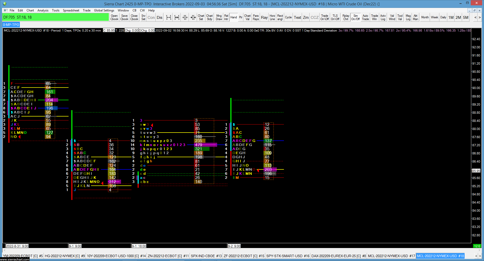

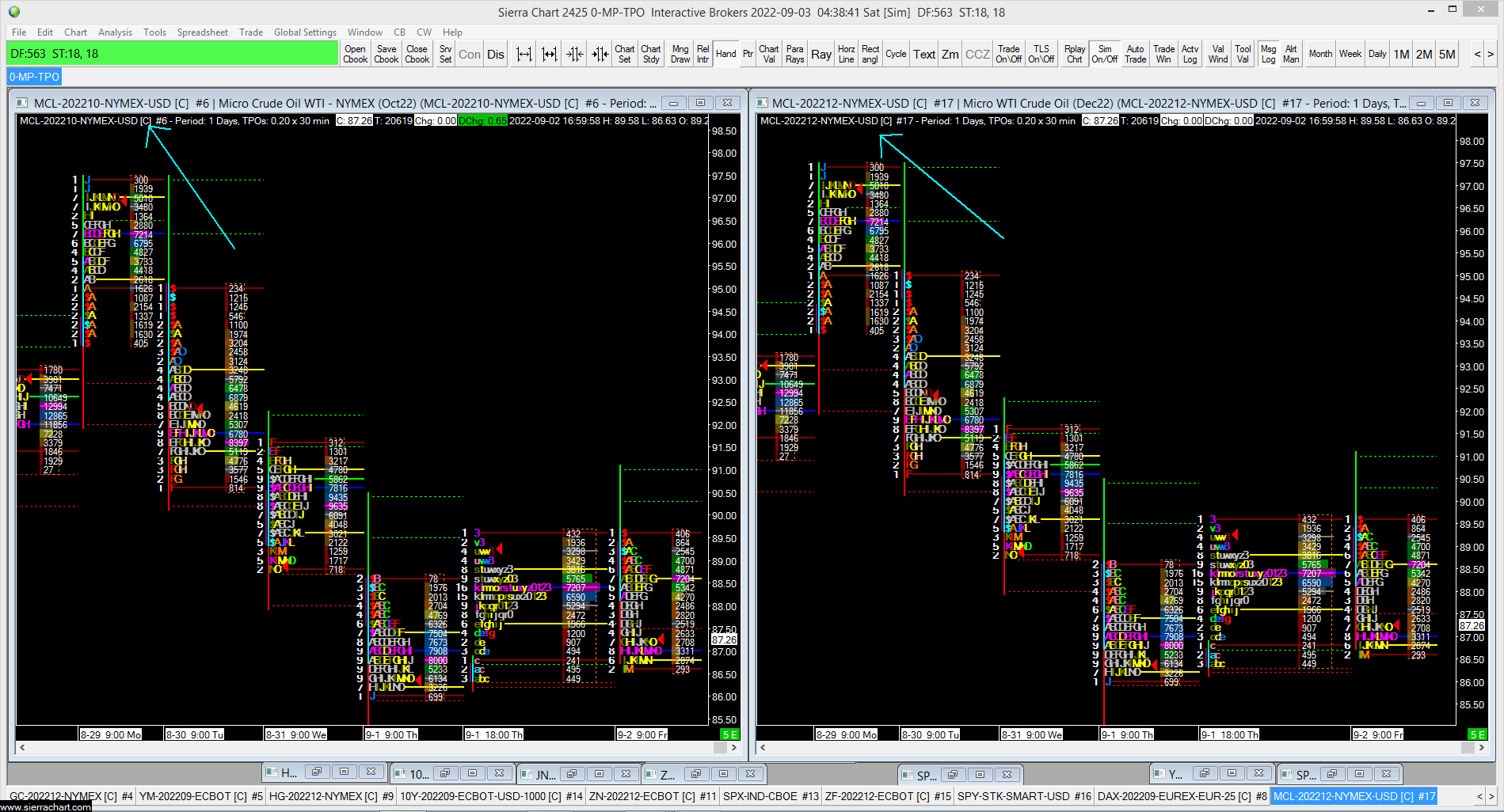

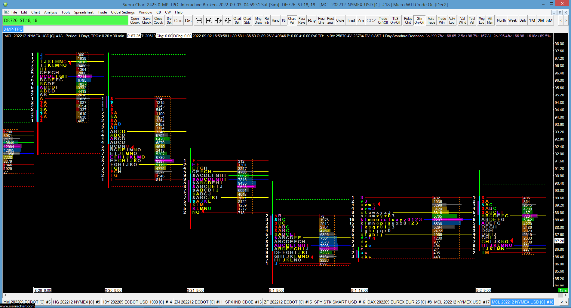

[2022-09-03 08:16:30]
User584084 - Posts: 345
Here is a screenshot of the Intraday Charts for Micro Crude Oil Futures for Oct and Dec in Sierra Chart. Look at the Title Bars and the data. I duplicated the Oct chart and then changed the chart symbol in the Dec chart from MCL-202210-NYMEX-USD to MCL-202212-NYMEX-USD. Then I deleted the data and downloaded the chart data. The charts are set to Continuous Futures Contract - Date Rule Rollover. See 1st link.
It is happening when I change the Dec contract chart settings from 'None' to 'Continuous Futures Contract - Date Rule Rollover'. Before I make that change, the chart data is ok. See 2nd link. After I make the change, the Dec contract shows the Oct contract data. See 3rd link.
#1
https://www.sierrachart.com/image.php?Image=1662194322763.png
#2
https://www.sierrachart.com/image.php?Image=1662195398841.png
#3
https://www.sierrachart.com/image.php?Image=1662195572491.png
Date Time Of Last Edit: 2022-09-03 09:01:46
[2022-09-03 10:11:26]
Sierra_Chart Engineering - Posts: 25374
You are hugely over complicating this by involving the TPO study, Volume Profiles, and the Continuous Contract option (the last one is the worst thing to be doing especially involving an inactive month). You need to understand the consequences of the configuration. Refer to:
Continuous Futures Contract Charts: Issues When Symbol of Chart is not Current Contract and Expires Later
When you want to understand the data in the chart for a particular contract month you need to look at a simple chart. Here is a simple chart of December micro crude oil:
https://www.sierrachart.com/image.php?Image=1662199722427.png
There is no problem whatsoever with the data. It is completely fine. It always is fine. It is not even possible for there to be a problem.
and you cannot trust charts on the CME website because those are not their charts. Those are not a point of reference at all. We will fully disregard any comparison to charts on the CME website because those are not references under any circumstances.
This case is closed.
Date Time Of Last Edit: 2022-09-03 10:25:54
