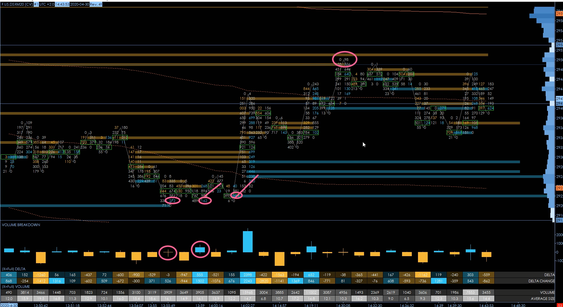

Good morning,
I would like to integrate a line that traces the highs and lows of the footprint. Despite reading the textbook of studies, I still manage to integrate it (even with the current price). Thank you for your help.
PS: I’ve put in a picture at the bottom so you can see.
Date Time Of Last Edit: 2022-08-24 16:34:50
imageFootprint + line.PNG / V - Attached On 2022-08-24 16:34:46 UTC - Size: 22.69 KB - 269 views

Sierra_Chart Engineering - Posts: 25374
We do not understand what your question is here then. What study does that line?

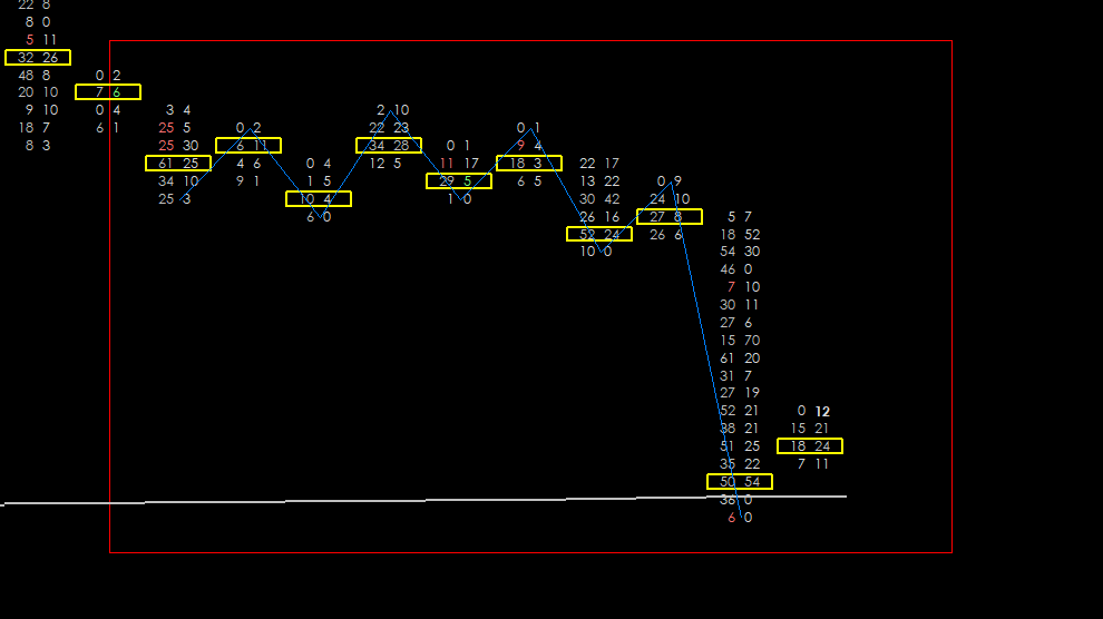

I’m not sure it’s a studie. Maybe it’s in the settings, but I can’t configure that line. I put a better picture below so you can see. (white line)
imagefootprint and line.PNG / V - Attached On 2022-08-25 15:52:34 UTC - Size: 887.35 KB - 296 views

Ackin - Posts: 1865
Try the study ZigZag
Zig Zag
Adding/Modifying Chart Studies
Chart Studies: Adding/Modifying Chart Studies
Yes it could be the zigzag study but we are not sure:
Zig Zag

MB_trading - Posts: 4
Thank you guys,
It is this studie in calculation mode 3 👍👍
