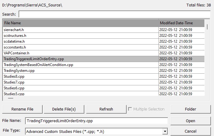

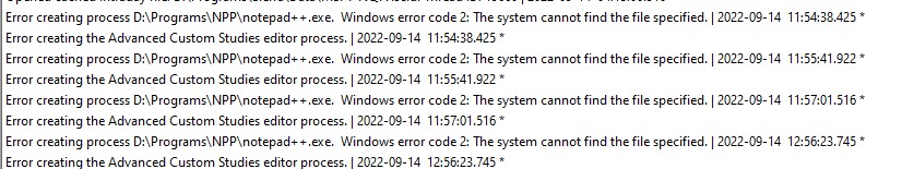

I am trying to follow the instructions on the page to create the above mentioned custom studies for trading and I get an error message upon trying to open any of the templates. Please see screenshots attached.

That error means that your setting for Global Settings >> General Settings >> Paths >> Text Editor Path and Filename is not set correctly. If you do not have Notepad++ installed on your system separately, then this setting should reference the Notepad++ executable that we send with Sierra Chart. It is located under the Main Sierra Chart installation folder in a folder named NPP. The executable is notepad++.exe
If you installed Sierra Chart to the top of your C: drive, then the path and filename for the Notepad++ editor would be the following:
C:\SierraChart\NPP\notepad++.exe
Refer to the following:
General Settings Window: Text Editor Path and Filename (Global Settings >> General Settings >> Paths >> Files and Folder Paths)
