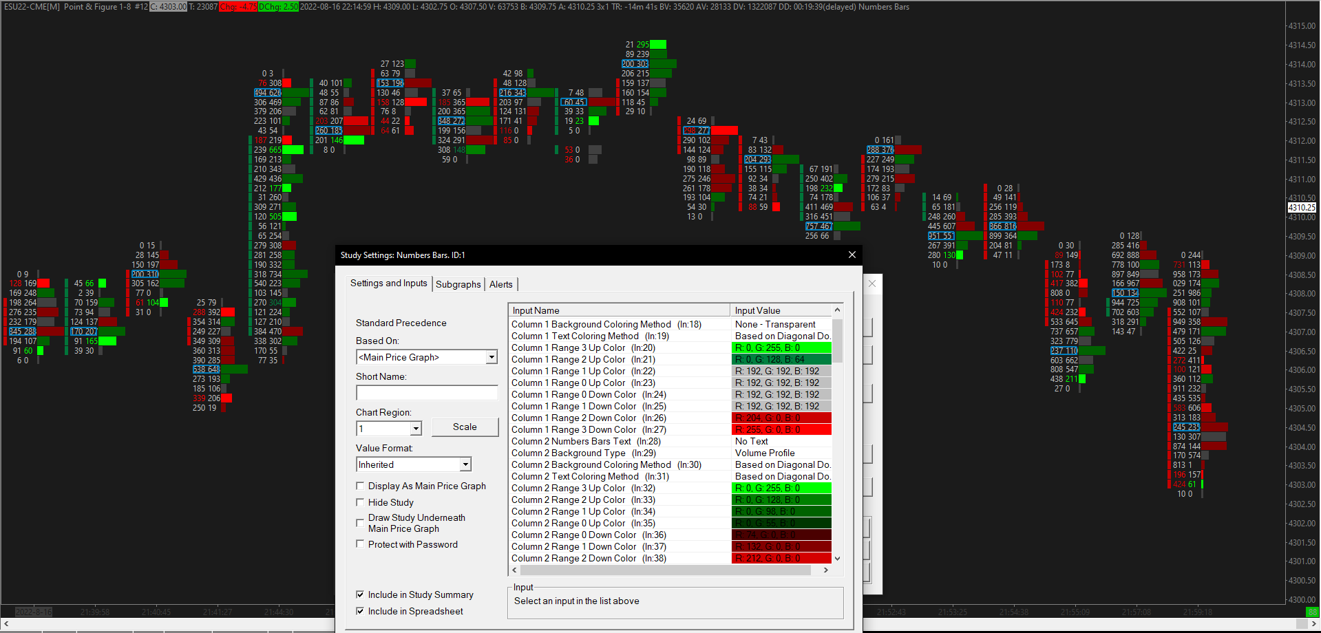

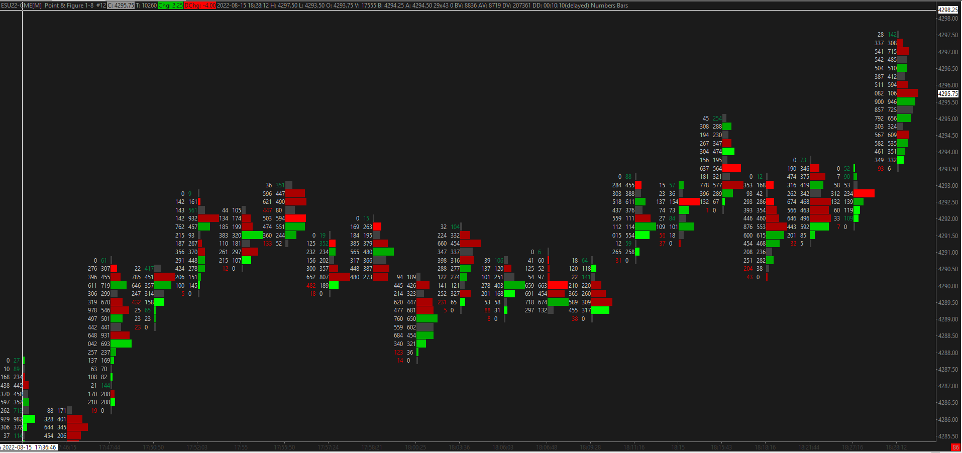

I am trying to create a footprint chart with the setup of the first picture, where it highlights the imbalances like in the second picture attached.
I tried absolutely everything I have been trying for around 8 hours now. I am sure there is a way. I just can't find it.
I tried a bunch of indicators but any seems to work like I want, how can I do that?
Thank you

The main issue is - when I try to have a volume profile on the column 1, I can't play with the colours of the profile, and if I try to create the profile on column 2. then it appears on the right of the footprint like in the 2nd picture.

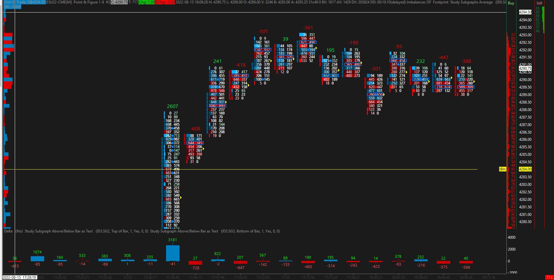

On the picture attached, there's the volume profile on column 2, with the right imbalances set up just like I want. The question would be.
Is there anyway I can have the volume profile on the middle of the bid ask footprint instead of it spaced to the right. With the imbalances?
Thank you once again John.
