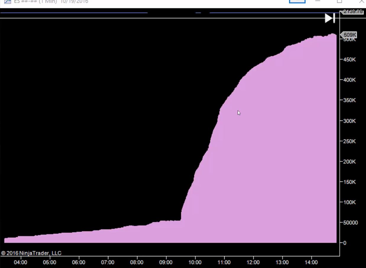

I am trying to replicate attached chart. The idea is to display volume relative to day average volume on 1 min chart. Say we start calculation from session open. We need, for instance, 15 min to start calculation of day volume, then the chart I need is the volume relative to this intraday average, not previous days. I tried relative volume study but it does not seem to be possible to achieve the outcome. Is there any other way?

One thing you can do is add a Moving Average-Simple study based upon Volume and displayed in the Chart Region with Volume. You then can see how the individual bar volume compares to than average.
You would set the Length Input of that study to 15.
