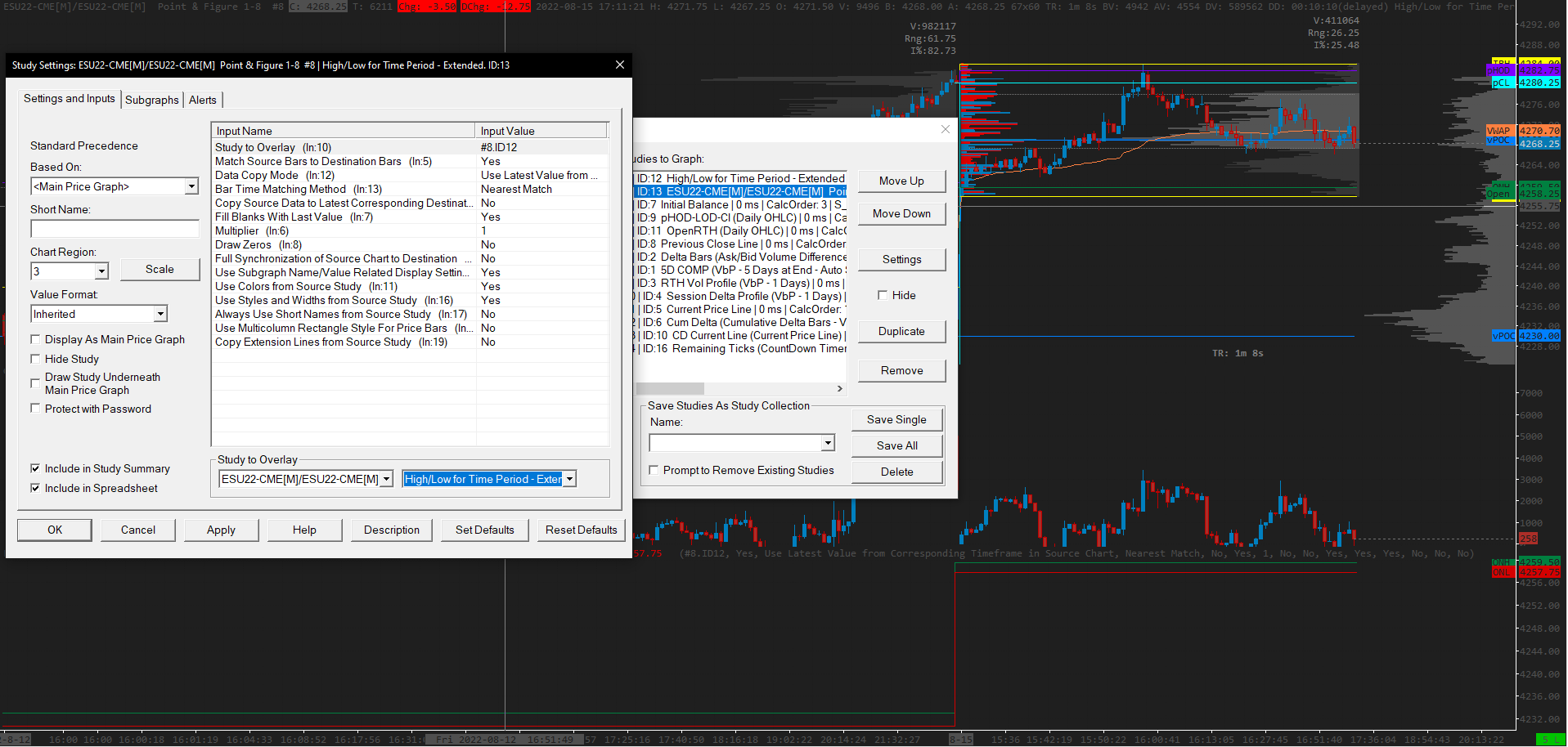

I have been trying to track the ONH and ONL on some RTH charts. I followed all the instructions explained on Sierra but as you can see on the picture attached, the study appears on the bottom of the screen, and not on the chart where I want it to appear.
How can I change this?
Thank you

[2022-08-15 16:05:35]
John - SC Support - Posts: 48429
You just need to change the Chart Region setting on the main tab for the study. Refer to the following:
Chart Studies: Settings and Inputs Tab >> Chart Region

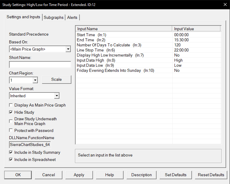

Oh well, just when I thought I had everything done, now the ONH and ONL is not shown on the right place. I followed all the steps I read on Sierra but there is still something I must be doing wrong.
I followed the next steps:
- I created a high/low for time period extended. (You can see the settings on picture 1)
After I created a spreedsheet formula for the ONH and one for the ONL with the following settings:
ONH: =IF(AND(BARTIME>=TIMEVALUE("15:30:00"),BARTIME<TIMEVALUE("22:00:00")),ID12.SG1,0)
ONL: =IF(AND(BARTIME>=TIMEVALUE("15:30:00"),BARTIME<TIMEVALUE("22:00:00")),ID12.SG2,0)
But I find out the ONH and ONL is not shown on the right place, it should be on:
ONH: 4300.25
ONL: 4279.25
And it's actually on 4292.5 for the ONH and 4286.5 for the ONL.
What am I doing wrong?
Thank you

[2022-08-16 21:11:27]
You need to look at each step and figure out which study is not doing its job correctly. It could just be a scaling issue, in that one of the studies is not set to an Automatic scaling, but you have to go through and look at the output at each step an ensure that it is correct. Then move to the next study and see if it is giving the wrong output and then figure out why.
