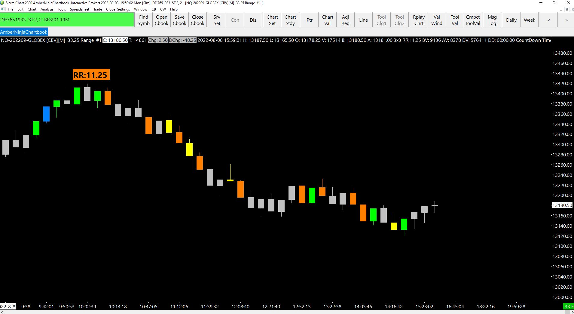

I have interactive brokers as my broker but paid for the denali data. Someone from support helped me set this all up over the phone and my data is set to Interactive Brokers so my broker software has to be open and I have to be logged in to use my data through SC. I dont want to do that. Its annoying. Since I'm paying for Denali data why should I have my data set to Interactive Brokers. How do I set my data to Danali? I dont see it in the list for data settings. I'm connected to SC data feed but why do I have to have my Interactive Brokers software open and logged into also? I'd rather not have the two connected to each other. Thanks

If you are wanting to trade through Interactive Brokers, then you need to have the IB software running in order for Sierra Chart to connect to it. It does not mean that you are getting data from Interactive Brokers. As long as the option for Global Settings >> Data/Trade Service Settings >> Common Settings >> Allow Support For Sierra Chart Data Feeds is set to Yes, then you will be getting real-time data from the exchanges that you have activated with us, from us (in your case, this is the CME Group data).
If you are not trading from Sierra Chart, then you can disconnect from Interactive Brokers, but you will need to connect at least once a month in order to verify your account for the CME Group requirement that allows you to pay the non-professional exchange fee. Refer to the following:

AmberNinja - Posts: 31
Ok, thanks. I'm not trading through sierra charts and right now do not plan to. It seems my SC wont work without me logging into IB before opening SC.
How do I get SC to run without having to open IB? Thanks.
[2022-08-08 22:13:43]
You will need to set the Global Settings >> Data/Trade Service Settings >> Main Settings >> Current Selected Service to SC Data - All Services. Then select OK to close out that window. When it asks you to update the Symbols, you will want to say "Yes".
In this setup, you will not be connected to IB, so you do no need to have the software running. Instead, you are just connecting to our servers for data. Keep in mind the symbols are different, but selecting the "yes" above will update the charts you had open at that time. If you need to update others, then open your Chartbooks and select Edit >> Translate Symbols to Current Service.
