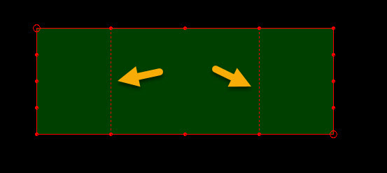

very frustrating question, how to simply move a rectangle?, when I draw a rectangle (not the extended one), I do not see a way to simply move it, if I try to do it it resize on edge or another, how just simply move it without playing with edges?

After you draw your rectangle, depending on your selection of cursor after drawing an object, to stay in draw mode or go back to cursor. Make sure your cursor is either in pointer or crosshair mode. Then click on an edge of your rectangle. When you do that you will see a smaller rectangle within your rectangle. Place your pointer / cursor within that rectangle / two vertical lines and click / drag your object as you want.
Hope that helps
JohnR

I can see the vertical dashed bars and the small cercle bu even with pointer selected, hand or chart value tool, i cannot move the rectangle as a whole, it starts to move two edges to resize it, what's wrong.

2 - Not seeing what you are doing, it is hard to say why it is not working for you. Make sure you have your pointer / cursor in between the vertical dashed bars. If the pointer / cursor is outside of the vertical lines, but inside the rectangle, then it resizes as you describe.

1. Refer to the following documentation for moving the rectangle:
Chart Drawing Tools: Moving Rectangle Drawings
And refer to the following for how to move a rectangle if you are having issues:
Chart Drawing Tools: Preventing Adjust of Rectangle Drawing When Intending Moving
