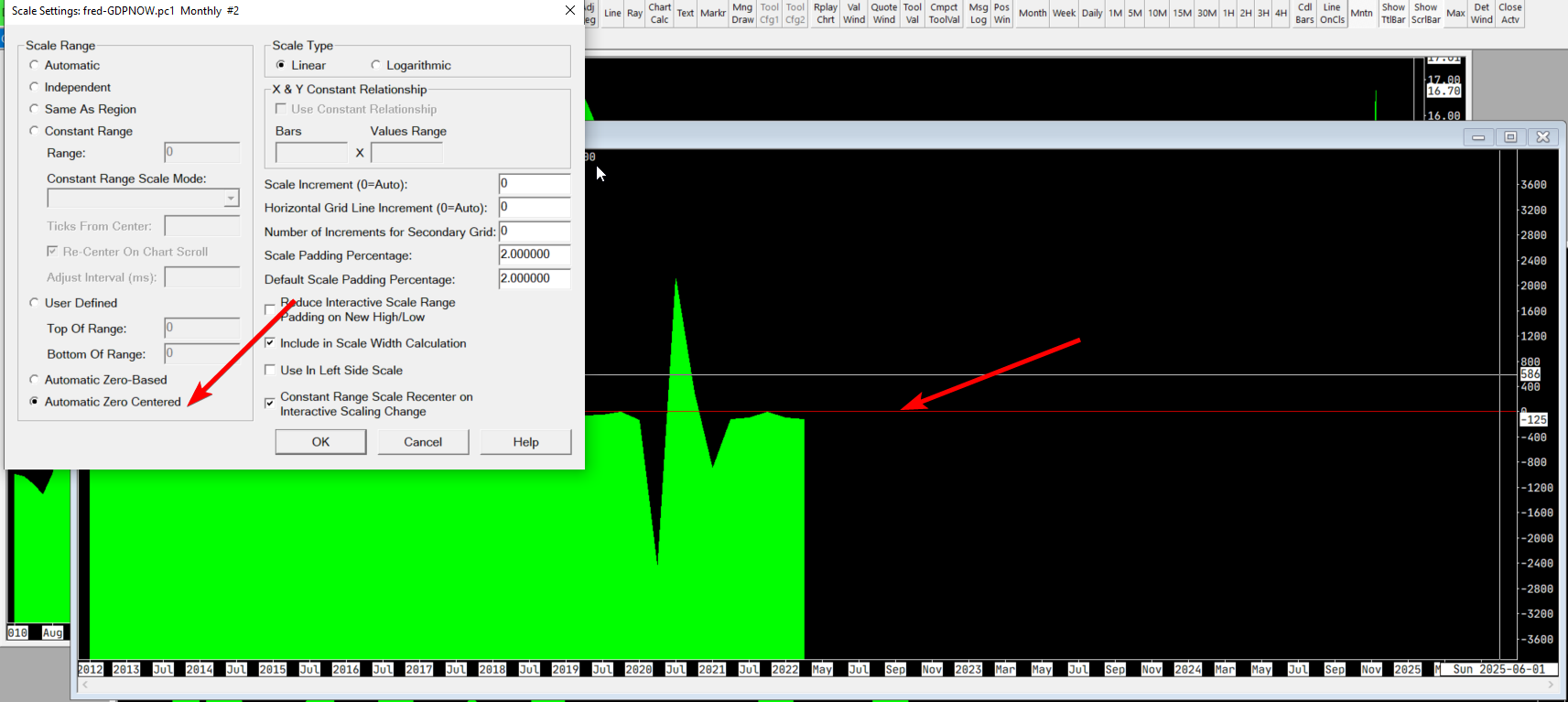

Hello.
Wouldn't it be logical to draw mountain graph in both sides from zero instead of bottom if Automatic Zero Centered scale range is selected? Can it be changed?
image2022-07-27_18-45-47_757b1960-0188-499e-a194-53a772acdf65.png / V - Attached On 2022-07-27 15:48:29 UTC - Size: 211 KB - 205 views
[2022-07-27 19:35:15]
Mountain is specifically to display in the way that you are seeing it. To do what you are wanting, you should use a Study Subgraph Reference study and set the Draw Type to Fill to Zero. Refer to the information here:
Chart Studies: Fill to Zero (ACSIL: DRAWSTYLE_FILL_TO_ZERO)
When doing this, you can then also get different colors for above and below zero by using the Auto-Coloring set to Based on +/-. Refer to the information here:
Chart Studies: Based on Positive/Negative
