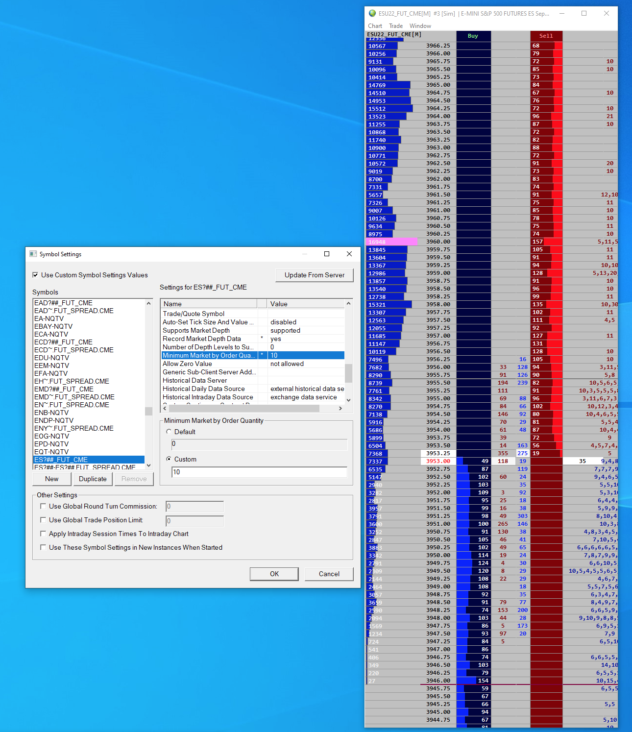

voided - Posts: 45
Yes, I have set the correct values. This was all working fine a week or two ago. Here is a screenshot demonstrating the settings that are actually in effect, as well as a market order column showing orders of 3, 4, 6, etc. even though the "minimum market by order quantity" is set to 10.

[2022-07-25 19:34:19]
Are you using a Trade and Current Quote Symbol? If you are, and the option for Use as Trade Only Symbol is set to No, then the depth data will be for the entered Trade and Current Quote Symbol, so you need to ensure that you have also set that symbol to have a Minimum Market by Order Quantity.

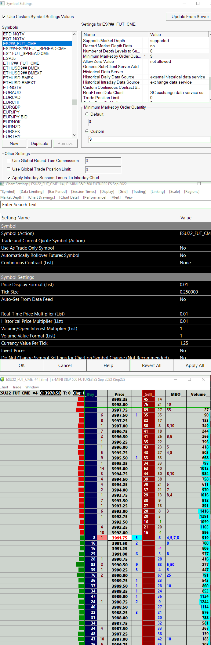

[2022-07-25 19:54:41]
User259545 - Posts: 26
Yes, I can change the symbol settings and I do have the USE Custom Symbol Setting Value enabled.

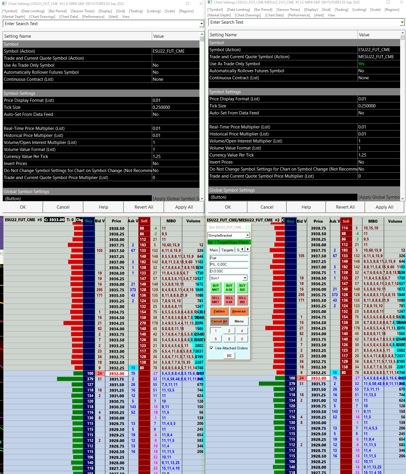

[2022-07-26 17:32:47]
This is Sub-instance 2 and I put 2 DOMs up one with and one without. The pic shows the chart settings...
I also included the Symbol Settings for the 1st instance. The 2nd instance Symbol Settings are set the same even though that shouldn't matter.
imageImage 2.gif / V - Attached On 2022-07-26 17:29:08 UTC - Size: 192.87 KB - 226 views
imageImage 5.gif / V - Attached On 2022-07-26 17:29:29 UTC - Size: 81.33 KB - 228 views
[2022-07-26 17:52:55]
The "Minimum Market by Order Quantity" custom value set worked with the 2nd instance up until a week or so ago. I've been using it every since I upgraded to the MBO data and it has been very useful. As you can see by the pics, without being able to set minimum MBO quantity the data become overwhelming and almost useless. It's crazy now that you can't set this. Is it something that you folks are going to look at in the future? Again, I want to thank you for the time...
