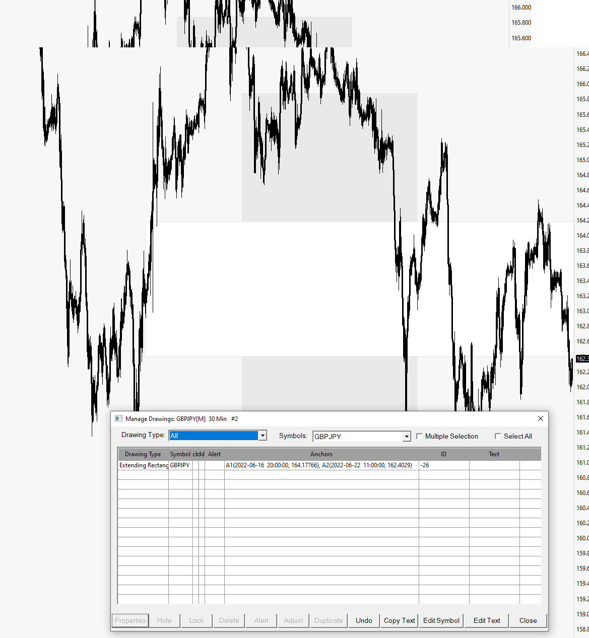

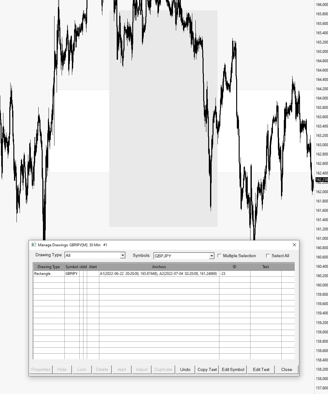

Attached is the chartbook, and screenshots of the contents. Two charts only, one object on each and the issue is very clear.
Private File
imagesier2.png / V - Attached On 2022-07-12 11:25:33 UTC - Size: 81.58 KB - 191 views
[2022-07-12 11:26:15]
User34124 - Posts: 289
Chart #2
imagesier22.png / V - Attached On 2022-07-12 11:26:11 UTC - Size: 55.14 KB - 268 views
[2022-07-12 16:16:54]
John - SC Support - Posts: 48633
Since there is a rectangle in each chart, we would expect that the rectangles would display different in each chart. Basically, the copied drawings are drawn first, then the drawings for the actual chart. Therefore, we do not see any issue with what you are seeing.
Additionally, you have each chart listed for itself in the copy Chart Drawings To setting. In other words, you have for both charts listed "1, 2", so both charts have themselves listed. We are not saying that this is causing an issue, but it could. We do not recommend listing the chart itself in this list.
The duplicate number is not the issue. The issue is simply that each chart has 1 drawing apiece. Therefore, they are respecting the order in the Manage Chart Drawings window, as each chart is drawing that particular drawing last.
The suggestion for the individual chart number is just to ensure there is not another issue that could be caused by that.
