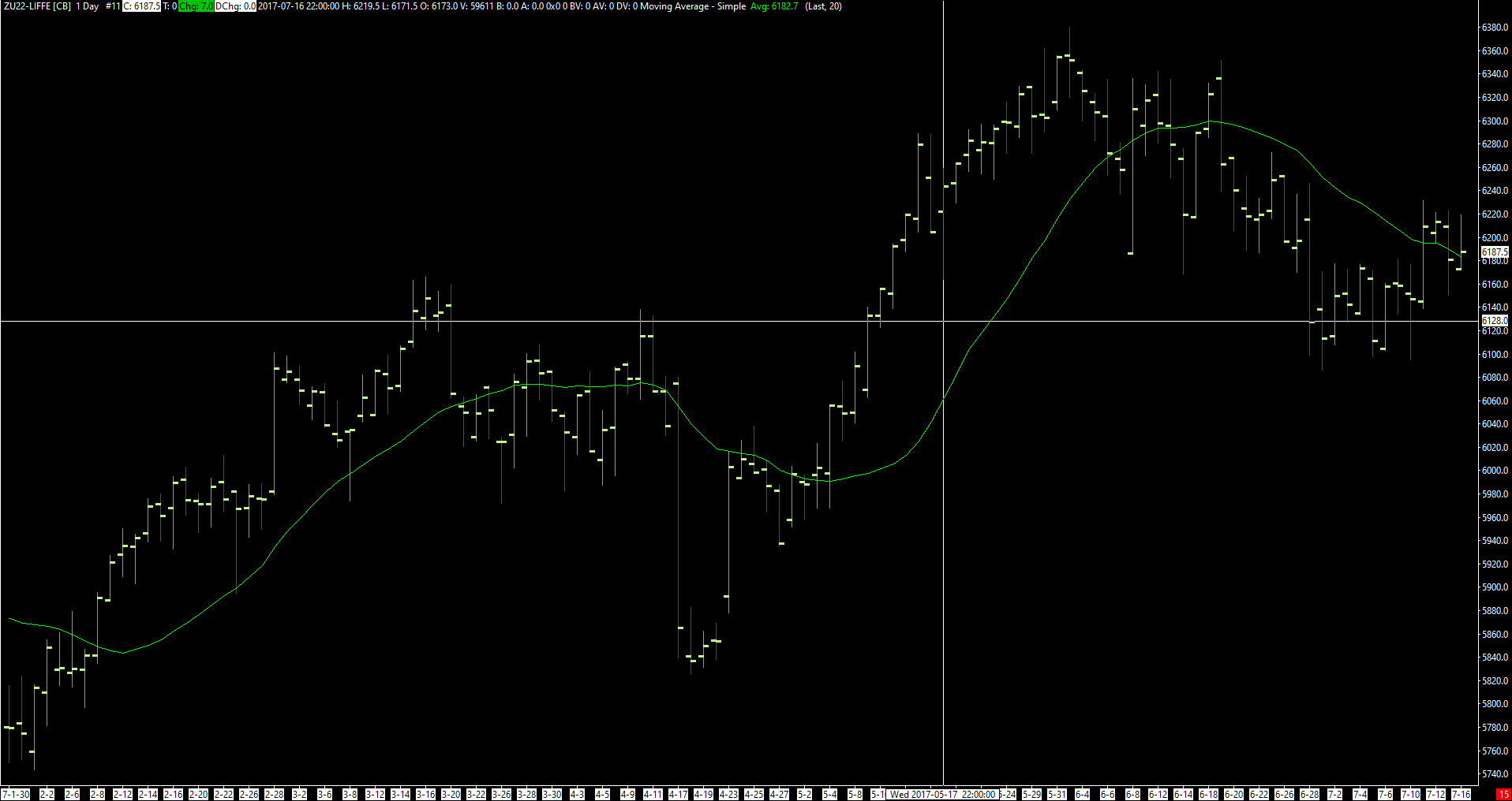

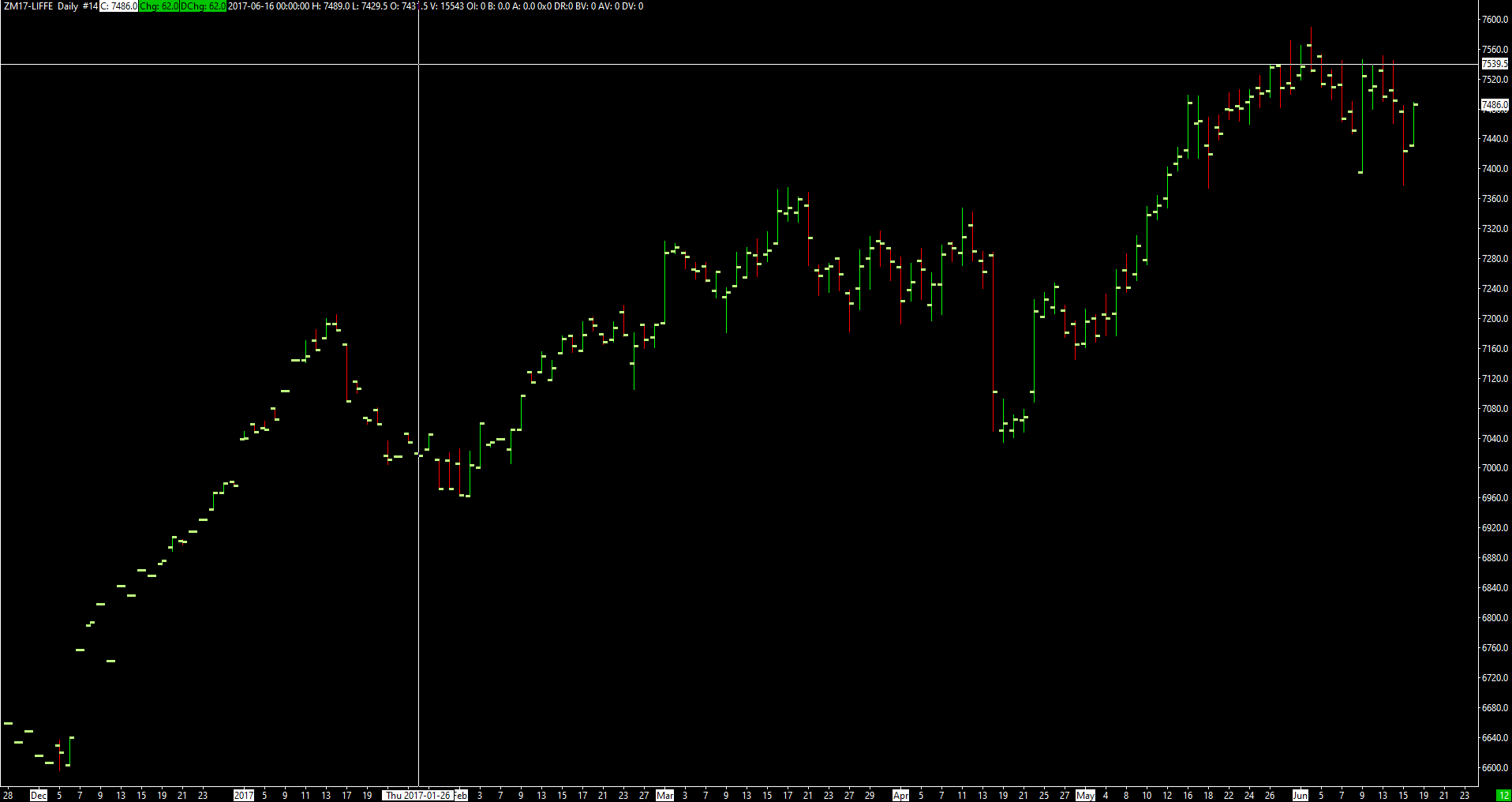

False values showing when loading historical chart and when loading that particular contract than the value are shown correct and this is the same when loading the contract with continuous contract rollover is on or off. I am also attaching two screenshots one with the contract loading historical values and other with a particular contract open ( june 2017 ) for FTSE 100 futures (Z symbol code ) ( Liffe exchange )
https://www.sierrachart.com/image.php?Image=1657204311397.png
https://www.sierrachart.com/image.php?Image=1657204347444.png
imagejune17_contract.PNG / V - Attached On 2022-07-07 14:28:09 UTC - Size: 54.65 KB - 263 views
imagehistorical.PNG / V - Attached On 2022-07-07 14:28:15 UTC - Size: 77.23 KB - 193 views

Your Continuous Futures Contract is set to a "Back Adjusted" option. This adjusts the previous data in order to have not have a gap in the prices where the contracts change. Refer to the information here:
Continuous Futures Contract Charts: Understanding Back Adjusted Price Data and Comparisons

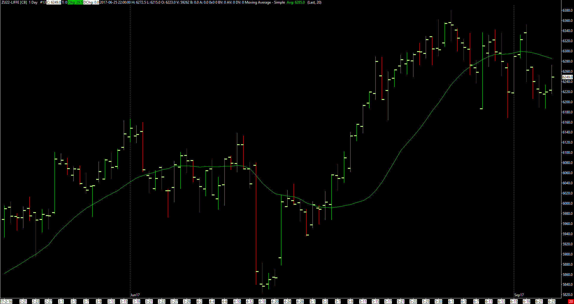

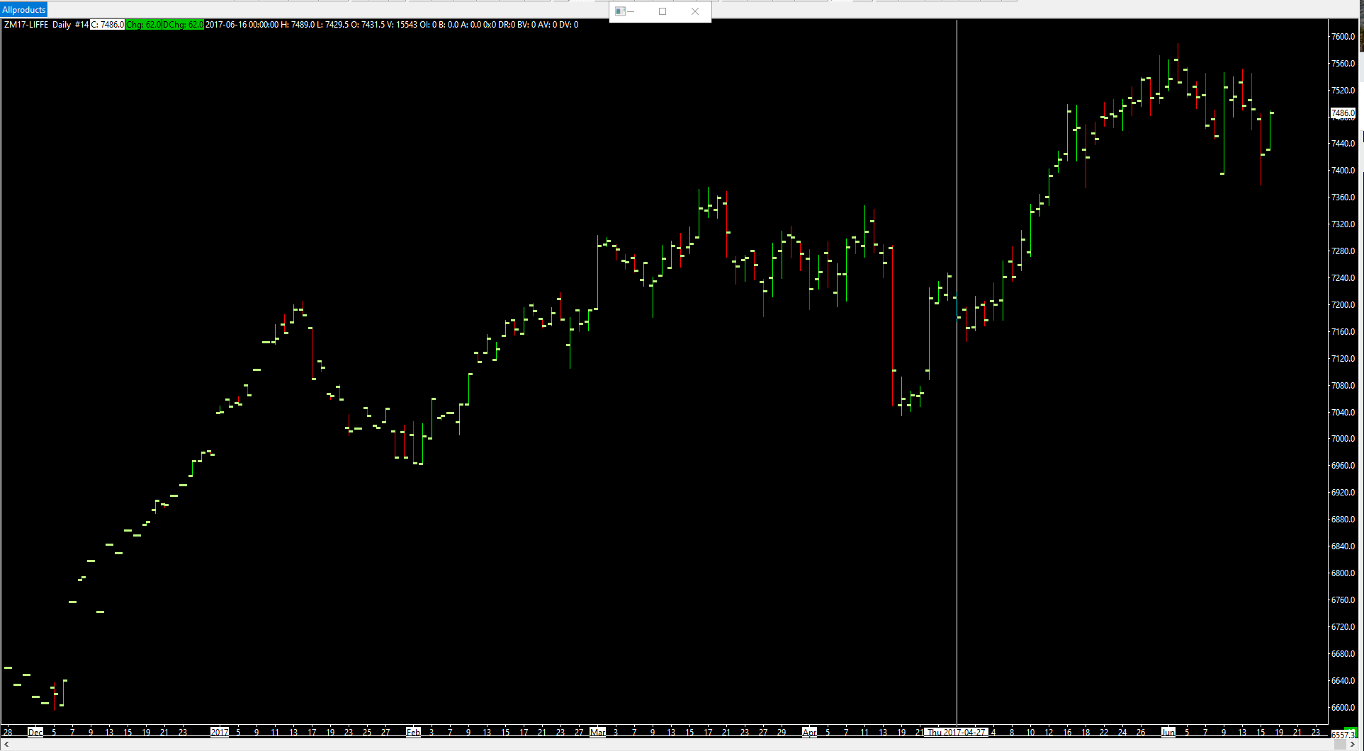

Yes but even if I set rollover to no than also it is showing false values as you can see in the link below
https://www.sierrachart.com/image.php?Image=16572190172.png

It is not a matter of setting the rollover to "no". If you want to have the data match exactly, then you would need to use a Continuous Futures Contract that does not include the Back Adjustment. We can see that you are still using a back-adjusted option since you have a [CB] showing after your symbol in the Region Data Line at the top. That B stands for Back-Adjusted. Refer to the following:
Continuous Futures Contract Charts: Text Indicator Description Table
