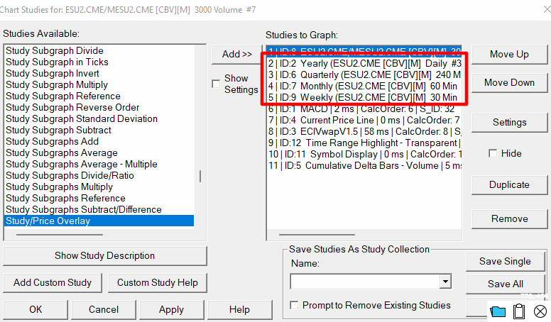

So I found the way to "Copying Chart Drawings from Other Chartbooks" that works great. Now I want to be able to copy studies from other chartbooks. I duplicated a chart to a new chartbook with identical study settings but the new chart does not pick up the study links information from the other chartbook. Is there a way to do that?

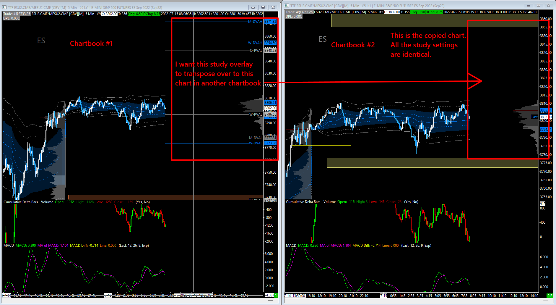

[2022-07-15 16:48:50]
Thaddeus Fulmer - Posts: 71
Volume by price is not what I was referring to. I'm referring to the Study price overlay to the right of bar chart. "Line at last bar to edge" area. the chart on the left has the horizontal lines while the chart on the right does not.
I essentially want to have the duplicated chart in the new chartbook, pick up the information from charts in another chartbook. I want the study by price overlay to pick up information from parent charts in another chartbook. Because if I just duplicate the chart to another chartbook, I would have to create all new charts and link to the study by price study. I don't want to do that. I want my duplicated chart to give me all the same information as if it was in the original chartbook.

[2022-07-15 17:03:20]
John - SC Support - Posts: 48363
You can't do what you want. You can not reference studies between chartbooks. So the Study/Price Overlay studies that you have on the copied chart in a new Chartbook do not have anything to reference, as they are trying to find a Chart and Study with IDs that do not exist in the new chartbook.
