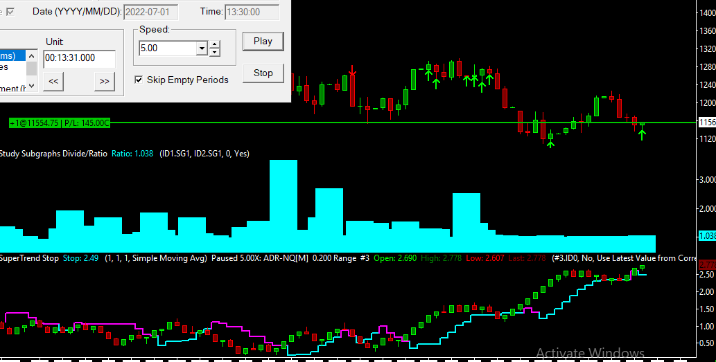

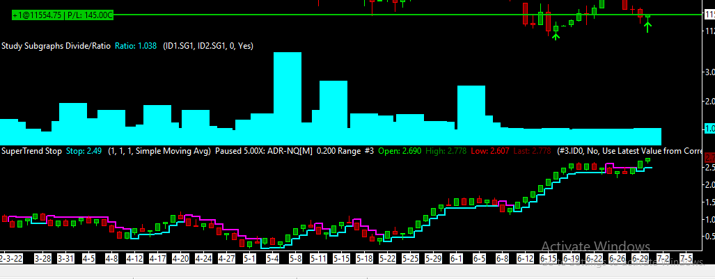

I have added the ''study/price overlay'' on a chart to overlay a 2nd chart on my main chart, but the main issue i get is when a study such as ''SuperTrend'' is based on the overlaid chart, it doesnt sync with the chart. it gets out of sync every time new bars form and i don't understand why.

Sawtooth - Posts: 4357
There are two settings that affect this:
Data Copy Mode
Bar Time Matching Method
Experiment with both, but if neither setting resolves the issue, there is nothing else you can do.
Also, if the either chart is not time based, the Data Copy Mode should be set to 'Use Earliest...'
Auto Trade System Back Testing: Performing Back Testing on a Trading System That Uses Multiple Charts
Even if you find a setting that works, it's possible it will still occasionally repaint as one 'catches up' with the other.
