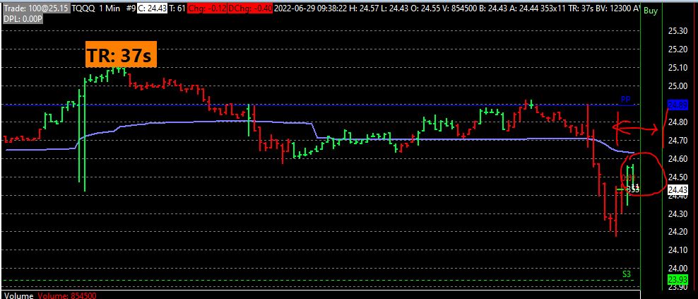

How to set the spacing between the first bar and price axis on its right?
View Count: 838
[2022-06-29 13:43:37]
User513952 - Posts: 85
imagechart1.JPG / V - Attached On 2022-06-29 13:43:26 UTC - Size: 94.21 KB - 233 views

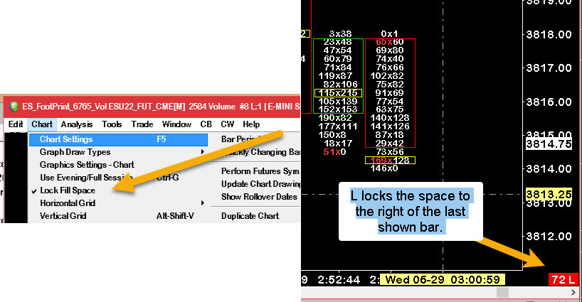

The control of the right space and the last shown bar is what SC calls "Fill Space". There is an option under Chart -> Lock Fill Space on the menu. If it is checked, then you will see an L in the bottom right of your chart. if you want to change the spacing after the last bar and the right of the chart, then uncheck the menu item, scroll the chart to the desired amount of empty space and then reset the lock option. IT is not a requirement that you use the lock option. There will only be a # if the lock option is not selected.
Working With Charts: Scrolling The Chart and Right Side Fill Space
Hope that helps.
JohnR
