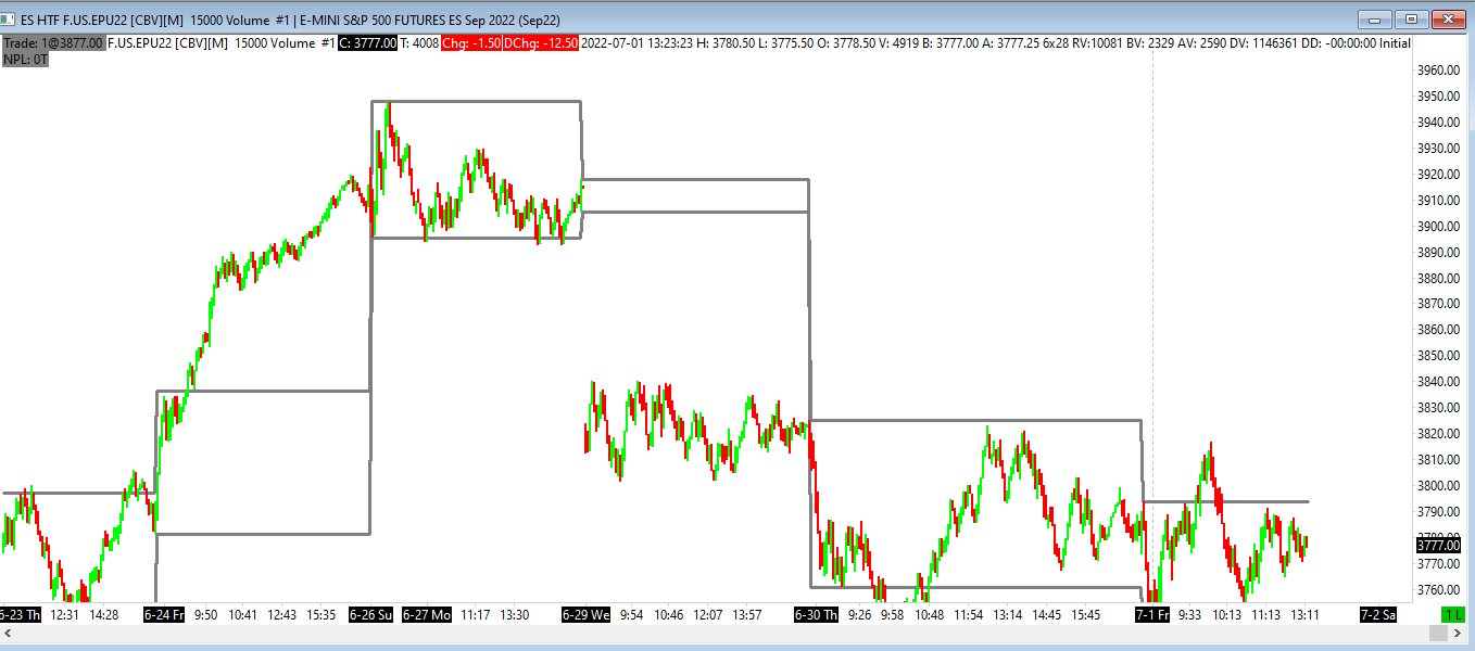

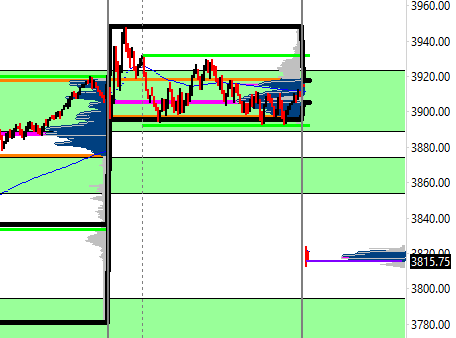

F.US.EPU22 gapped down overnight but my initial balance (black) for overnight H/L did not follow and record the new overnight low. Is this an actual gap or am I having a chart/data problem?

It is impossible for us to answer this unless we get that particular chart by following these instructions:
And remove all unnecessary studies from that chart.
We also need to know the time zone of that chart.

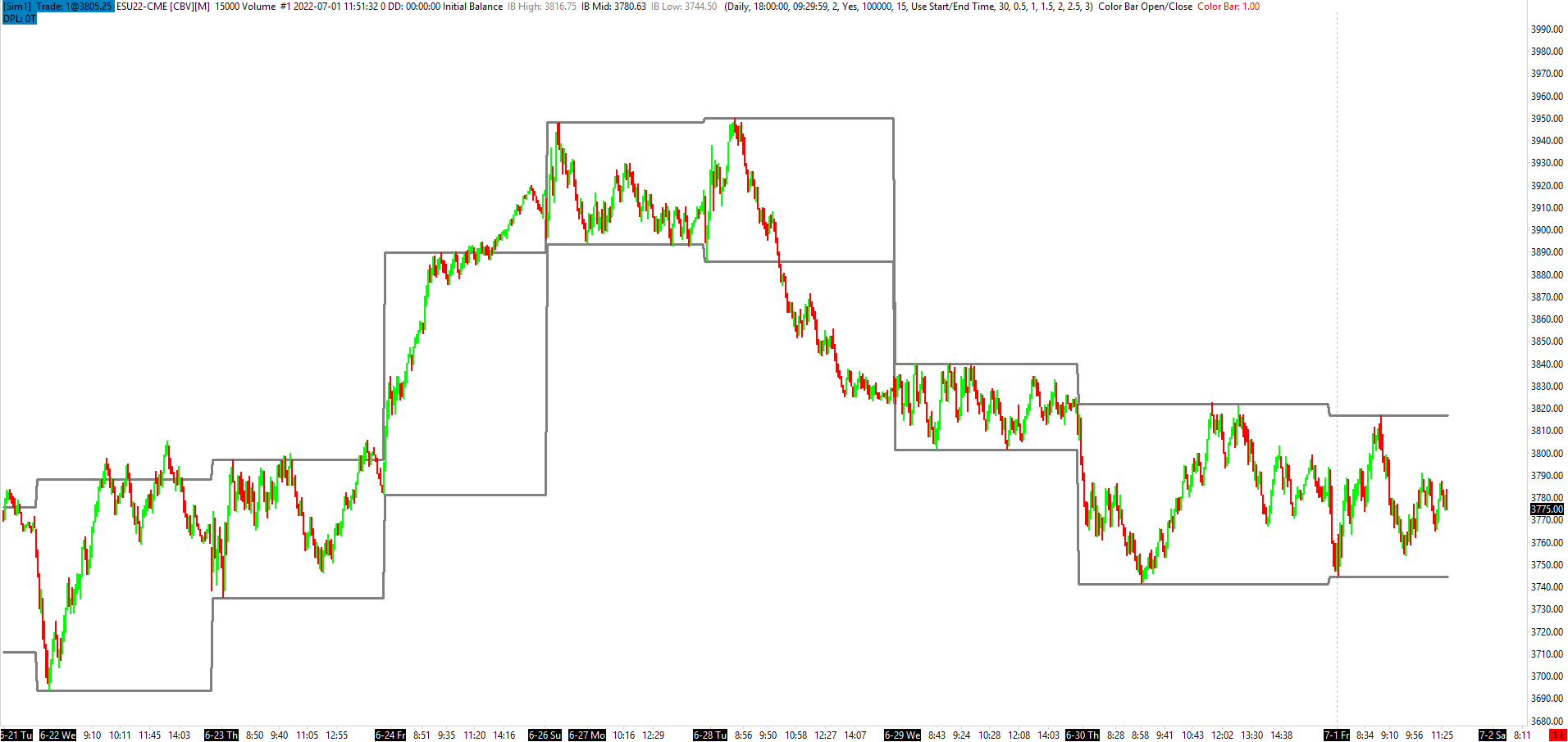

Please show us an image of your chart.
Here is what we see:
https://www.sierrachart.com/image.php?Image=1656695450325.png

imagegap.PNG / V - Attached On 2022-07-01 17:25:02 UTC - Size: 50.62 KB - 213 views
[2022-07-01 17:31:30]
User412994 - Posts: 15
Your image looks right, mine has a gap.
[2022-07-01 17:54:10]
John - SC Support - Posts: 48039
Your Session Times are not correct. You have the following:
Start Time: 18:00
End Time: 17:00
And you state that your time zone is New York. The break for the ES occurs from 17:00 to 17:59:59 New York time. So change your Session Times to:
Start Time: 17:00
End Time: 17:59:59
