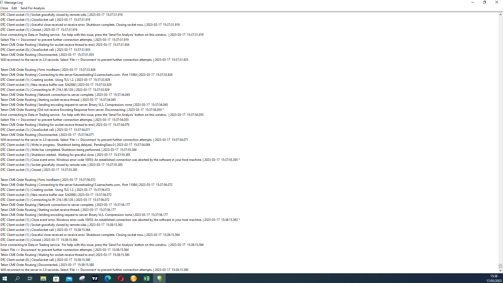

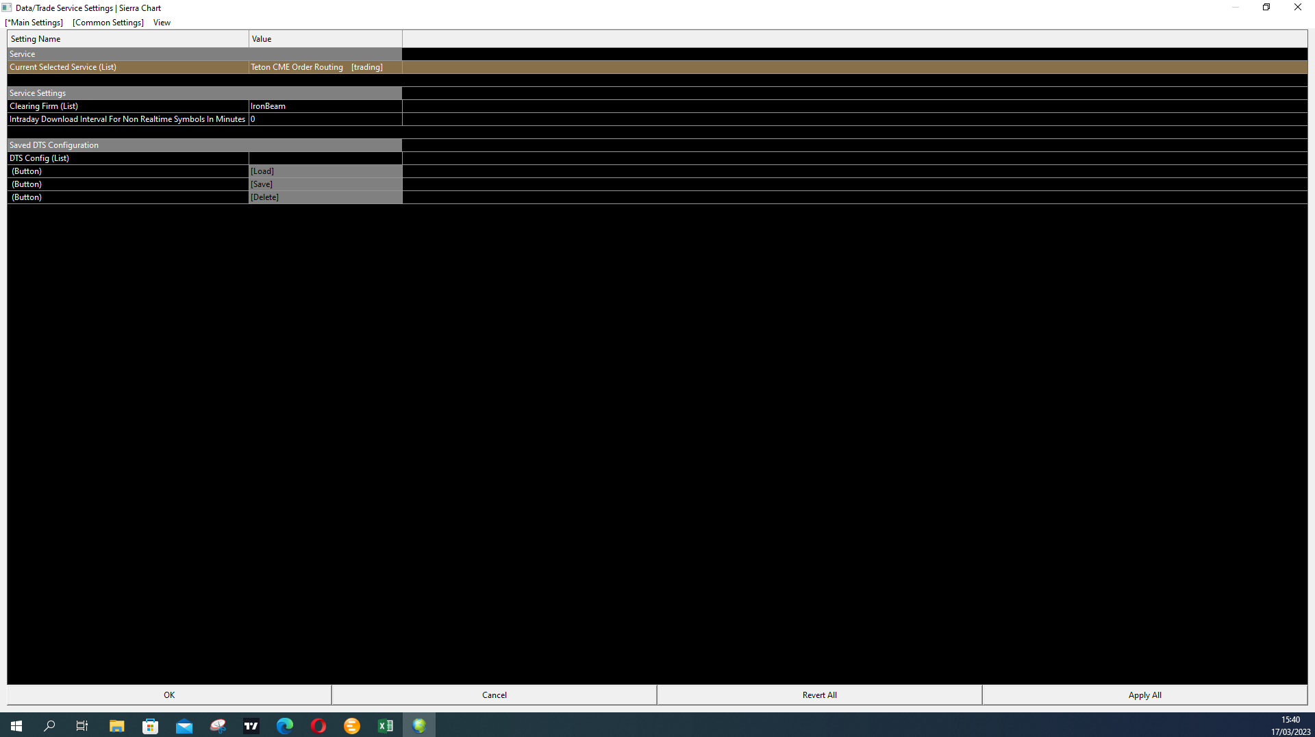

[2023-03-17 15:41:15]
florinsandru - Posts: 14
Hi, now I can't connect at all. please see screen shots.
Thank you.
image1.PNG / V - Attached On 2023-03-17 15:40:59 UTC - Size: 176.22 KB - 273 views
image2.PNG / V - Attached On 2023-03-17 15:41:05 UTC - Size: 84.75 KB - 287 views
[2023-03-17 16:07:59]
You have a network connectivity problem somewhere. Try again:
