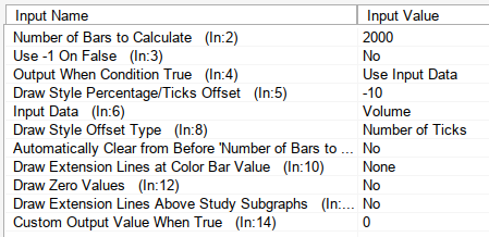

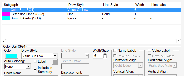

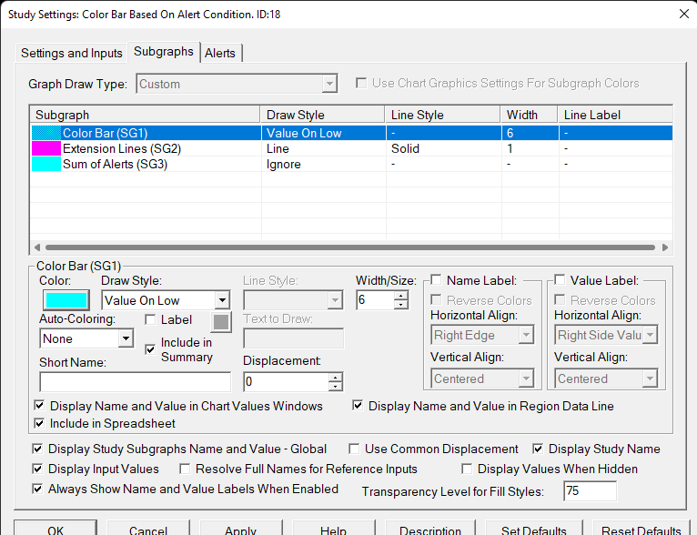

If I think I understand what you want to do, I think this will do what you want:
1. Add a Color Bar Based On Alert Condition study.
2. Change the settings on both tabs as indicated.
3. Sit back and enjoy watching realtime volume as your bar builds... :)

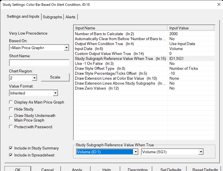

I don't know what I did wrong but this did nothing at all on my volume. I also noticed some of the inputs on your screenshot are different from mine. Looks like your tab doesn't have "Study Subgraph Reference value when true". I set it to ID1.SG1. ID1 is Volume and SG1 is also volume. I'm pretty sure everything else is the same. It's on Chart Region 2 which is volume.

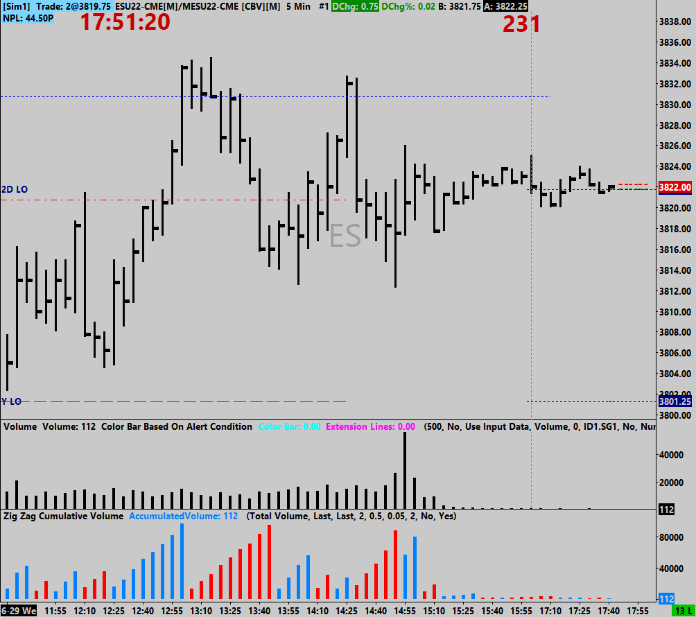

Yeah, I tried that too but don't see anything on the chart. What should I see? I thought my volume bars would change to red or green but since its on Chart Region 1, I'm not sure what I should see. As you can see it is listed on the top left but I don't see anything.

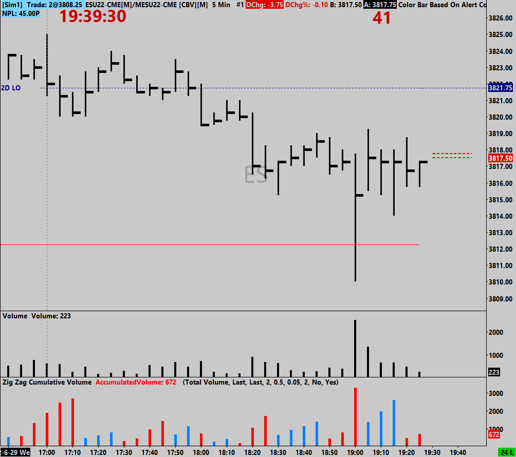

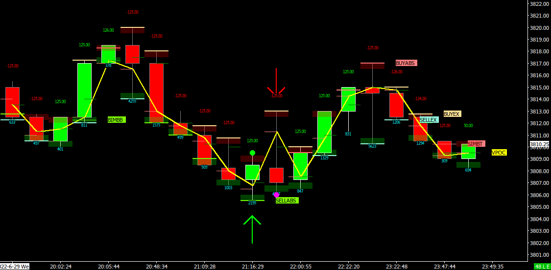

Here's a picture. The cyan numbers at the bottom of the chart are the volume on that bar, and they change as the bar is forming. The numbers at the top are the delta volume on the bar, and they, too, change as the bar is forming. I've attached a chartbook for your viewing pleasure :)

[2022-06-30 08:26:12]
58LesPaul - Posts: 429
Looks like I'm going to need the advanced package to get that to work.
I did notice your study was titled "Volume on Bar(Color Bar Based on Alert Condition)". Why is it titled Volume on Bar and when added to my chart its labeled "Color Bar Based on Alert Condition"?
Thanks a lot
[2022-06-30 09:32:00]
Ed C. - Posts: 128
No, you don't need the advanced package to get it to work. Did you update the trade symbol on the chart? Edit|Translate Symbols To Current Service
[2022-06-30 10:42:33]
That got it, thanks! Not really showing me the percentage of volume on current bar compared to previous bar though while the current bar is forming. Thanks for your trouble though, I'm going to study this chartbook.
