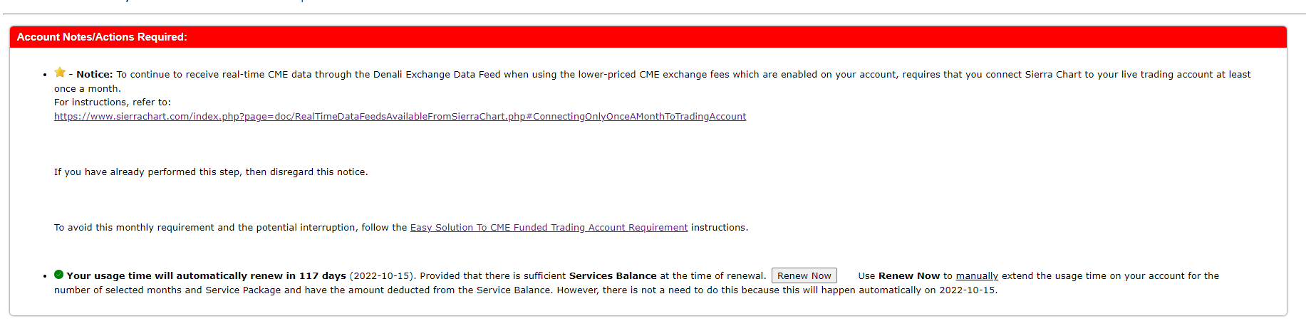

I'm trying to verify my trading account in order to get back my real time data on sierra charts but when i follow these steps it's not working

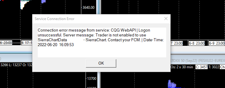

I do trade with Qtrader platform so when i try to connect with CQG Web Api(the only CQG option on Current Selected Service List) i get the error message attached.

imagesierra instruction .png / V - Attached On 2022-06-20 16:25:32 UTC - Size: 43.98 KB - 315 views
imageconnection error.png / V - Attached On 2022-06-20 16:25:37 UTC - Size: 22.04 KB - 304 views

Refer to the following:
CQG Trading Platform Service: CQG Account Requirements
You will need to tell your broker to add the options to your CQG account.

You should not have to tell them to add the Sierra Chart information to your CQG account every month. They should just do it once and be done. You would have to check with your broker as to why there was a change.

You just need to connect to your CQG account from your Sierra Chart software. To do this, follow these instructions:
CQG Trading Platform Service: Setup Instructions
But, what we saw previously was that you had done this setup, but you got a rejection from CQG since Sierra Chart was not setup to connect to your CQG account. Therefore, you needed to tell your broker to add the Sierra Chart options to your CQG account to allow Sierra Chart to connect.
Going forward, if you are not wanting to keep your Sierra Chart connected to your CQG account at all times, then you will want to follow these instructions at least once a month to make the connection to your CQG account:
