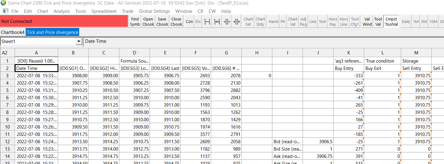

[2022-07-10 14:38:22]
SSGill - Posts: 36
Hello;
I am trying to save the first instance when last TICK crosses over 0 for each 1 minute bar.
I have tried the above instructions and used =AND(OR(E3=10,K3>0),H3=FALSE) the formula recommended. Please see the attached screenshot.
So my formula is as follows: once the condition comes true in L3, turn the 0 to a 1.
=AND(h$3=false,or(crossfromabove(aq3:aq4,0), l3>0))
Then I need to record the instance of last price (e3) upon L3 becoming true.
=if(m3>0,m3,if(l3=1,e3,0))
both columns work on the first row, however the same value gets carried forward for each cell instead of L3, M3 resetting itself to 0.
I have included a screenshot, and the workbook for your reference. The issue is in the TandP_ES.scss worksheet.
Any other methods or solutions to achieve the same result would be greatly appreciated. I hope, when I get this resolved to display a dot on the ES price bar, at the price in column M on the chart.
However, once the value goes true for the first minute I run the spreadsheet, the value carries over for each subsequent row, and will not reset itself.
imageScreenshot 2022-07-10 101102.png / V - Attached On 2022-07-10 14:35:39 UTC - Size: 64.16 KB - 223 views

[2022-07-10 21:11:51]
Sawtooth - Posts: 4359
Locking an intrabar TRUE cannot produce an intrabar value when it locked.
It could only mark the bar that it occurred within, to then get a OHLC price.
But if that locked TRUE gets reset, that marked bar would lose its mark.
So this would have a limited usefulness, e.g. for an entry or exit only while locked.
Also, getting a TRUE to lock and unlock automatically properly can be tricky.
