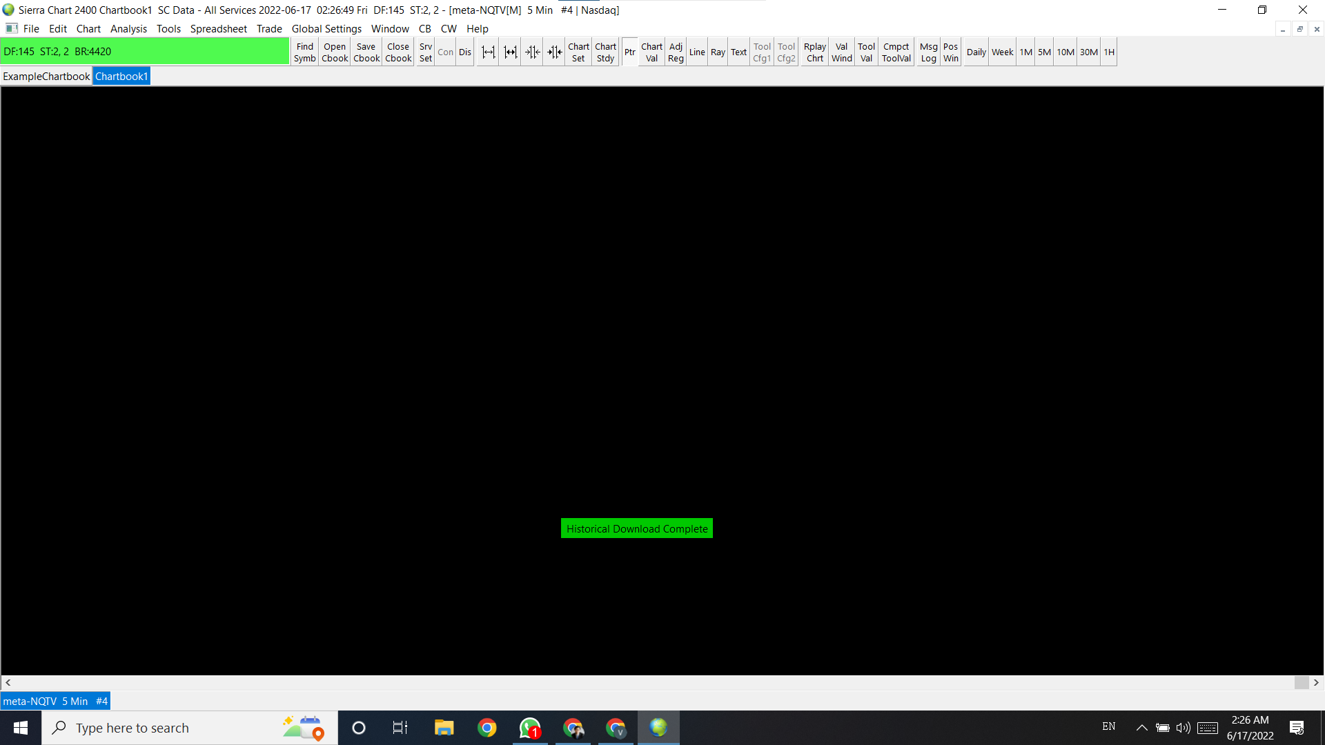

I see, thx for helping the refund, I signed the Market Data Agreements I believe. Now I can use Nasdaq TotalView to view daily timeframe, but smaller timeframe is just blank, do you know why?
imageScreenshot 2022-06-17 022721.png / V - Attached On 2022-06-16 18:43:40 UTC - Size: 103.48 KB - 309 views

There is not reason for having issues with different timeframes, unless you have stored your data at a higher increment. Just to ensure this is not the case, check to make sure the setting for Global Settings >> Data/Trade Service Settings >> Common Settings >> Intraday Data Storage Time Unit is set to 1 Tick.
From your image, the historical data had downloaded, but since that message is still on the screen it implies that it is still working on getting the Intraday historical data.
If you have left the chart up, then by the time you are reading this, the chart should be fully loaded at this time.
If you still do not have the data, then make sure you scale is set to Automatic and then reset the scale to ensure that the data isn't just off screen somewhere. Refer to the following for how to do this:
Chart Scale and Scale Adjusting: Automatic (Scale Range)
Chart Scale and Scale Adjusting: Resetting the Scale
If you continue to have issues then let us know.

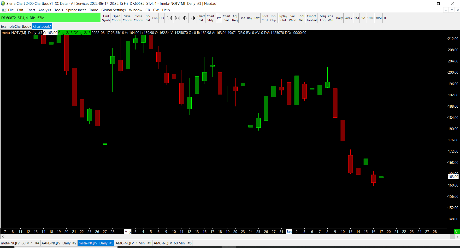

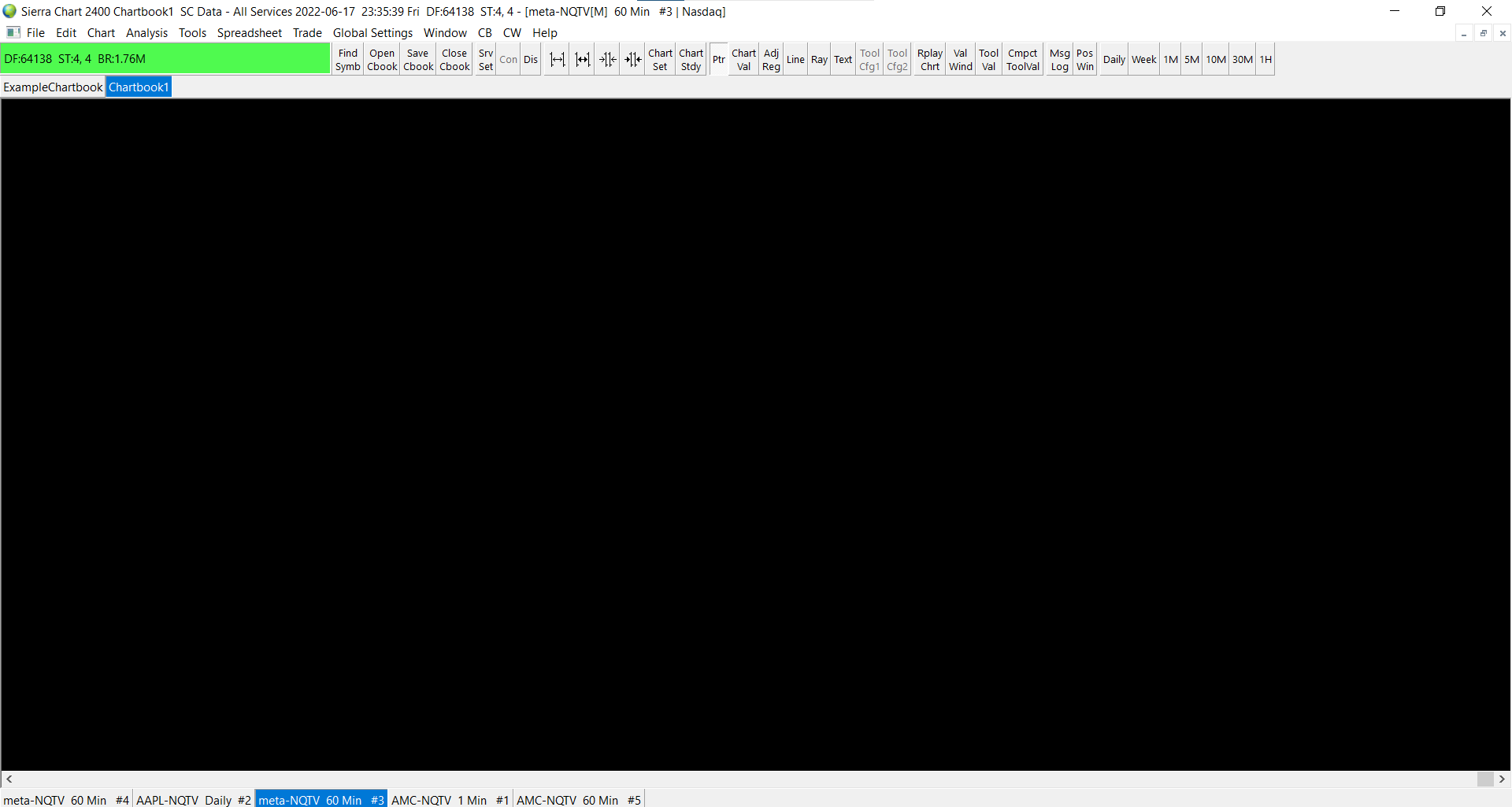

Thx for reply, Global Settings >> Data/Trade Service Settings >> Common Settings >> Intraday Data Storage Time Unit is set to 1 Tick.
And it just blank when I changed from daily to any timeframe smaller than it, say 1h, 15min, 5min etc......
I tried META, AAPL, and other stocks, same...... find symbal>>META-NQTV>>open historical chart>>daily pop out, but if I choose Open Intraday Chart, then just all black

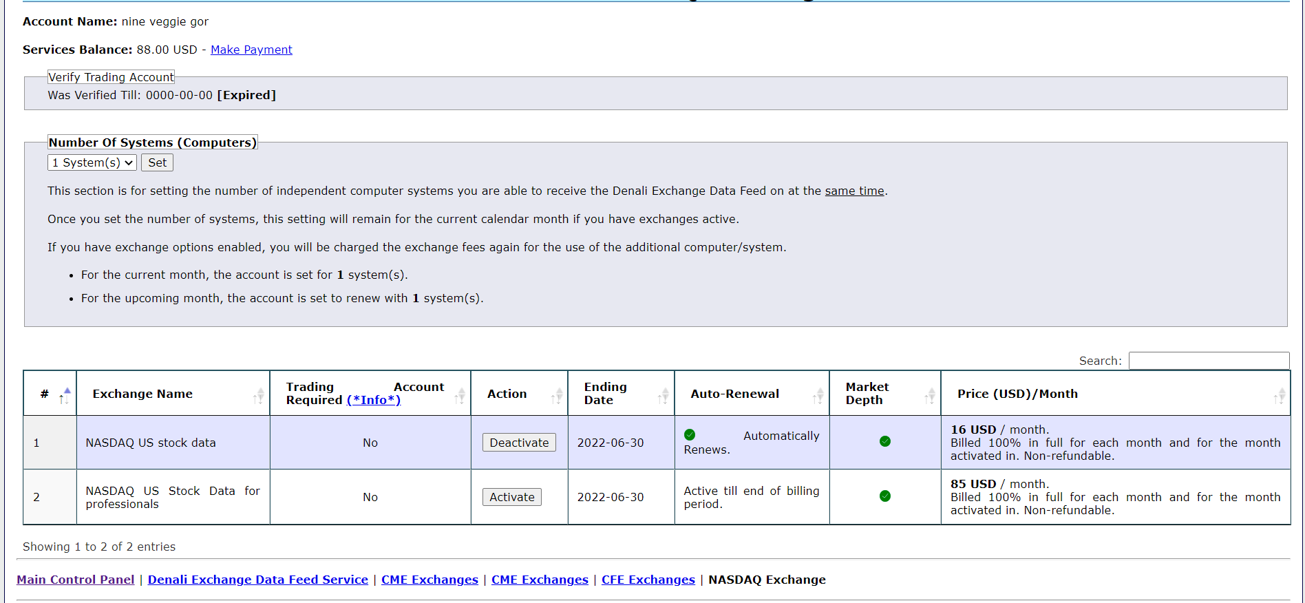

The only thing we can think is to check your Draw Type to ensure it is not Blank. Select Chart >> Chart Draw Type and make sure it is not set to Blank.
There is a possibility that since you had activated both the Non-Professional and the Professional exchanges that this is causing a conflict. We see you had deactivated the Non-Professional exchange, but your agreements state that you are a non-professional. Which exchange option do you want to keep?

User345901 - Posts: 9
I'm a non-professional guy. I checked my account as attachment, I activate non-professional exchange.
Veggie
imageScreenshot 2022-06-17 222446.png / V - Attached On 2022-06-17 14:25:40 UTC - Size: 88.14 KB - 244 views
[2022-06-17 15:21:28]
Sorry, you are right. I misread the information.
We will look into the issue with the exchanges to see if this might be the issue.
[2022-06-17 15:23:45]
We have fully cancelled the Professional exchange for your account. Please exit from Sierra Chart and restart. Then see if you can get the stock data. Make sure you are entering the symbols with the -NQTV suffix.

[2022-06-17 16:32:39]
Your log shows you are getting data.
Please attach your chartbook to this thread for us to take a look. Refer to the following for how to attach a file:

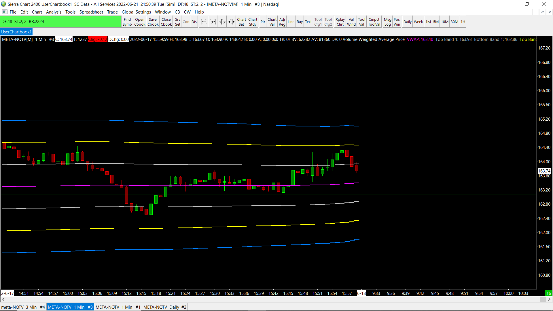

[2022-06-17 17:32:58]
The issue is not related to this:
We set the time zone for all of the charts in your Chartbook to US Eastern time. Save and open the attached Chartbook and you should see the chart bars. If not, let us know.
Instructions:
Chartbooks (Workspaces): Using a Chartbook Provided by Sierra Chart Support
Date Time Of Last Edit: 2022-06-17 17:34:18
attachmentUserChartbook1.Cht - Attached On 2022-06-17 17:32:51 UTC - Size: 5.66 KB - 324 views
[2022-06-18 15:46:44]
Work like a charm! Thank you!

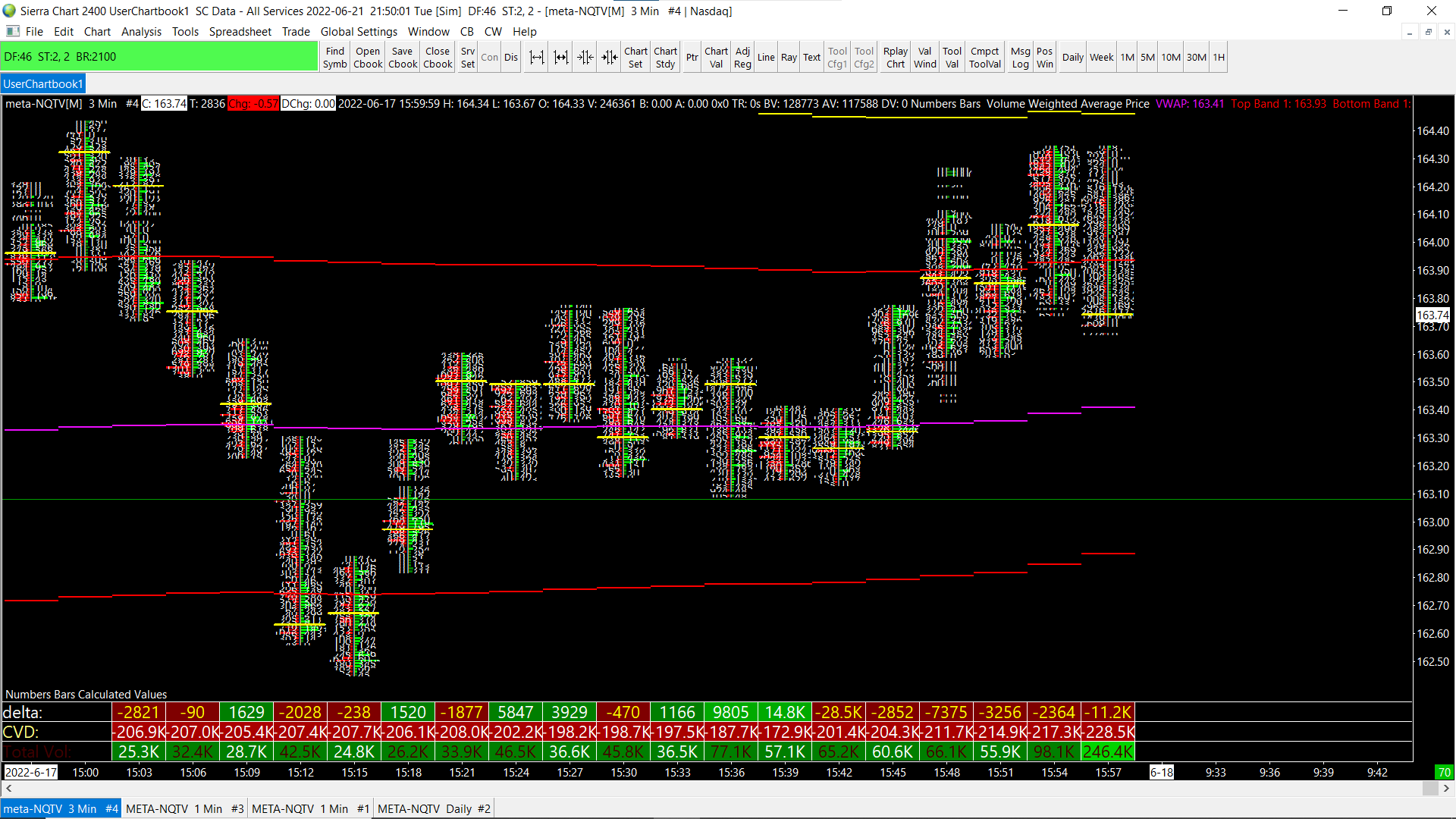

[2022-06-21 14:02:27]
Oh no, need to ask for help again , today I can't see any update on both 3m and Daly chart, even the market opened...
imageDaily.png / V - Attached On 2022-06-21 13:57:30 UTC - Size: 67.71 KB - 276 views
image3m.png / V - Attached On 2022-06-21 13:57:37 UTC - Size: 190.29 KB - 273 views
[2022-06-21 14:49:21]
Change your Session Times so they cover the full 24 hour day. That ensure that the session times are not an issue. Refer to the following:
Chart Session Times
[2022-06-21 15:29:31]
Okay , after 15min, suddenly work, should be really ok this time!!
