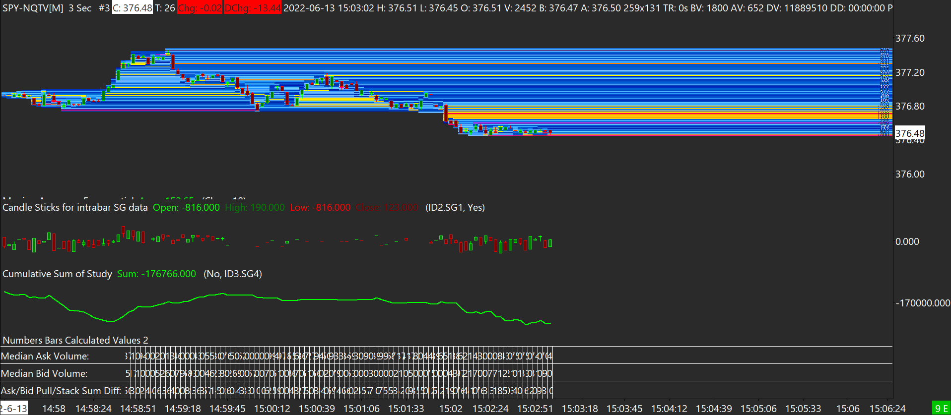

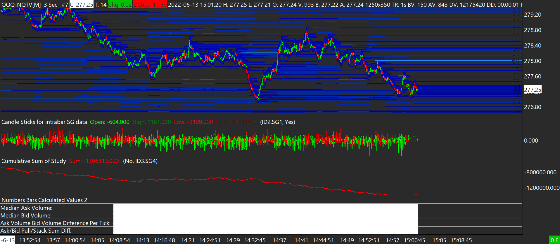

Thanks John, I do have that. So Spy I have SPY-NQTV loaded and only 1 level comes up. QQQ-NQTV I have full depth. I have 1000 level of depth for both.
QQQ looks good: https://www.sierrachart.com/image.php?Image=1655146886135.png
SPY https://www.sierrachart.com/image.php?Image=1655146983343.png
Thanks,
[2022-06-13 19:10:54]
Ben A - Posts: 123
OK, I stopped the feed and then restarted and SPY came online but not AAPL. I repeated that process a few more times and then AAPL kicked in. Strange. Hopefully its just an issue with initial start-up with the service.
