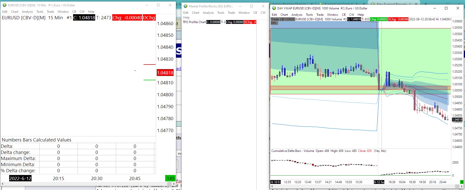

I switched from package 3 to 10 and now I have blank TPO chart and blank footprint chart

I was getting delayed data on FXCM forex symbols, approx. 1-2 minutes. I thought upgrading to Denali feed might make things better. However, Now I have blank Market Profile (Bars by Numbers) and blank Footprint Chart. The VWAP chart is still working fine.
I have sierra chart installed on 2 PCs and both are having the same problem. I tried symbol rollover, Edit, delete and re-downloaded all data, however, the problem is still there. Can Anyone Help please !!!
imageSeirra chart problems.jpg / V - Attached On 2022-06-13 00:58:13 UTC - Size: 267.9 KB - 220 views

It will not help to be on Service Package 10 or higher. We see you are now on Service Package 5 which includes TPO and Numbers Bars charts.
So you should be all set now. If not, restart Sierra Chart.
