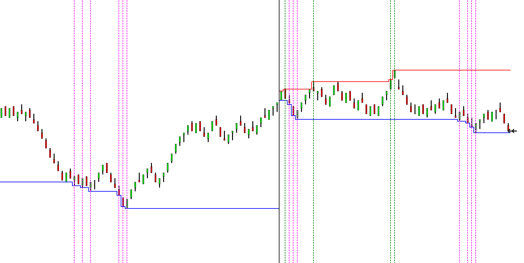

If I used the Daily OHLC study what would be the Alert condition to have a vertical line drawn at a new daily high/low?
Or, is there is another way to have a vertical line drawn at a new daily high/low?
As per the attached screen shot
Kind Regards,
imageVertical line.png / V - Attached On 2022-06-12 01:15:45 UTC - Size: 47.17 KB - 449 views
[2022-06-12 08:46:32]
User431178 - Posts: 910
Here is an example of one way you can do this.
attachmentVerticalLineHighLow.Cht - Attached On 2022-06-12 08:46:01 UTC - Size: 3.77 KB - 556 views
[2022-06-12 16:09:04]
Dan the Man - Posts: 111
Thanks User431178 !
You pointed me in the right direction.
When I try to duplicate your setting on my chart the "Color Bar Based on Alert Condition", for some reason, I'm not getting the same results.
I had to use the "Color Background Based on Alert Condition" but still struggling.
Besides plotting Daily High/Low on the ES, I would also like to plot a Daily High/Low on on the TICK in chart range 2
If I could encroach on you would you be able to look at this.
I attached your cht file with a copy of my chart next to yours.
Is there a way to remove the previous (old) Daily High/Low as the day develops?
Kind Regards,
attachmentVerticalLineHighLow.Cht - Attached On 2022-06-12 16:07:18 UTC - Size: 9.47 KB - 522 views
[2022-06-13 11:16:06]
I added another copy of your chart and changed some settings so you can compare.
attachmentVerticalLineHighLow.Cht - Attached On 2022-06-13 11:15:59 UTC - Size: 14.14 KB - 480 views
[2022-06-13 11:32:50]
Also have a look at this study:
Daily OHLC - Single Point
[2022-06-13 16:56:12]
Thank-you User431178 and Sierra !
Working with the settings
Kind Regards,

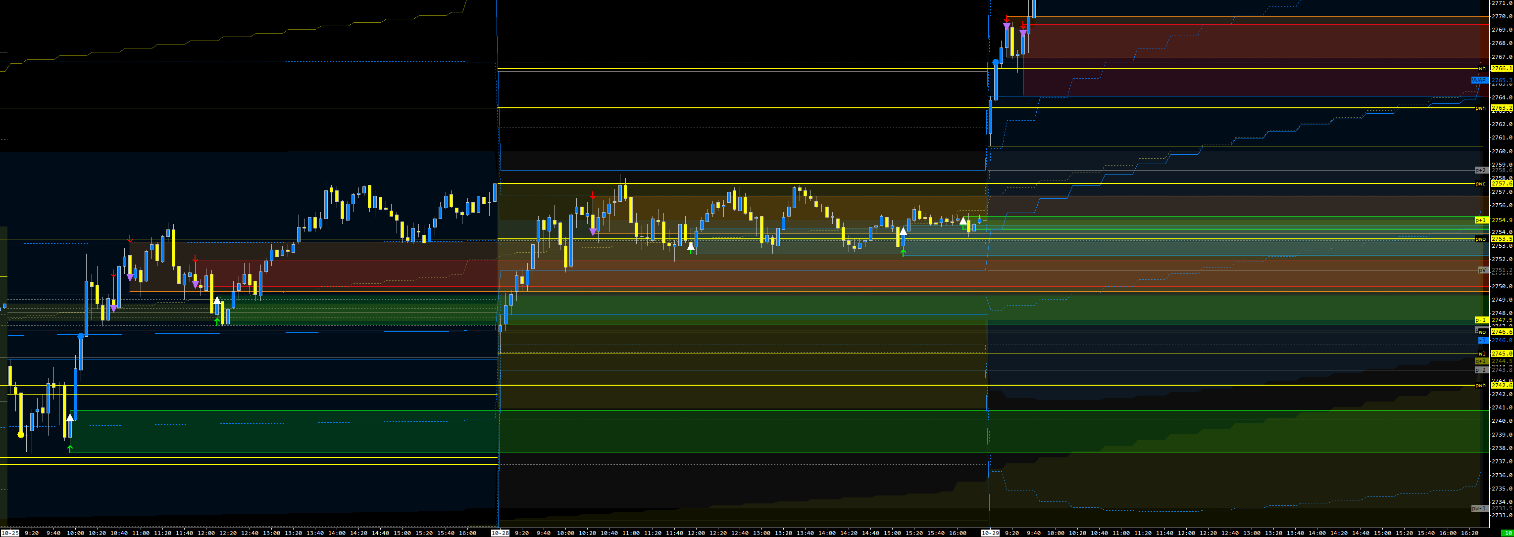

Hey all, is it possible to display the OHLC based on candles where an alert condition is true?
[2024-10-30 15:49:46]
We are not understanding what exactly you are wanting to do. Please give us more specific information.
[2024-10-30 16:00:52]
User357489 - Posts: 72
for example, when
=AND(ID23.SG1[0] > ID23.SG1[-1], ID23.SG41[0]<ID23.SG41[-1],L[0]<L[-1],ID23.SG10<0,OR(AND(ID23.SG1[0]>ID23.SG1[-1],ID23.SG10[0]>ID23.SG10[-1]),AND(ID23.SG12[0]>ID23.SG12[-1],ID23.SG13[0]>ID23.SG13[-1])))
is true, a white triangle is displayed.
Likewise when,
=AND(ID23.SG1[0] < ID23.SG1[-1],ID23.SG41[0] > ID23.SG41[-1],H[0] > H[-1],ID23.SG10 >0,OR(AND(ID23.SG1[0<ID23.SG1[-1],ID23.SG10[0<ID23.SG10[-1]),AND(ID23.SG12[0]>ID23.SG12[-1],ID23.SG13[0]>ID23.SG13[-1])))
is true a purple triangle is displayed, as per the CBBOAC.
When either of these alert conditions are met, i want the study to auto draw an extending rectangle drawstyle around the range of the candle in which the alert conditions are true.
Please see attached a manually drawn example, note where i colored the areas green this is "active" or the most recent instance of my alert condition, i want this to turn "blue" when new alert conditions are met, ie instead of resetting the drawing, turn diff color to indicate the area being "older", likewise for red being active and orange older.
imageScreenshot 2024-10-30 091347.png / V - Attached On 2024-10-30 16:00:43 UTC - Size: 81.46 KB - 235 views
[2024-10-30 16:17:34]
There is no support for what you are wanting to do. The only way to do this would be to create a custom study. Refer to the following:
Using Drawing Tools From an Advanced Custom Study
https://www.sierrachart.com/index.php?page=doc/SierraChartStudyAndSystemProgrammers.php
