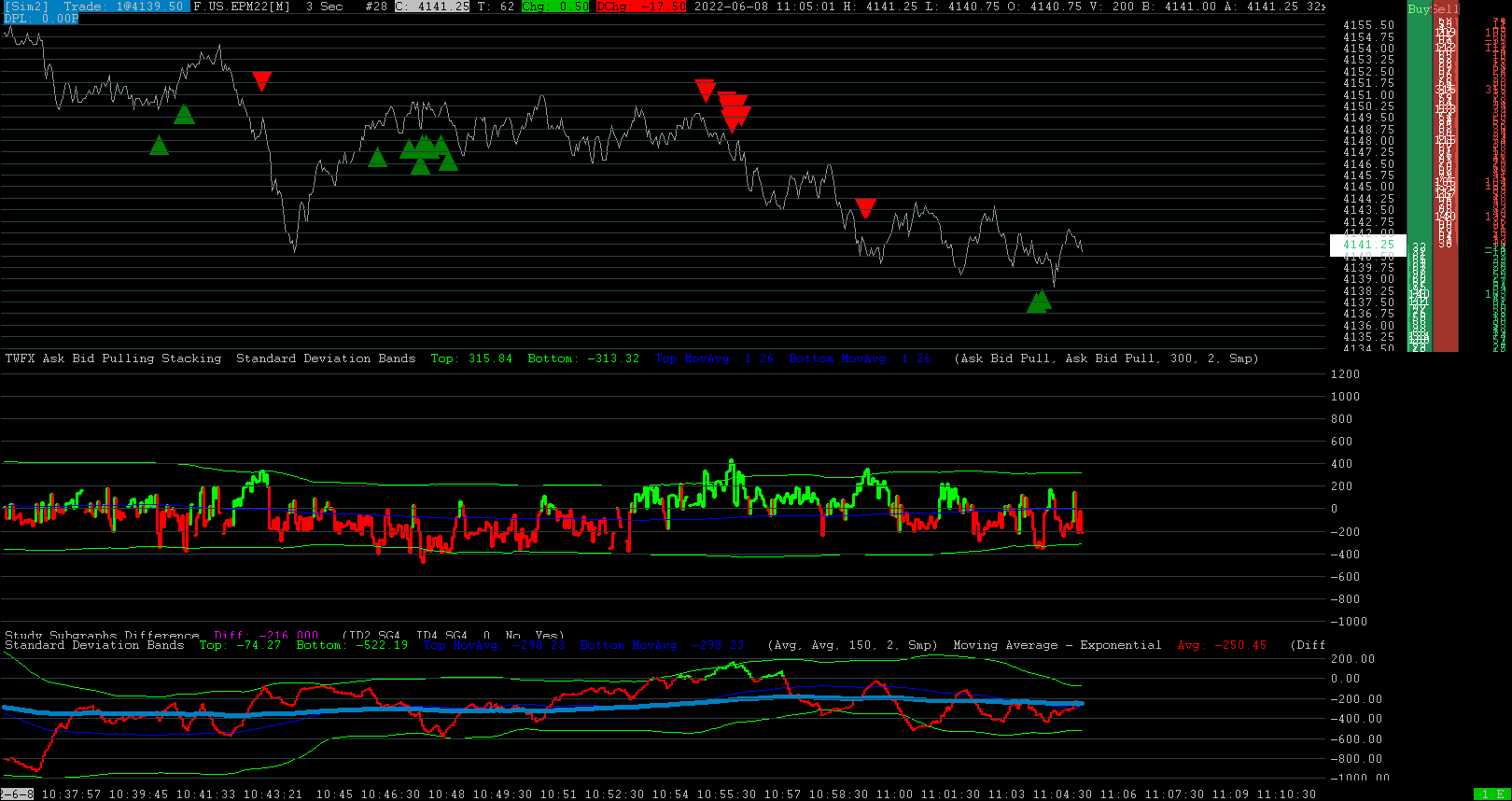

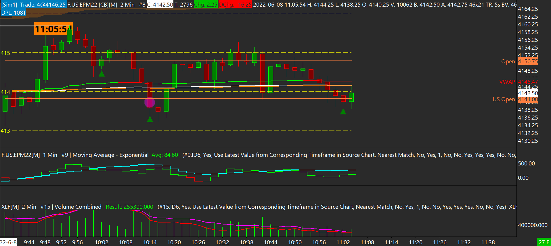

| [2022-06-08 15:07:28] |
| Ben A - Posts: 123 |
Many thanks for looking into it. Here you will see the 3 second chart and the 2 minute chart. You see some of the green arrows print but not the red ones in this instance. Actually I see them flash up on the 2 minute chart for a split second but they disappear. https://www.sierrachart.com/image.php?Image=1654700702598.png https://www.sierrachart.com/image.php?Image=1654700755876.png Many thanks, |
