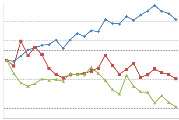

Is it possible to set up a chart (ideally with overlays) where the charts all start at ZERO - and move from a single point based on percent change? Basically, if I wanted to see ES, NQ, YM, and TF on 1 chart, relative to each other - based on % change up or down from a given point. See the image attached, the key point is everything starting in the same spot.
image1234.png / V - Attached On 2014-05-01 19:13:28 UTC - Size: 27.22 KB - 953 views

This can be done by using this study:
Percent Change Since Open
You can then overlay all of these on the same chart by using the Study/Price Overlay study.
