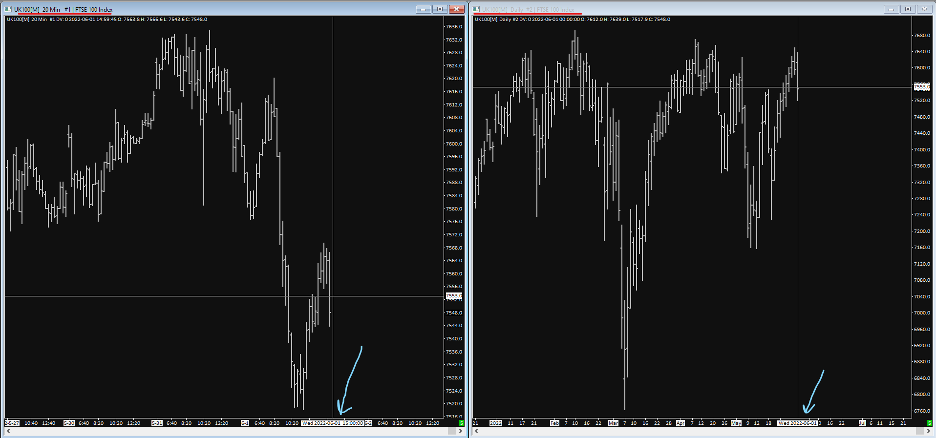

[2022-06-02 11:53:32]
User431178 - Posts: 909
Did you try delete and download data?
I have both historical and intraday data up to yesterday close.

DTC Client socket (1) | Connect event error. Windows error code 10060: A connection attempt failed because the connected party did not properly respond after a period of time, or established connection failed because connected host has failed to respond. | 2022-06-02 15:28:06.242 *
DTC Client socket (1) | CloseSocket call. | 2022-06-02 15:28:06.245
DTC Client socket (1) | Closed. | 2022-06-02 15:28:06.245
DTC Client socket (0) | CloseSocket call. | 2022-06-02 15:28:06.245
SC DTC Delayed Exchange Data | Disconnected from the server. | 2022-06-02 15:28:06.245
SC DTC Delayed Exchange Data | Data feed disconnected. Will reconnect in 2 seconds. | 2022-06-02 15:28:06.245
SC DTC Delayed Exchange Data | Connecting to the server ds14.sierracharts.com. Port 10043 | 2022-06-02 15:28:08.257
DTC Client socket (1) | Creating socket. | 2022-06-02 15:28:08.257
DTC Client socket (1) | New receive buffer size: 5242880 | 2022-06-02 15:28:08.257
DTC Client socket (1) | Connecting to IP: 157.90.1.40. | 2022-06-02 15:28:08.257
Socket (2) | Connect event error. Windows error code 10060: A connection attempt failed because the connected party did not properly respond after a period of time, or established connection failed because connected host has failed to respond. | 2022-06-02 15:28:19.539 *
DTC Client socket (1) | Connect event error. Windows error code 10060: A connection attempt failed because the connected party did not properly respond after a period of time, or established connection failed because connected host has failed to respond. | 2022-06-02 15:28:22.278 *
DTC Client socket (1) | CloseSocket call. | 2022-06-02 15:28:22.278
DTC Client socket (1) | Closed. | 2022-06-02 15:28:22.278
DTC Client socket (0) | CloseSocket call. | 2022-06-02 15:28:22.278
SC DTC Delayed Exchange Data | Disconnected from the server. | 2022-06-02 15:28:22.278
SC DTC Delayed Exchange Data | Data feed disconnected. Will reconnect in 2 seconds. | 2022-06-02 15:28:22.279
SC DTC Delayed Exchange Data | Connecting to the server ds24.sierracharts.com. Port 10043 | 2022-06-02 15:28:24.279
DTC Client socket (1) | Creating socket. | 2022-06-02 15:28:24.279
DTC Client socket (1) | New receive buffer size: 5242880 | 2022-06-02 15:28:24.279
DTC Client socket (1) | Connecting to IP: 154.14.194.212. | 2022-06-02 15:28:24.279
Socket (2) | CloseSocket call. | 2022-06-02 15:28:25.504
Socket (2) | Closed. | 2022-06-02 15:28:25.504
HD Request # 182 | Error downloading historical Intraday data for UK100. Timeout error connecting to server. | 2022-06-02 15:28:25.505
Historical data download thread signaled to stop. | 2022-06-02 15:28:25.505
HD Request # 182 | Received 0 Intraday data records from 00:00:00.000000 to 00:00:00.000000 (0.0 seconds) and wrote 0 records for UK100 | 2022-06-02 15:28:25.505
File compression not supported on file system. L:\SierraChart\Data\UK100.scid. Windows error code 1: Incorrect function. | 2022-06-02 15:28:25.505
HD Request # 182 | Add time&sales data | Remembered last file record date-time: 00:00:00.000000 | 2022-06-02 15:28:25.505
HD Request # 182 | Completion time: 20s | 2022-06-02 15:28:25.505
HD Request # 182 | Intraday data download complete for UK100. Unique request ID: 158 | 2022-06-02 15:28:25.505
Removing historical data download ID 158. | 2022-06-02 15:28:25.505
Real-time Intraday chart data file updates started for UK100 | 2022-06-02 15:28:25.505
Opened cached Intraday file: L:\SierraChart\Data\UK100.scid. Thread ID: 2188 | 2022-06-02 15:28:25.505
Intraday chart data file opened for UK100 | 2022-06-02 15:28:25.505
HD Request # 182 | Enabling Intraday chart updating for symbol. | 2022-06-02 15:28:25.505
Triggering next historical data download in queue. | 2022-06-02 15:28:25.505
No download requests in the queue to start downloads for. | 2022-06-02 15:28:25.505
DTC Client socket (1) | Connect event error. Windows error code 10060: A connection attempt failed because the connected party did not properly respond after a period of time, or established connection failed because connected host has failed to respond. | 2022-06-02 15:28:38.295 *
DTC Client socket (1) | CloseSocket call. | 2022-06-02 15:28:38.296
DTC Client socket (1) | Closed. | 2022-06-02 15:28:38.296
DTC Client socket (0) | CloseSocket call. | 2022-06-02 15:28:38.296
SC DTC Delayed Exchange Data | Disconnected from the server. | 2022-06-02 15:28:38.296
SC DTC Delayed Exchange Data | Data feed disconnected. Will reconnect in 2 seconds. | 2022-06-02 15:28:38.296
SC DTC Delayed Exchange Data | Connecting to the server ds14.sierracharts.com. Port 10043 | 2022-06-02 15:28:40.305
DTC Client socket (1) | Creating socket. | 2022-06-02 15:28:40.305
DTC Client socket (1) | New receive buffer size: 5242880 | 2022-06-02 15:28:40.305
DTC Client socket (1) | Connecting to IP: 157.90.1.40. | 2022-06-02 15:28:40.305
[2022-06-03 10:13:13]
User21339 - Posts: 61
i reinstalled a new copy of SC on my t7 drive, copied all my folders and all data is coming in now. UK100 data working all fine.
sorry i couldnt wait on your reply and figured like windows problems i cant solve - a reinstall often is the best use of time. perhaps you can glean as to why the problem occured reading the log file that may help someone else
Date Time Of Last Edit: 2022-06-03 10:13:55
[2022-06-03 10:46:23]
This is the problem:
Refer to:
Historical Intraday Data (Missing Data / Download Errors / Viewing More Data): Error when Downloading Historical Intraday Data from the Sierra Chart Historical Data Server
This would most likely be caused by a firewall on your computer. Not the Windows firewall though.
Date Time Of Last Edit: 2022-06-03 10:46:38
[2022-06-03 11:04:39]
Everything updates though. it was just uk100. i take it fxcm pulls that data via a different route. This doesnt make sense. Why only uk100.
I do run a software VPN - have done for 15 years and never had this problem. if it happens again i will try the suggestion you gave.
Thanks.
[2022-06-03 13:10:42]
We can only answer that there was a connectivity problem to the historical data server. That is very clear from the Log.
