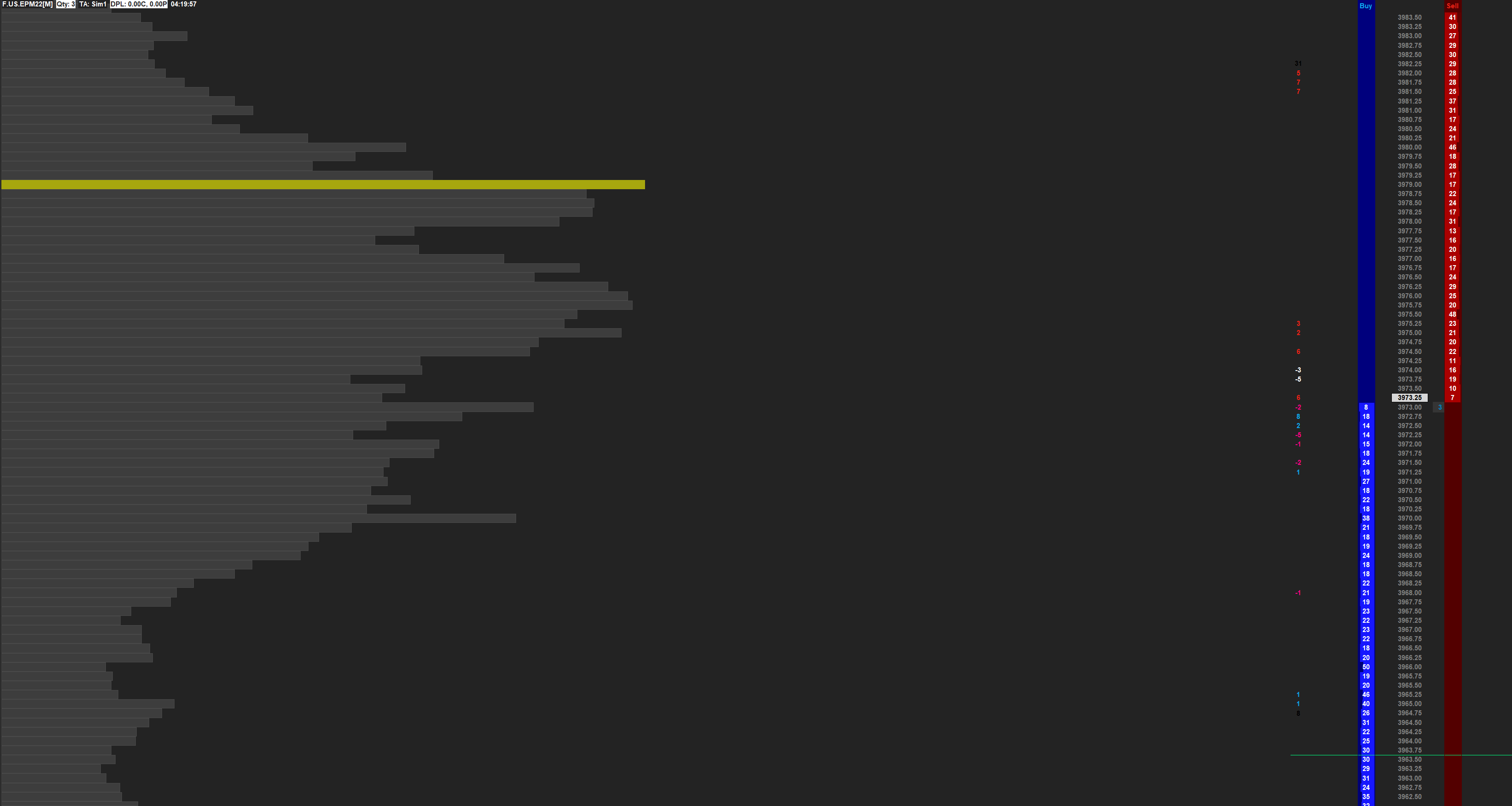

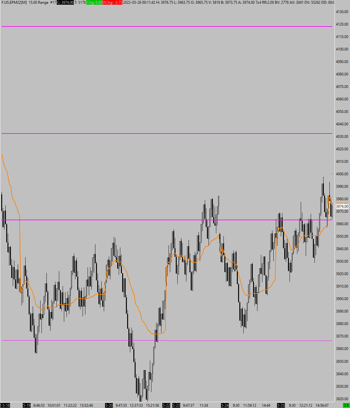

Hello, I need help please setting up my Sierra chart, two main problems I m experiencing. 1. Numbers seems to be "Zoomed out" increasing the font size did not help. 2. When I click buy or sell I m not getting any response, even though my broker account is active. I feel I m doing something wrong in the settings and can't figure it out. Your help is much appreciate it. Thank you, |
| [2022-05-25 16:58:17] |
| John - SC Support - Posts: 48610 |
1. Please get us a screenshot so we can see what the particular issue is related to and what font you would have to change. Refer to the following for how to get and attach a screenshot: Support Board Posting Information: Attaching or Posting a Screenshot/Image (Optional) 2. Check to ensure that Trade Simulation Mode On is not enabled. Refer to the following: Overview of Trading: Difference between Simulated and Non-Simulated Trading Modes For the most reliable, advanced, and zero cost futures order routing, use the Teton service: Sierra Chart Teton Futures Order Routing |
| [2022-05-26 04:24:31] |
| Aloutfi11 - Posts: 25 |
Hello, Please find below the images as per your request https://www.sierrachart.com/image.php?Image=16535383111.png https://www.sierrachart.com/image.php?Image=1653538819939.png Also my Sim was on and was not taking it. I disabled SIM and this is what it told me. Please help. TradeActivity files query time: 0.001366 seconds. Entries: 0. Current queries: 2 | 2022-05-26 04:01:59.419 TradeActivity files query time: 0.000637 seconds. Entries: 188. Current queries: 2 | 2022-05-26 04:01:59.419 TradeActivity files query time: 0.000618 seconds. Entries: 0. Current queries: 1 | 2022-05-26 04:02:04.711 TradeActivity files query time: 0.000847 seconds. Entries: 0. Current queries: 1 | 2022-05-26 04:02:51.623 TradeActivity files query time: 0.000736 seconds. Entries: 0. Current queries: 2 | 2022-05-26 04:02:51.624 TradeActivity files query time: 0.000722 seconds. Entries: 0. Current queries: 3 | 2022-05-26 04:02:51.625 TradeActivity files query time: 0.000720 seconds. Entries: 0. Current queries: 4 | 2022-05-26 04:02:51.626 TradeActivity files query time: 0.000812 seconds. Entries: 0. Current queries: 5 | 2022-05-26 04:02:51.629 TradeActivity files query time: 0.000674 seconds. Entries: 0. Current queries: 6 | 2022-05-26 04:02:51.641 TradeActivity files query time: 0.000591 seconds. Entries: 0. Current queries: 7 | 2022-05-26 04:02:51.658 TradeActivity files query time: 0.000857 seconds. Entries: 0. Current queries: 8 | 2022-05-26 04:02:51.681 TradeActivity files query time: 0.000967 seconds. Entries: 0. Current queries: 9 | 2022-05-26 04:02:51.706 TradeActivity files query time: 0.000832 seconds. Entries: 0. Current queries: 1 | 2022-05-26 04:02:51.838 TradeActivity files query time: 0.000777 seconds. Entries: 0. Current queries: 1 | 2022-05-26 04:02:52.095 TradeActivity files query time: 0.000907 seconds. Entries: 0. Current queries: 1 | 2022-05-26 04:02:52.129 TradeActivity files query time: 0.000782 seconds. Entries: 0. Current queries: 2 | 2022-05-26 04:02:52.186 TradeActivity files query time: 0.000925 seconds. Entries: 0. Current queries: 1 | 2022-05-26 04:02:52.467 TradeActivity files query time: 0.000455 seconds. Entries: 0. Current queries: 1 | 2022-05-26 04:02:52.838 TradeActivity files query time: 0.000773 seconds. Entries: 0. Current queries: 1 | 2022-05-26 04:02:52.893 TradeActivity files query time: 0.000467 seconds. Entries: 0. Current queries: 1 | 2022-05-26 04:02:52.983 TradeActivity files query time: 0.000507 seconds. Entries: 0. Current queries: 2 | 2022-05-26 04:02:52.991 TradeActivity files query time: 0.000501 seconds. Entries: 0. Current queries: 1 | 2022-05-26 04:02:53.144 TradeActivity files query time: 0.000660 seconds. Entries: 0. Current queries: 1 | 2022-05-26 04:02:53.464 TradeActivity files query time: 0.000593 seconds. Entries: 0. Current queries: 2 | 2022-05-26 04:02:53.479 TradeActivity files query time: 0.000559 seconds. Entries: 0. Current queries: 1 | 2022-05-26 04:02:53.907 TradeActivity files query time: 0.000674 seconds. Entries: 0. Current queries: 2 | 2022-05-26 04:02:54.193 TradeActivity files query time: 0.000474 seconds. Entries: 0. Current queries: 1 | 2022-05-26 04:02:56.477 TradeActivity files query time: 0.000526 seconds. Entries: 0. Current queries: 1 | 2022-05-26 04:02:56.573 TradeActivity files query time: 0.000574 seconds. Entries: 0. Current queries: 1 | 2022-05-26 04:02:56.871 TradeActivity files query time: 0.000987 seconds. Entries: 0. Current queries: 1 | 2022-05-26 04:15:33.866 TradeActivity files query time: 0.000495 seconds. Entries: 0. Current queries: 1 | 2022-05-26 04:18:56.377 TradeActivity files query time: 0.000687 seconds. Entries: 0. Current queries: 1 | 2022-05-26 04:19:04.502 TradeActivity files query time: 0.000570 seconds. Entries: 0. Current queries: 1 | 2022-05-26 04:19:05.523 TradeActivity files query time: 0.000527 seconds. Entries: 0. Current queries: 1 | 2022-05-26 04:19:19.987 TradeActivity files query time: 0.004304 seconds. Entries: 0. Current queries: 1 | 2022-05-26 04:22:13.788 TradeActivity files query time: 0.000362 seconds. Entries: 0. Current queries: 1 | 2022-05-26 04:22:13.814 TradeActivity files query time: 0.000338 seconds. Entries: 0. Current queries: 2 | 2022-05-26 04:22:13.815 TradeActivity files query time: 0.000254 seconds. Entries: 0. Current queries: 1 | 2022-05-26 04:22:13.816 TradeActivity files query time: 0.000311 seconds. Entries: 0. Current queries: 2 | 2022-05-26 04:22:13.817 TradeActivity files query time: 0.000240 seconds. Entries: 0. Current queries: 2 | 2022-05-26 04:22:13.817 TradeActivity files query time: 0.000308 seconds. Entries: 0. Current queries: 2 | 2022-05-26 04:22:13.820 TradeActivity files query time: 0.000243 seconds. Entries: 0. Current queries: 1 | 2022-05-26 04:22:13.820 TradeActivity files query time: 0.000348 seconds. Entries: 0. Current queries: 1 | 2022-05-26 04:22:13.890 TradeActivity files query time: 0.000628 seconds. Entries: 0. Current queries: 1 | 2022-05-26 04:22:13.910 TradeActivity files query time: 0.000345 seconds. Entries: 0. Current queries: 2 | 2022-05-26 04:22:13.919 TradeActivity files query time: 0.000252 seconds. Entries: 0. Current queries: 2 | 2022-05-26 04:22:13.919 TradeActivity files query time: 0.000356 seconds. Entries: 0. Current queries: 1 | 2022-05-26 04:22:14.383 TradeActivity files query time: 0.000388 seconds. Entries: 0. Current queries: 1 | 2022-05-26 04:22:14.396 TradeActivity files query time: 0.000374 seconds. Entries: 0. Current queries: 2 | 2022-05-26 04:22:14.449 TradeActivity files query time: 0.000291 seconds. Entries: 0. Current queries: 2 | 2022-05-26 04:22:14.449 TradeActivity files query time: 0.000392 seconds. Entries: 0. Current queries: 2 | 2022-05-26 04:22:14.505 TradeActivity files query time: 0.000337 seconds. Entries: 0. Current queries: 2 | 2022-05-26 04:22:14.505 TradeActivity files query time: 0.000352 seconds. Entries: 0. Current queries: 1 | 2022-05-26 04:22:14.788 TradeActivity files query time: 0.000392 seconds. Entries: 0. Current queries: 1 | 2022-05-26 04:22:15.004 Trade Order Error - CQG order update. Status: REJECTED. Text: Price must be greater than zero 'Order for id: ESM2 has non-positive price 0.0' ExchangeRejectCode = 1012. Internal Order ID: 250. Service Order ID: 1189360207. Symbol: F.US.EPM22. Account: 120296 | 2022-05-26 04:22:17.644 * Trade Order Error - CQG order update. Status: REJECTED. Text: Price must be greater than zero 'Order for id: ESM2 has non-positive price 0.0' ExchangeRejectCode = 1012. Internal Order ID: 253. Service Order ID: 1189272062. Symbol: F.US.EPM22. Account: 120296 | 2022-05-26 04:22:17.657 * Trade Order Error - CQG order update. Status: REJECTED. Text: Price must be greater than zero 'Order for id: ESM2 has non-positive price 0.0' ExchangeRejectCode = 1012. Internal Order ID: 256. Service Order ID: 1189360208. Symbol: F.US.EPM22. Account: 120296 | 2022-05-26 04:22:17.697 * Trade Order Error - The order quantity for the Parent is 1 and this is less than the total order quantity of 3 for the Attached Orders. Adjust the order quantities so the parent is greater or equal to the Attached Orders. | 2022-05-26 04:22:47.576 * Trade Order Error - CQG order update. Status: REJECTED. Text: Price must be greater than zero 'Order for id: ESM2 has non-positive price 0.0' ExchangeRejectCode = 1012. Internal Order ID: 259. Service Order ID: 1189159184. Symbol: F.US.EPM22. Account: 120296 | 2022-05-26 04:23:00.991 * Trade Order Error - CQG order update. Status: REJECTED. Text: Price must be greater than zero 'Order for id: ESM2 has non-positive price 0.0' ExchangeRejectCode = 1012. Internal Order ID: 262. Service Order ID: 1189345227. Symbol: F.US.EPM22. Account: 120296 | 2022-05-26 04:23:01.004 * Trade Order Error - CQG order update. Status: REJECTED. Text: Price must be greater than zero 'Order for id: ESM2 has non-positive price 0.0' ExchangeRejectCode = 1012. Internal Order ID: 265. Service Order ID: 1189159185. Symbol: F.US.EPM22. Account: 120296 | 2022-05-26 04:23:01.031 * |
