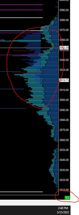

how i can change right side fill space so that my volume studies to not overlap. I am attaching a picture and if I understand correctly I have to change this 1 in the lower right corner to say 5, ok but how?

Thank you for fast ansewr but plz check snapshots i have uploaded here. I want to change that green box to be like file SC1.
SC1 i can scrol chart in left and creating a space on right side but on other 2 (SC2 and SC3 ) i cant.
I think all settings you suggest are corect.

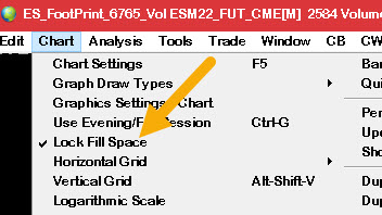

imageSupport question Lock chart 2022-05-25_11-54-17.jpg / V - Attached On 2022-05-25 15:57:55 UTC - Size: 28.63 KB - 390 views
[2022-05-25 16:42:43]
John - SC Support - Posts: 48597
All 3 of your charts have the Lock Fill Space enabled. The 'L' in the bottom right corner indicates this.
If you are not seeing the amount of space that you want on the right side, then you would need to turn off "Lock Fill Space" and adjust the chart to have the amount of fill space on the right that you want, then enable the "Lock Fill Space" option. Refer to the following:
