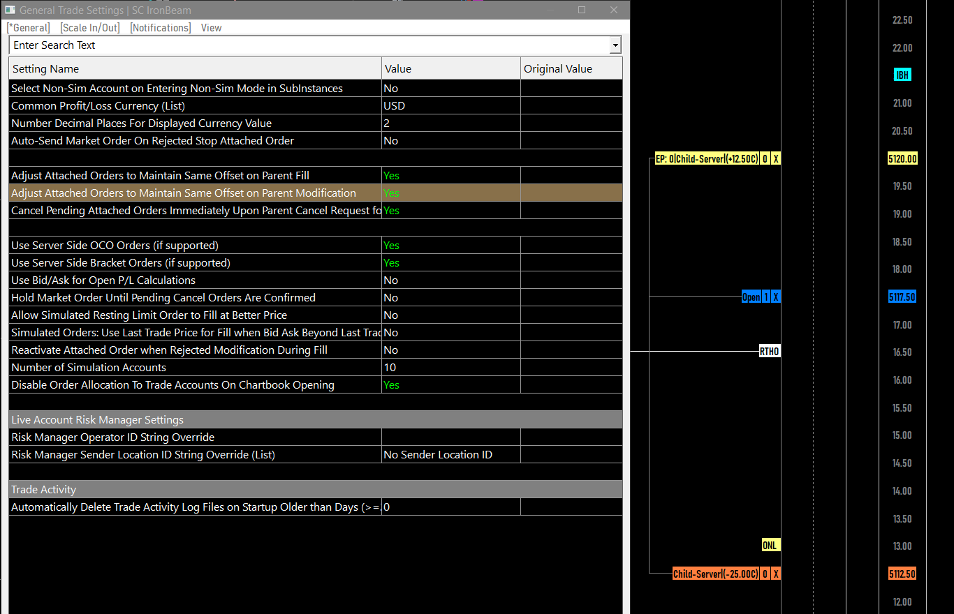

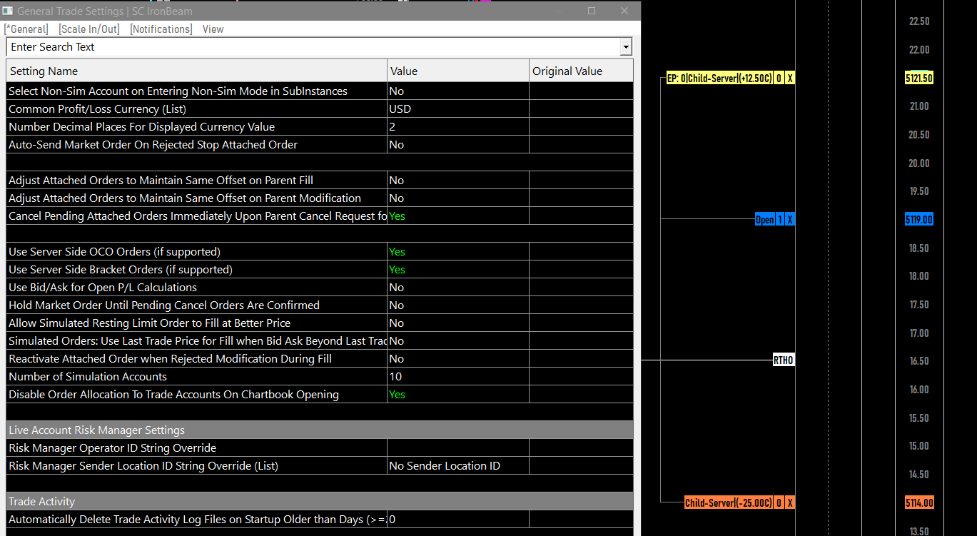

I am having this exact problem as well with version 2609. This is NOT happening in 2604. Identical settings between versions, but in 2609 my brackets are adjusting any time I move the parent order, despite being set not to do so.

[2024-03-05 19:31:03]
j4ytr4der_ - Posts: 947
Sure thing, attached.

[2024-03-05 21:15:40]
Please leave the option for "Adjust Attached Orders to Maintain Same Offset on Parent Modification" as "No". Then put your order on the chart and take an image. Then move the parent and take another image showing that the child orders have moved with the parent.
[2024-03-05 23:21:48]
I can't explain this, but after restarting SC, it now works perfectly as I would expect. Chalk it up to gremlins... ?
