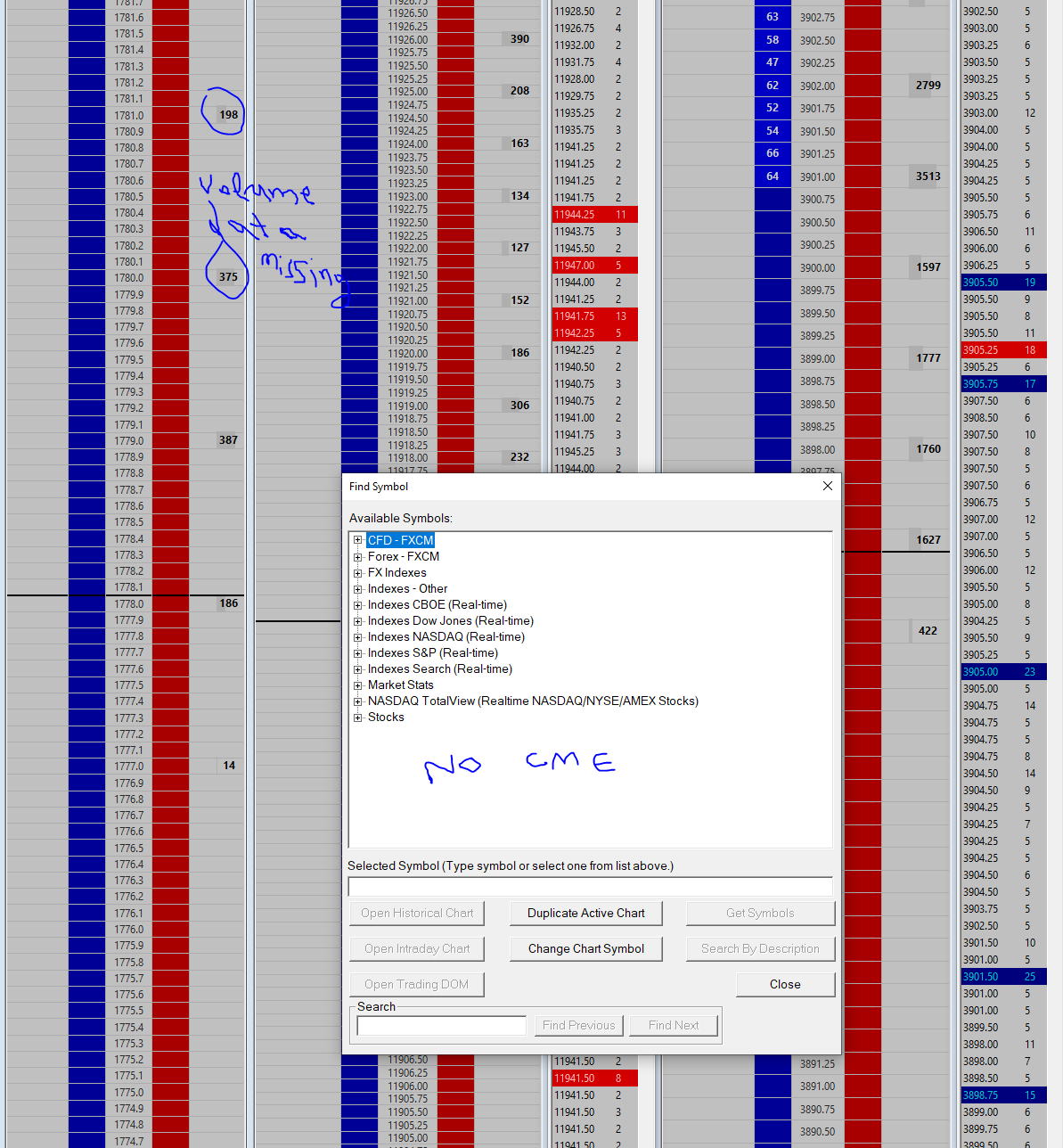

I am using sierra with Rithmic data feed (evaluation account).
The data has been working fine until today where my P/L is not displayed correctly. After hours trying to figure out why, i see that the CME symbols i trade are missing. This is weird since i can still get the feed on the dom albeit with errors (traded volume is not displayed on every price increment).
I tried unticking the "Custom symbol setting values" from Symbol settings and also clicked "update from server" option, disconnected then reconnected to the data. The problem persists. If i go to files then find symbol, i see no + symbol for futures data.
I am trying to attach the some files FYI but i keep getting:
Error: No file was uploaded.
Any suggestions?
imageCapture4.PNG / V - Attached On 2022-05-19 17:47:57 UTC - Size: 165.24 KB - 472 views

Please see the attached file. I have set up rithmic as usual, downloaded the current version and adjusted the symbols.
imageInkedCapture5_LI.jpg / V - Attached On 2022-05-20 13:24:32 UTC - Size: 1.76 MB - 423 views
