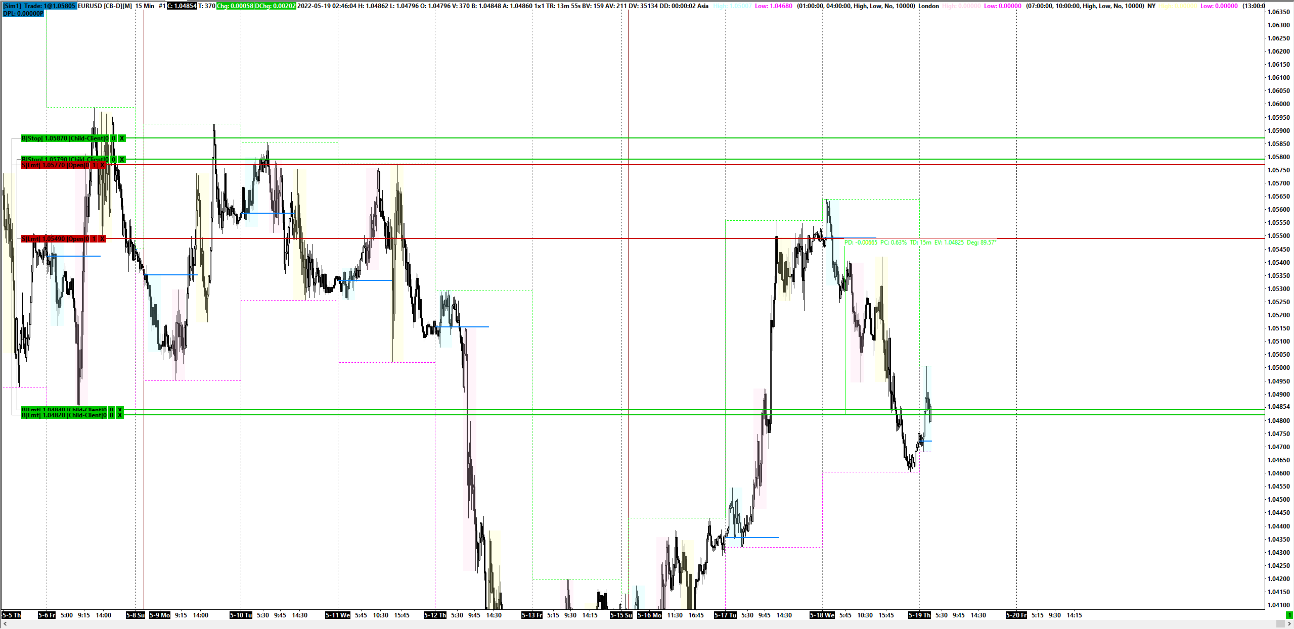

Hi i set 2 Limit orders and they have not being filled i set the limit inside the box on the trade window they stood as pending orders but when price reach the limit order the order was not filled .
I check my trade service log and nothing is mentioned about the pending orders
imageScreenshot_1.png / V - Attached On 2022-05-19 01:57:22 UTC - Size: 150.61 KB - 320 views
[2022-05-19 06:05:53]
Those two buy orders with a quantity of 0, near the current price, are not going to fill because they are not open orders. They are pending child orders, Attached Orders.
