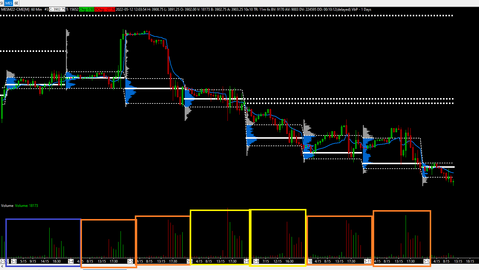

At the bottom of the time unit is displayed different end times, how can I fix this? I think that is not normal, right?
imagekomisch.png / V - Attached On 2022-05-12 10:17:09 UTC - Size: 59.96 KB - 282 views

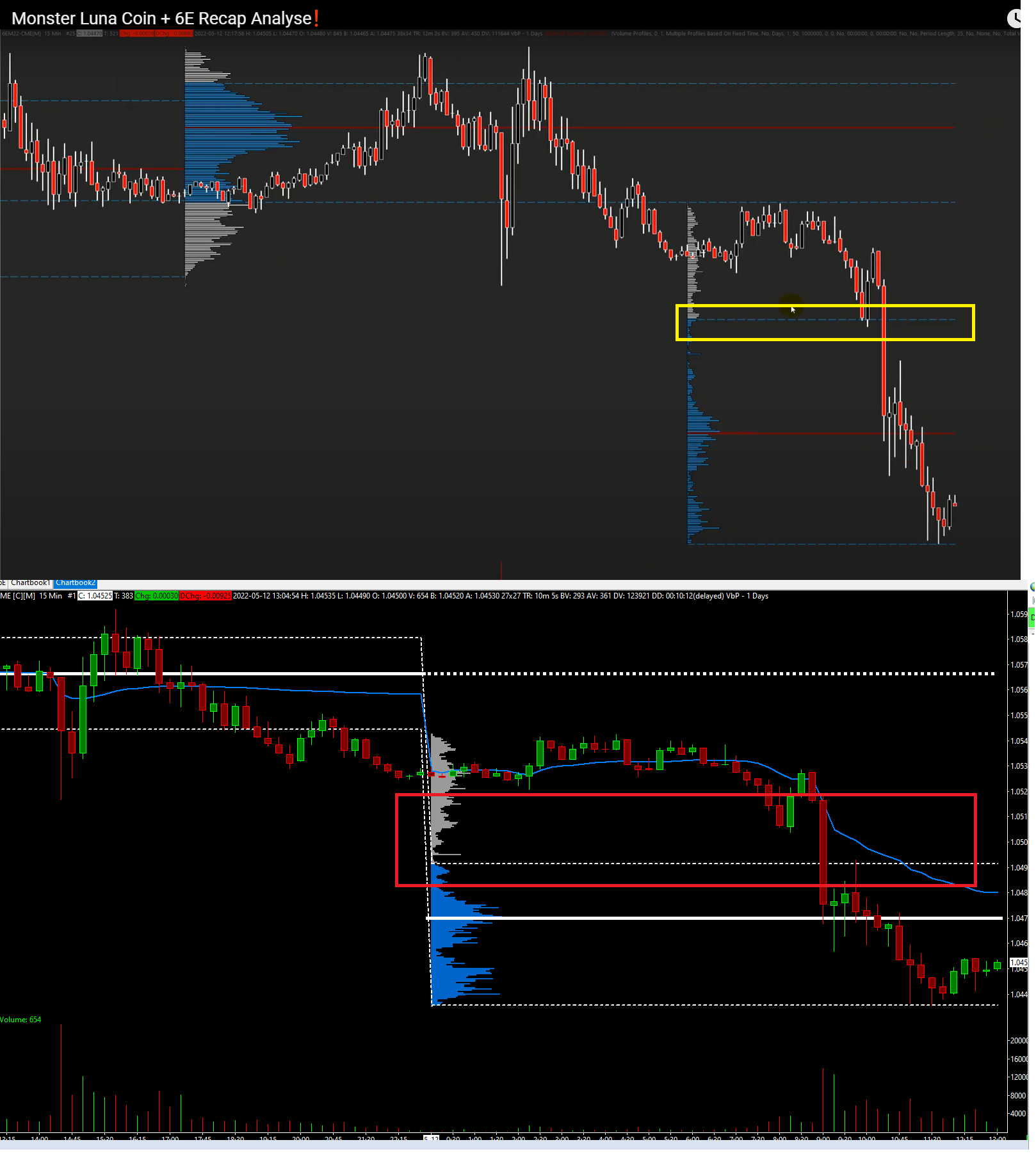

With the second screenshot you see now what I meant exactly, with the guy on Youtube is Value Arena somehow perfect and hits the candle and with me is the somehow below although I have set 68, somehow the whole still does not fit.
Thank you very much
imageKomisch2.png / V - Attached On 2022-05-12 11:20:07 UTC - Size: 410.09 KB - 283 views

With regards to the times that are showing, that can occur. It just depends on what can fit in given the spacing, and sometimes it is not consistent.
With regards to the Value Area lines, we do not understand why you would expect to have the lines match up to the High or Low of a bar. If that occurs, it is just accidental. Refer to how the Volume Value Area Lines are Calculated here:
Time Price Opportunity (TPO) Profile Charts: Volume Value Area
And, if you think they are not correct, then refer to this section:
Time Price Opportunity (TPO) Profile Charts: Incorrect Value Area or Point of Control Values
