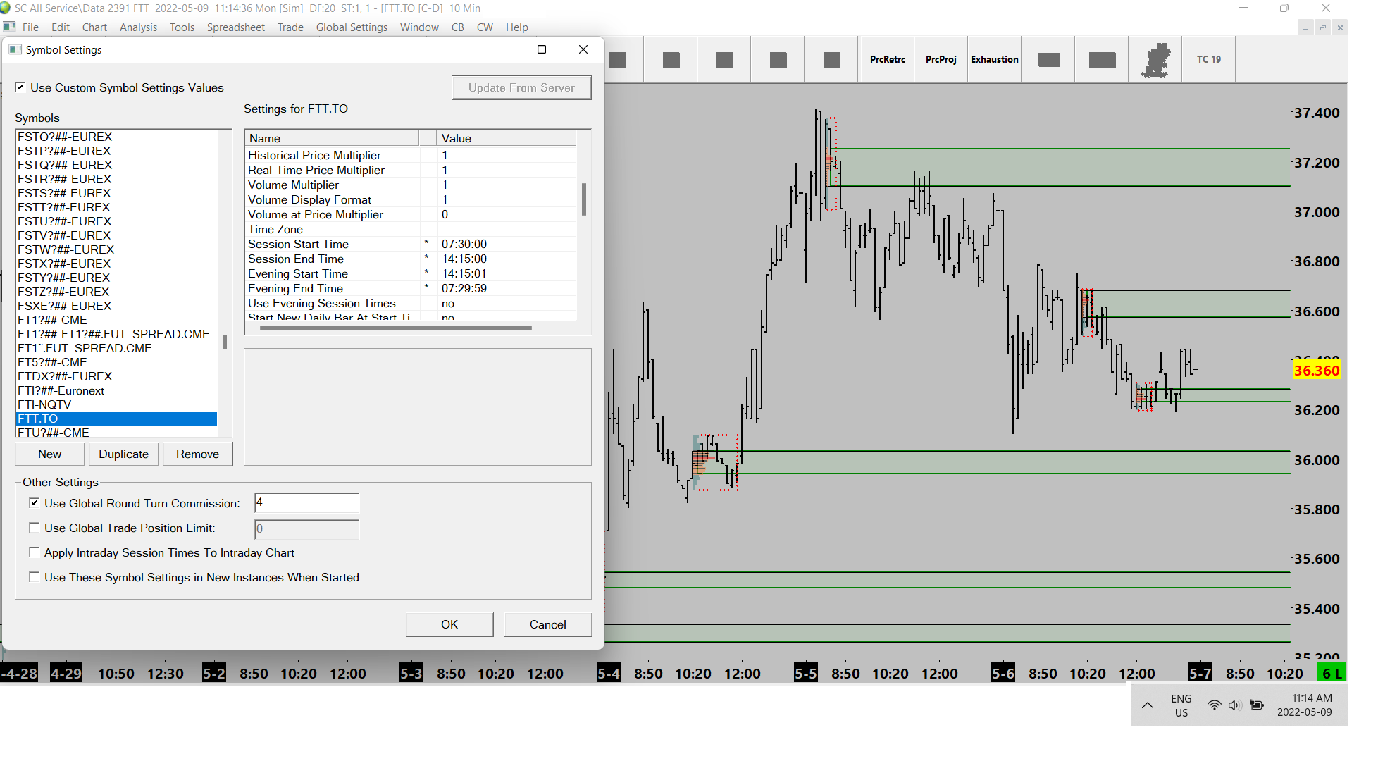

Sierra Chart is connected to "SC Data-All Services.
I have been trying to load a TSX delayed Intraday chart.
On the Intraday chart, there is 1 month of data missing on the chart, even after the Data Feed is disconnected and then connected.
On the Daily Historical chart it is always a day behind, even after the Data Feed is disconnected and then connected.
I've tried looking on the support board but could not find any reference to this.
Kind Regards,
imageSetting.png / V - Attached On 2022-05-06 20:47:39 UTC - Size: 70.41 KB - 266 views
imageChart.png / V - Attached On 2022-05-06 20:47:47 UTC - Size: 89.55 KB - 352 views
[2022-05-07 05:17:58]
This is resolved but there will be a one day delay for data from this exchange.
Re-download all the data in the chart by going to the chart and selecting "Edit >> Delete All Data and Download". You just need to do this once per symbol and not for each chart.
Date Time Of Last Edit: 2022-05-07 05:18:11

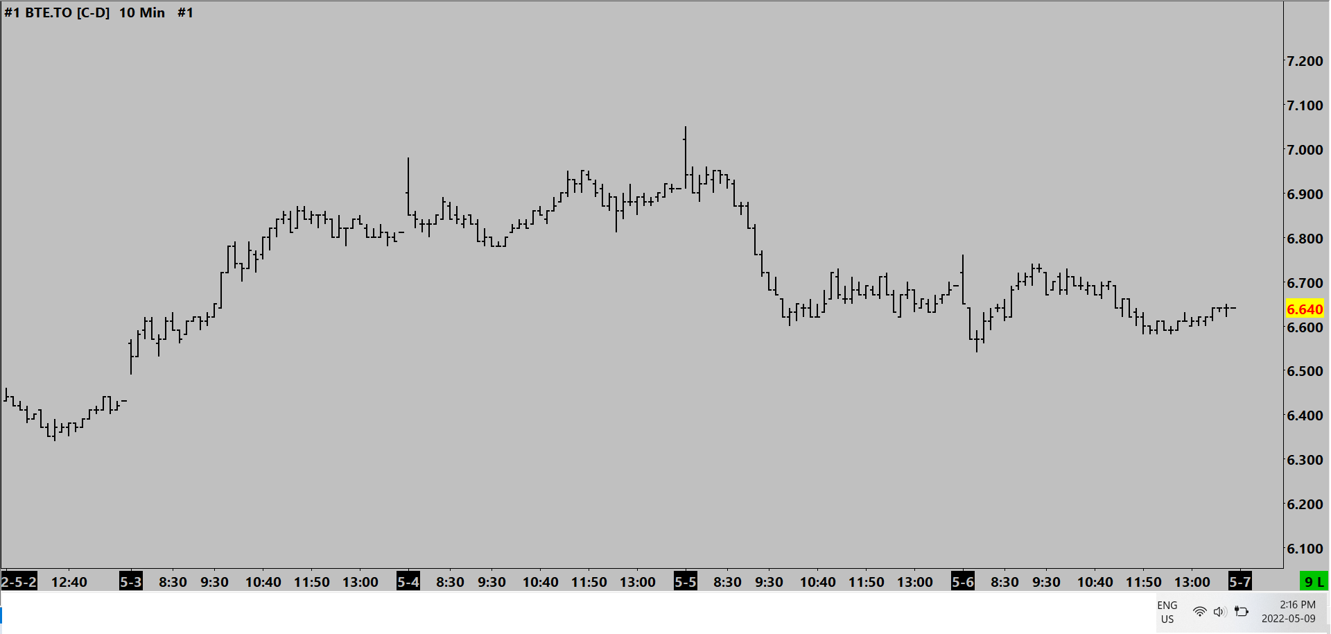

[2022-05-09 17:17:40]
Dan the Man - Posts: 111
I followed the instructions and thought this issue was resolved
I attached a screen shot. Please look at the computer time and the chart
Kind Regards,
Kind Regards,
imageChart.png / V - Attached On 2022-05-09 17:16:58 UTC - Size: 136.01 KB - 245 views

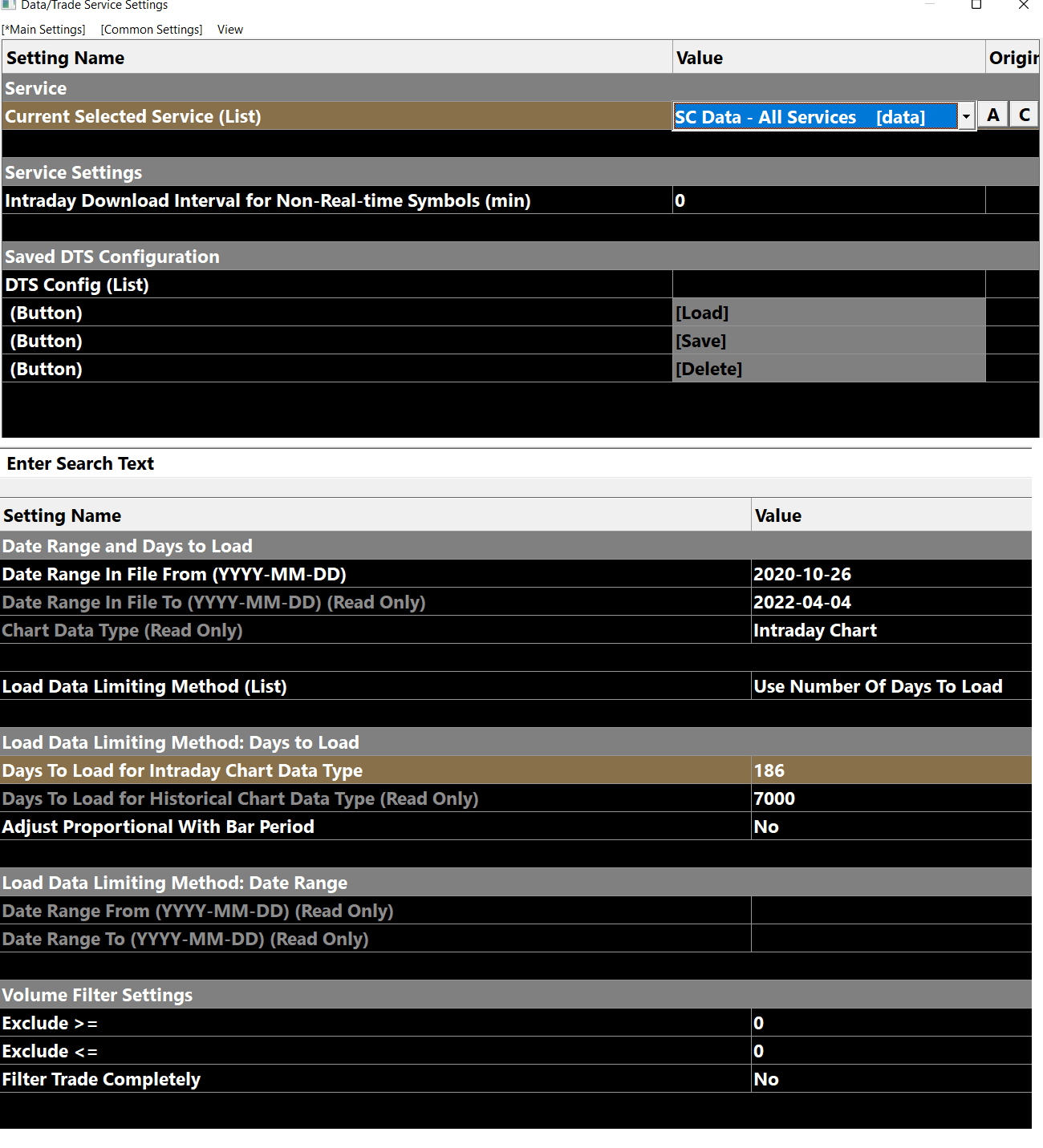

[2022-05-09 19:02:34]
This will definitely be the case:
Provide an image of the chart following these instructions:
[2022-05-09 20:20:38]
As per instructions
https://www.sierrachart.com/image.php?Image=1652127194437.png
I also attached a screen shot that has the computer time on it, just in case.
Kind Regards,
imageChart.png / V - Attached On 2022-05-09 20:19:28 UTC - Size: 49.68 KB - 314 views
[2022-05-10 07:57:49]
This chart is not missing a month of data:
As we said previously:
If there is missing data that we cannot see in the chart, then refer to:
Date Time Of Last Edit: 2022-05-10 07:58:10

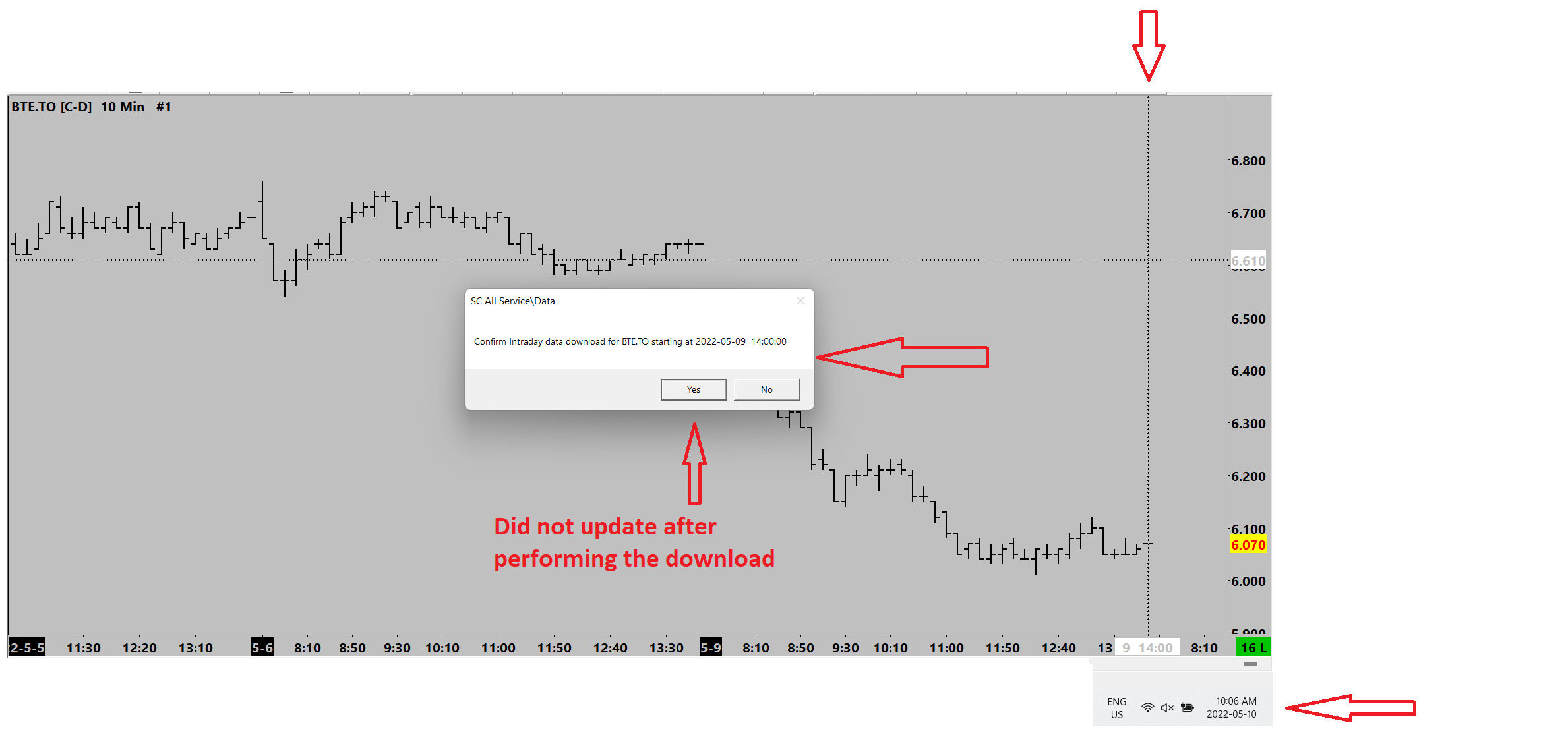

When I mentioned that On the Intraday chart, there is 1 month of data missing on the chart, that was resolved when instructed to go to Symbols. Thanks
Now, what I'm saying, on the delayed 10 minute intraday chart, it will not update with delayed data during the day even when "Delete and Download Data" is used
That's the reason in the previous ticket I sent you a screen shot that illustrated the chart time was not the same as the computer after the "Delete and Download Data" is used
I attached another chart that should help to show this.
Kind Regards,
imageChart 1 (2).png / V - Attached On 2022-05-10 16:17:06 UTC - Size: 77.6 KB - 225 views
