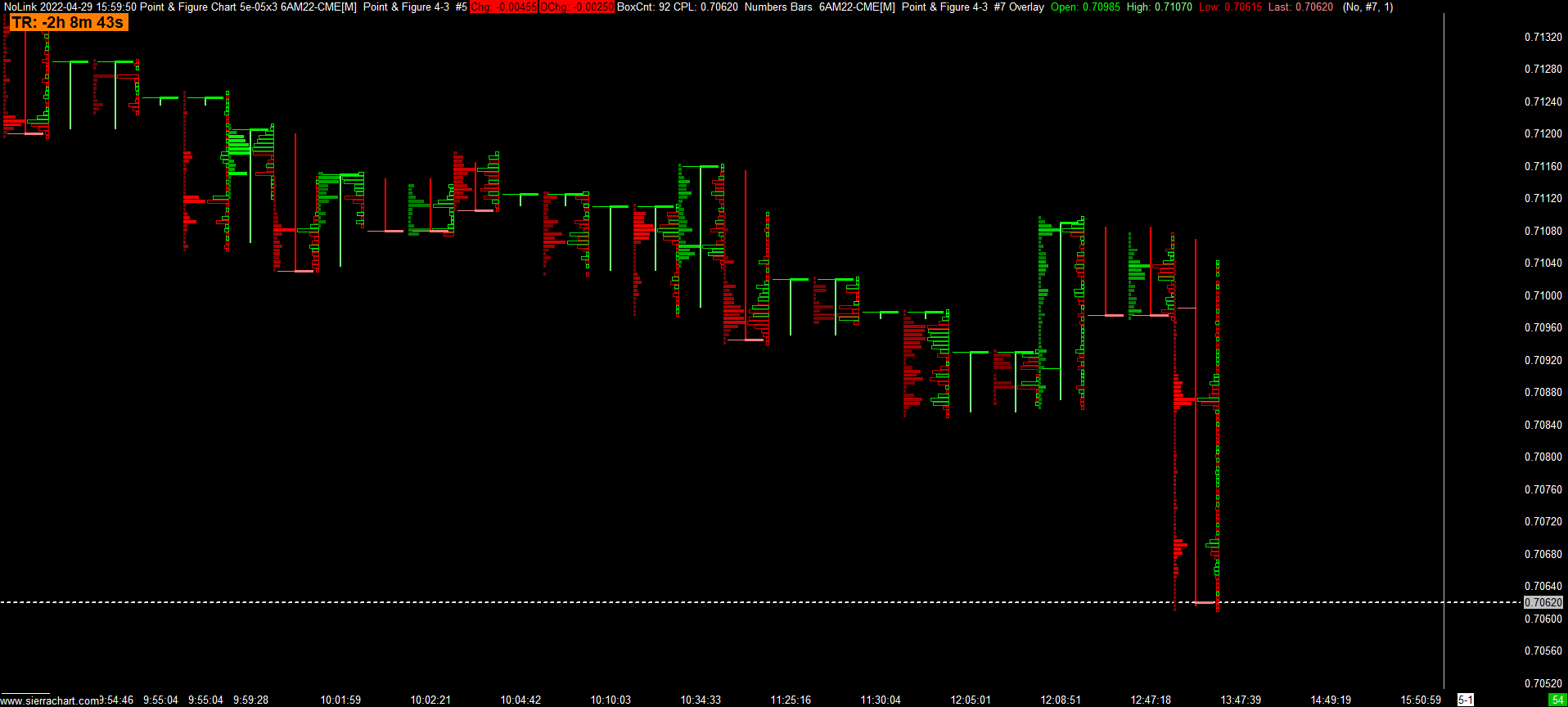

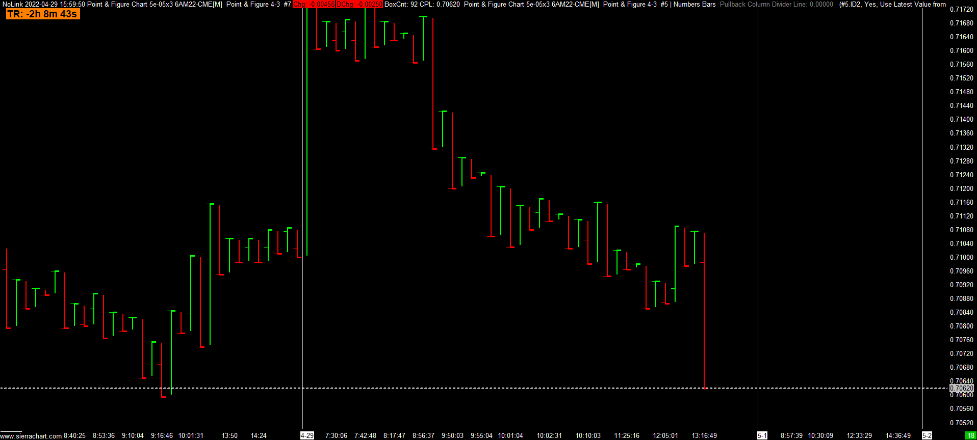

I have a point and figure OHLC chart with alternating red and green bars which is what I want. I have a numbers bar with the same session time, box size and reversal size as the OHLC chart. I'm trying to overlay the OHLC bars on to the numbers bar or use a study/Price Overlay to overlay the number bars onto the OHLC chart. When I do this the OHLC bars are not alternating red and green bars. Can someone point me into the right direction. See the two attached charts.
https://www.sierrachart.com/image.php?Image=1651284545792.png
https://www.sierrachart.com/image.php?Image=1651284710367.png

You need to have the bars setup as you would want them in the chart before adding the Numbers Bars study. Then add the Numbers Bars study and then add the Study/Price Overlay and overlay the Main Price Graph from the same chart. For example, if you have the Numbers Bars on Chart #2, then overlay the Main Price Graph from Chart #2. As long as the underlying bars were showing the alternating pattern, then the overlay should show it as well.
Refer to the following for the Study/Price Overlay study:
Study/Price Overlay Study
